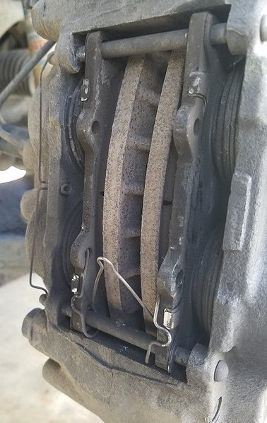

    I am fairly sure I have identified the clunk. Apparently the brake pads are floating around the roter and clicking into place when the caliper engages. This would explain why I heard two clunks in previous videos AND why it was difficult to pinpoint whether it was coming from the driver or passenger side.
    https://youtu.be/IIE5XmaGk-E
    You can hear the clunks at
    0:08
    0:26
    0:54
    1:00
    You can see the pads shift position at
    0:31
    Good news is; I think this is not an urgent problem nor safety issue. Bad news is; this clunk is still annoying and makes my 2014 truck sound rickety. There is already an anti-rattle clip on the pads but there is a spot for another one. Toyota gave me one paper-clip thingy per brake when they probably should have given me two paper-clip looking thingies. so I am going to snap one on there and see if that removes the clunk or at least reduces it.
    I'm still a little skeptical though because I was poking around with a screwdriver and I didn't feel any play. Would be shocking to find out that paper-clip does show much.

    I put another anti rattle spring on the upper pin and mine still clunks/clacks like a motha,
