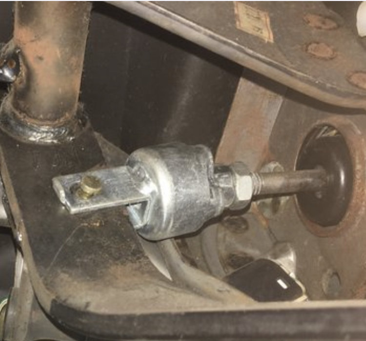

    You can leave the bleeder screw loose for a bit and let gravity help. Check this thing, make sure it’s not busted. If you push on the clutch and the plunger shaft buckles and looks screwed up it’s bad47162A11-FB3F-45E0-9565-298B3252F351.jpg

    One of those things folded over on my Taco. WTF is the purpose of it?

    I believe it’s supposed to keep the plunger shaft running true as the pedal is pressed but I have personally seen two busted ones. I imagine you could throw together something better with stuff found at a hardware store
