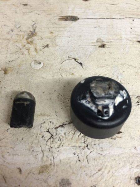

    So ever since brand new I have had a squeak coming from depressing the clutch pedal. I brought it up numerous times with Toyota, and the service tec said to put grease on it. I have done that for the past 5 years.
    Last week the tip of the clevis broke where the pedal pushes on it.
    Here
    I contacted toyota canada about it. They want to see it, despite sending pictures and a video of the problem.
    So if your pedal squeaks, don't let the fuckrs in the service dept tell you to "just grease it"
    Have them replace it under the TSB. This happened to my truck on the highway with our baby in the truck, rendering it non drivable.
    Fuck you Toyota for putting my family in danger and cheaping out.. FUCK you

    And here is the $42 clevis sub assembly that I have to replace:

    Yep. I already have the TSB's and parts lists. Toyota Canada won't warranty it unless they see it. They won't even let me bring them the broken part. Has to be on the truck. Truck has to be at Toyota. Truck is not safely drive able. So, as with every other thing wrong with my truck. I just fixed it

    I think this may have happened to my truck.
    I have a lot of play

    Just an update
    The master underneath the pedal went bad. The actual rod inside snapped. I bought a new part and the updated part now has a metal housing.
    Hope this helps people
