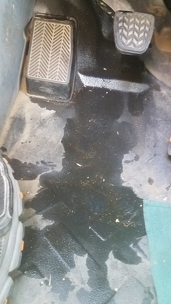

    I know this post is old, but wanted to reply in regards to my 2012 tacoma. I got the 6 speed manual. a month into getting the truck, noticed the clutch squeaking. couldn't figure it out. It would do it on and off. tried to pinpoint why...maybe hot, maybe cold, humidity? no dice. Finally brought it to the dealer under warranty and they thought I was making it up. Brought it again and they finally heard it. they still made me feel like I was an idiot and was knit picking. Hmm. Anyway, they said they couldn't fix it and that it was just part of the design. again, hmm... I even showed them the posts on the service bulletin regarding this very problem and of course, as there was no official notices about it, they weren't gonna fix it. I finally gave up/in and dealt with it. Now (months later) I got the problem mentioned above. My brake fluid was going low. After filling it about 3 times from half full, I finally noticed a greasy puddle on my floor mat (driver's side) couldn't see a definitive leak, but after pulling the matt, felt the floor carpet and it was greasy. So there you have it. If it wasn't for this forum and people having the same issues and sharing them, I'd be s o l trying to prove to what are supposed to be pros and yet more often then not don't have a clue. No offense, but how hard is it to go online and research something, rather then BS your customer out of laziness. Luckily I have a good mechanic who works with my warranty. Gonna bring it in. I'll start a new post about the topic. But thanks all for actually sharing this stuff. gives me peace of mind knowing I am not making this sh$t up.

    2013 4.0L 6speed with 65K doing the same thing.
    Replacing the master clutch cylinder Thursday (at mechanic). Will report.
