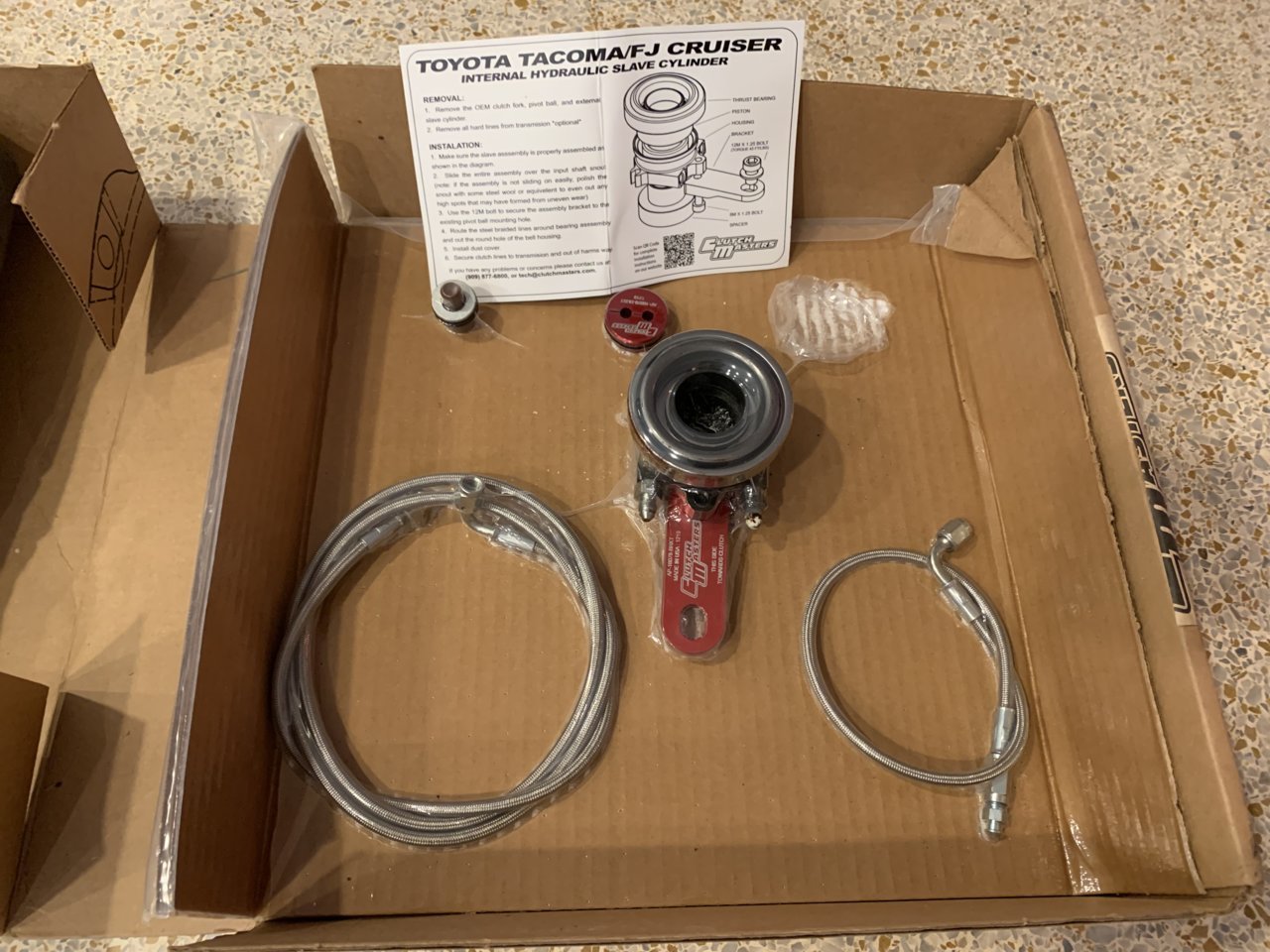

    Anyone know the purpose of this shim kit?
    when the TOB came out, I don't believe it was part of the original kit
    3rd gen manual Taco has the same exact improper quill design
