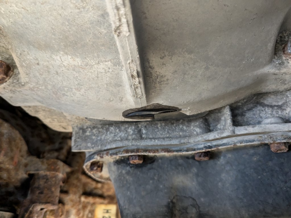

    Well....
    Made it to 40k.
    Didn't fully go out, which I don't quite understand. There was enough of a seal to be able to change gears and make it home.
    Not sure where to go from here.

    tilton I guess
    I wonder if it contaminates the disc, and to brakleen it while in there

    I would give it a strong no that anything is making it to the disk. The bearing would block any fluid squirting out of the seal if you had a major failure. The pressure plate would then be next in line to block any fluid. Once you loose pressure and that initial sploosh is out the rest is gonna run out the bottom of the CM housing and then your bell housing.

    That’s how it starts and if you keep driving it in a couple days the petal is going to stick to the floor and you’re gonna have to start it in gear and power shift it home. Don’t ask me how I know.

    Good to know, I won't push it then. I might top off with DOT 3 and try to make it to a shop.
    I don't want to go back to stock for the reasons that got us here in the first place, but saw that some people are having issues with the Tilton piston rotating and wearing down the seal as well. No great option it seems.
