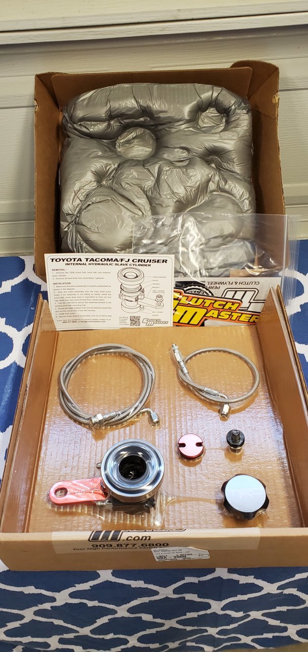

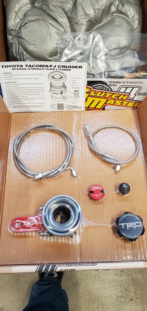

    Just ordered the Clutch Masters Hydro TOB kit. I've dealt with that stupid cricket for too long. It seems two dudes had duds and it's caused a scare. Things can be defective or accidents happen (dented seal etc.). I know most things I work on only get broadcasted if there's a serious problem. I'll remain optimistic because it's the best hope us 6 spd owners got ATM. I'll update after the install. Got an Aisin clutch coming too...
    Didn't come across this until now. Good info:
    https://www.fjcruiserforums.com/thr...c-slave-cylinder-upgrade-for-6-speeds.735258/
    P.S. the group code saved me $50! Thanks for that!
