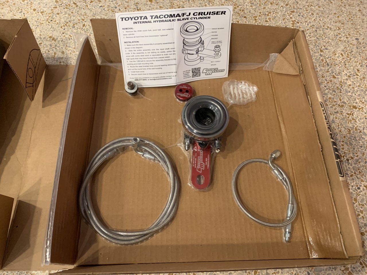

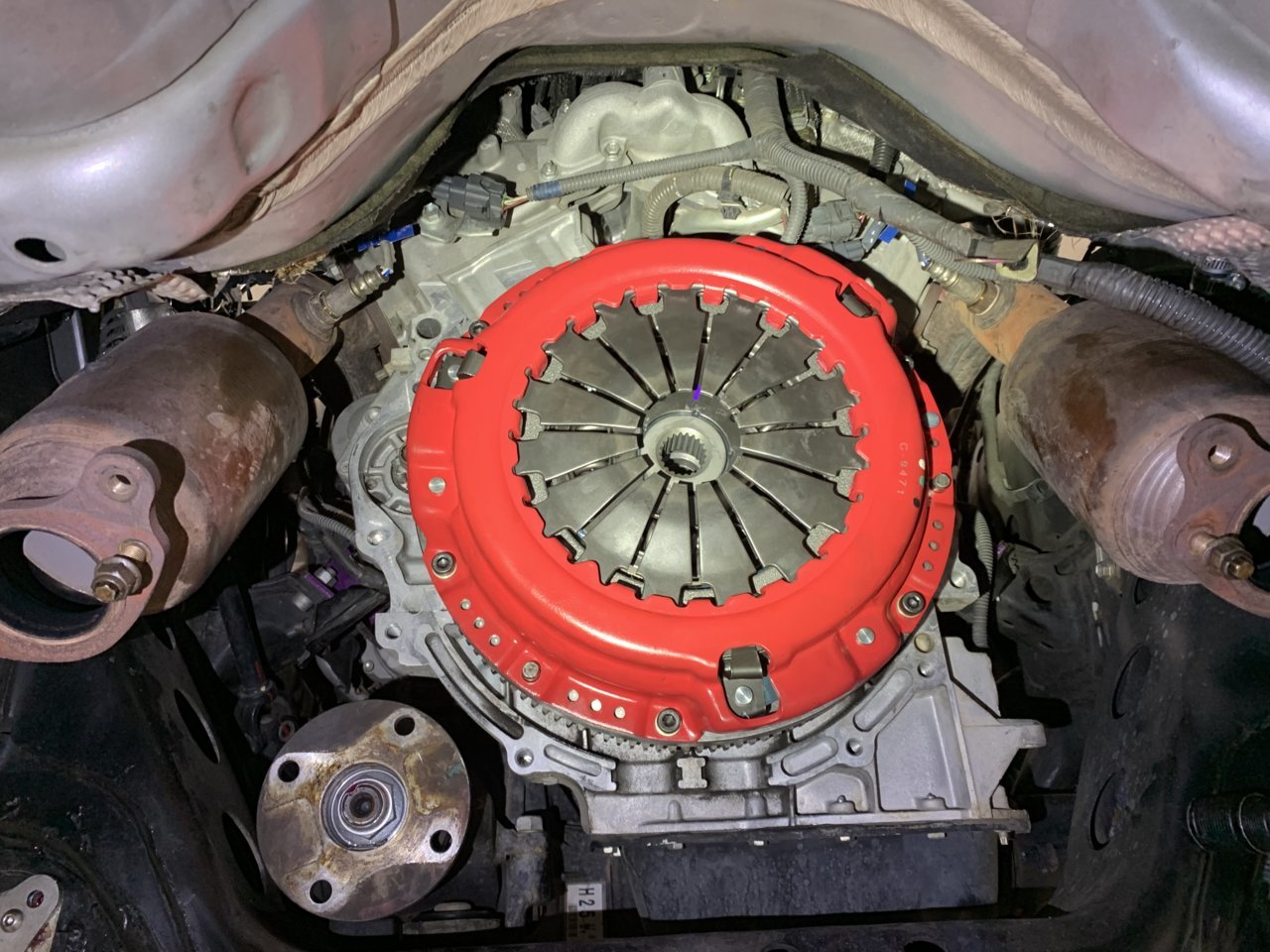

    Well I've installed the Hydro bearing, a new clutch, Flywheel, and rear main seal. I feel like I got hit by a buss but the clutch feels great so far. I'll post an update after we get some miles on...
