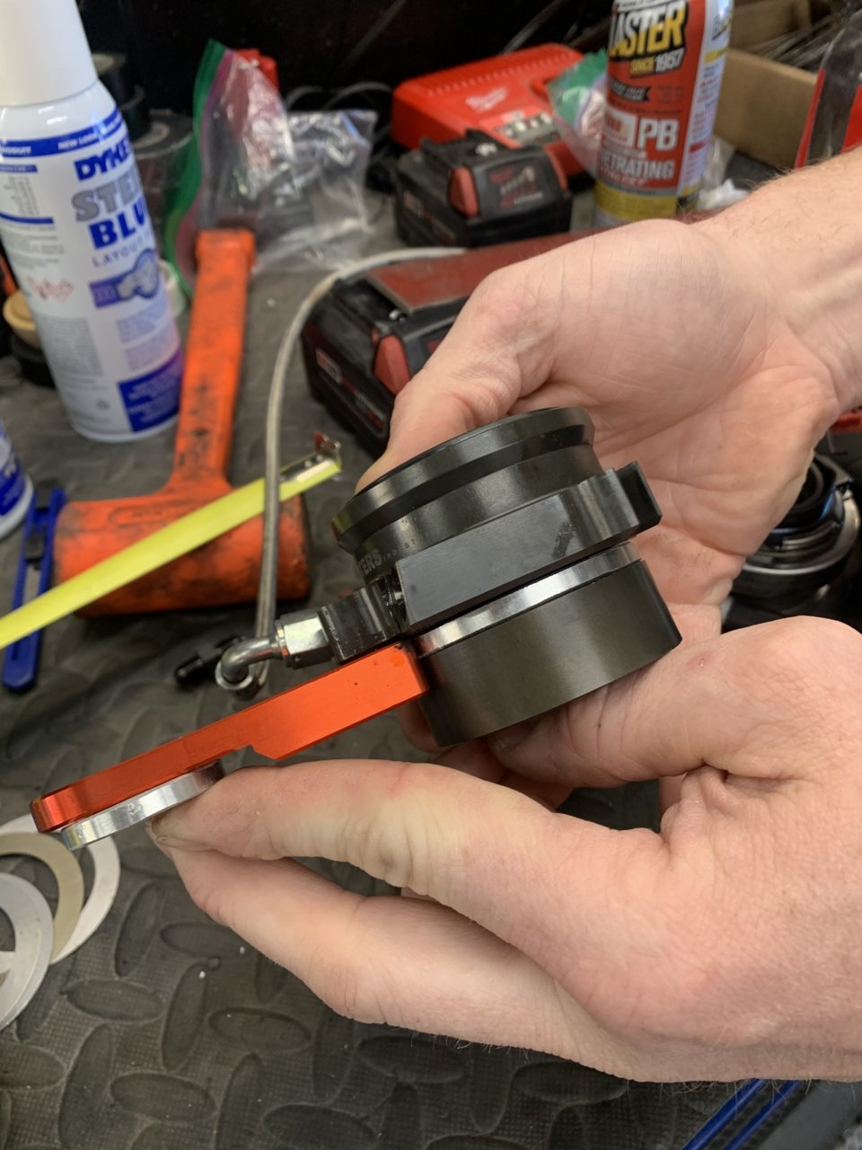

    Update on my customer service experience from Clutchmasters:
    Sent my failed unit in. They said my housing is damaged from the piston seizing, so not re-buildable.
    They offered a new unit at $300.00.
    I purchased the unit back in 2020, so 4yrs old. They definitely didn't have to offer me anything as the unit was well out of any warranty, so I was pleasantly surprised by that.
