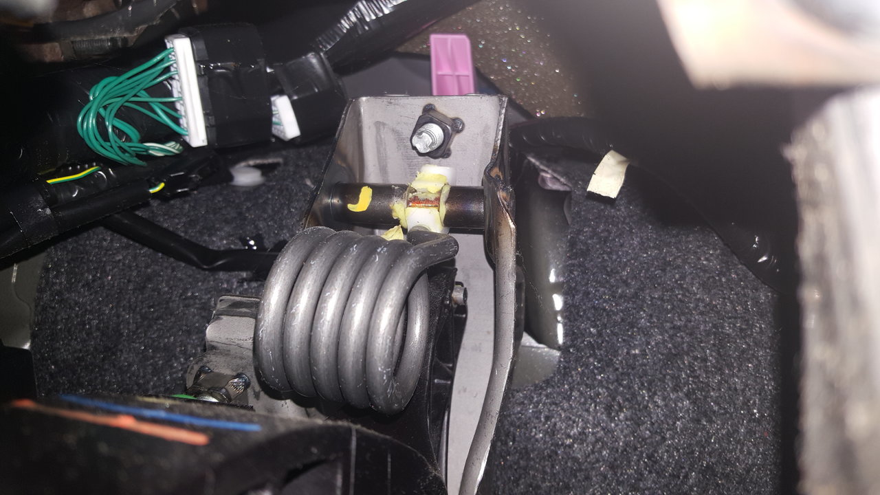

    So yesterday I went to drop my trailer off for a buddy to use and as I was backing up to the trailer I felt a "thunk" in my foot. I didn't think much of it and went ahead and hooked up my trailer. As I was leaving and shifted from 2nd to third I noticed my clutch pedal was waaaaaay down there in the floorboard and had about 3" of travel. Once I released the clutch it stayed low for a few seconds until I tapped it with my foot and then it immediately popped back to it's normal possion with a audible thud. The clutch normal and the truck shifted just like it always does. I went ok with my trip and when I got to his house I checked the fluid, all good. Spring on the pedal was fine and I he pushrod didn't seem like it was in a bind. Tonight I got my flashlight out to investigate further and low and behold I find this thing broke all to hell. It's tight in there... AND a sprint is involved. How big of a pain in the ass is this going to be? Is this common? I searched and didn't see any info pertaining to a 2nd gen and if I did it was cold weather related.

    What's broken with yours? You know that white bushing only wraps partially around the pin and the top of the pedal has a slot for the spring not a round hole. Also if you want to remove the spring fully press the pedal to the floor and you'll be able to slide it out of the clutch pedal. Don't try to remove it out the slot shove it sideways and it'll come out easily without any disassembly.

    I was looking at the part last night on various parts sites and noticed it doesn't wrap all the way around. Now I'm really stumped as to why it's doing what it's doing. Back to the drawing board. It's driving me crazy.

    Doesn't look broken, I'm leaning more towards a failing clutch master or slave cylinder. When I removed the push-rod from the master cylinder to clean and lubricate the socket and rod, the pedal was easily pushed to the floor. A loss of hydraulic pressure would/may result in the same condition, obviously mine was done on purpose.
    Once I reinstalled and adjusted pedal free-play, everything was Kosher, and subsequently, the squeaky noise I was troubleshooting has been gone since.
