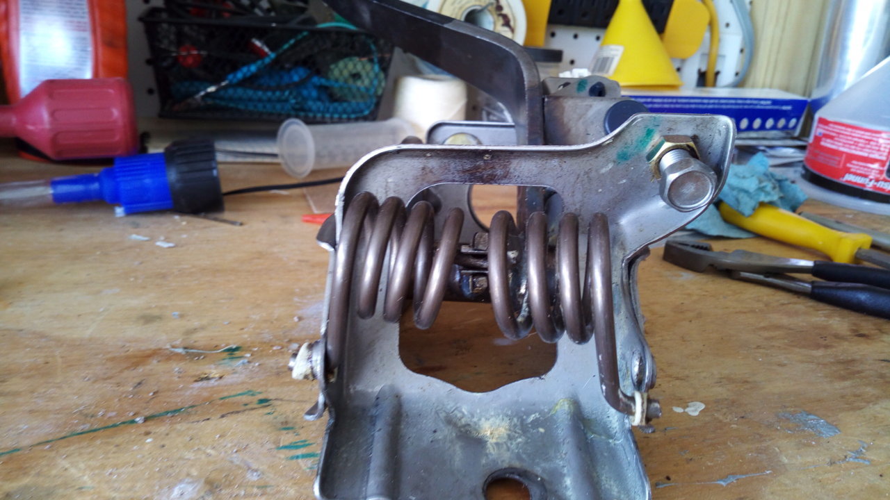

    The squeak was driving me nuts... so I followed this thread. My observations:
    The end attachment points didn't seem to me to be the culprit, but since I had it apart, I went ahead and fashioned some bearings/inserts. I did have to shave them down quite a bit to make them fit into the clutch pedal mounting bracket, but, I think they'll now outlast the truck. Below is a picture of what I used for the side mounting points. I got this piece from Lowe's.
    The center point seemed to me to be the main cause of the squeak. I worked for a couple days and finally came to the conclusion that the bronze material was just too soft. I couldn't bend it around the width of the spring without grinding it down to the point that it was too thin. I ultimately settled on a chrome steel piece of virtually the exact same size as the bronze piece that wasn't working. I got this piece from Home Depot. I did shorten the piece slightly, and, I made a smaller cut on the outside. What eventually worked was to not attempt to force the new piece over the spring, but rather to start at one of the ends of the spring and slide it around the curves and ultimately to the center of the spring. Once I had it at the center of the spring and lined up so that the new piece was in place where I wanted it, I dabbed a healthy drop of Gorilla glue to secure the piece to the clutch bracket. Once I was satisfied everything was going to stay where I wanted it, I applied a good amount of anti-seize to the three attachment points.
    I've had this in place for about a week, and mercifully, not a single squeak since. I've been living with this squeak for over a decade; hopefully it's a thing of the past.

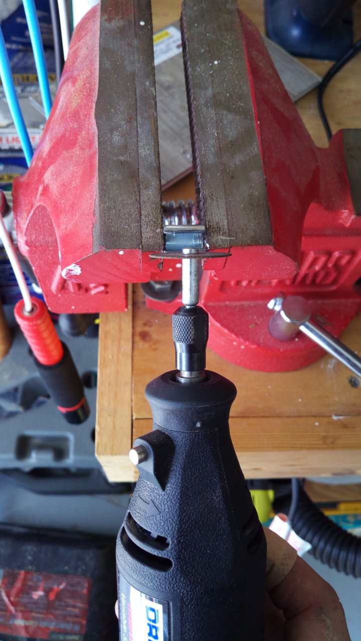

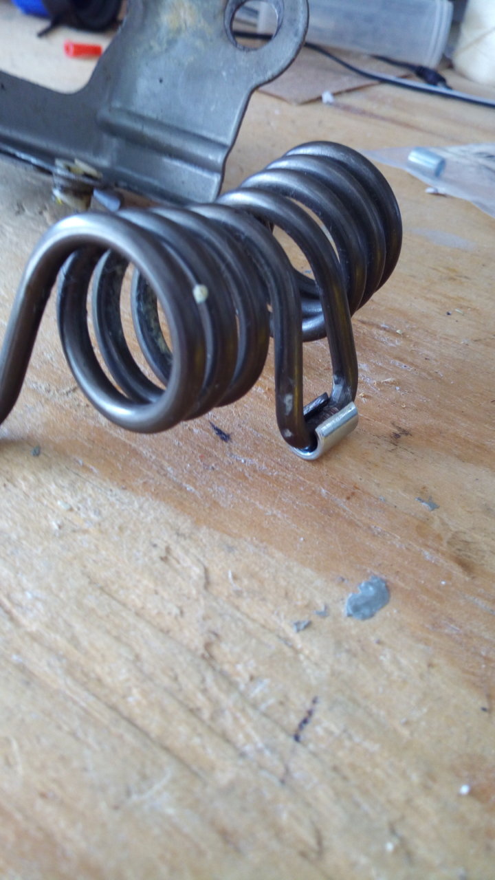

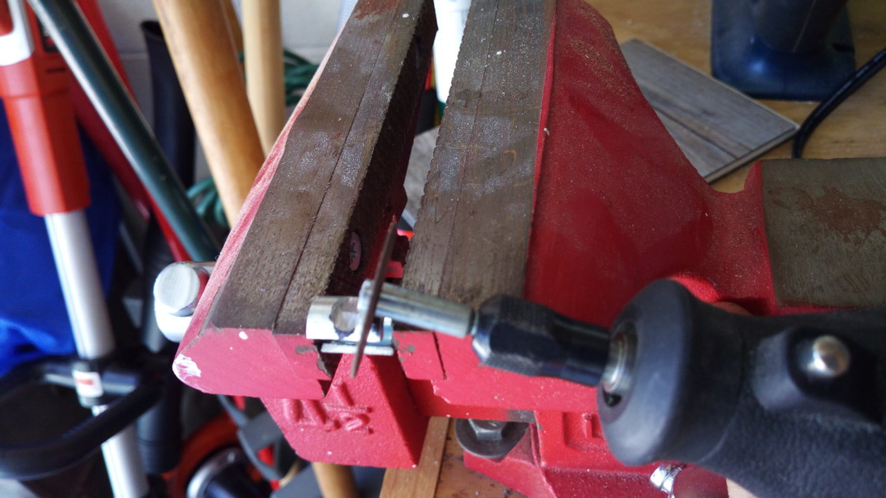

    I just performed this little operation, and it took me roughly three hours with trip to Lowe's included.
    I used a steel spacer from the specialty tools section (see photo).
    I used a Dremel tool to cut the spacer horizontally, so it'd fit over the spring. I also used the Dremel to trim the sides so it'd fit into the groove thingamajig that the spring snaps into.
    I used a vice to compress the spring, so I could remove it. Getting it back on was challenging.
    Ultimately, a vice and a Dremel are very handy for this job.
    Now that I'm done, the clutch pedal has the snap that it did the day I bought it.
