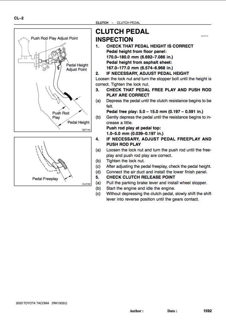

    But the pedal still felt pretty bad. When pushing the pedal in there was a lot of free play and on return it would get kind of stuck for a moment before it returned. I took a video of the free play in the push rod:
    I then followed this FSM diagram.
    In the first measurement (1), the distance from the floorboard I got 170mm. The measurement is from the actual floorboard since the interior is removed for now. It may be the asphalt sheet measurement since there was some black coating on top of the floorboard sheet metal. Either way I guess it was pretty much in spec. The disengagement switch (what I'm calling the switch at the top of the travel) is pretty much maxed out so I couldn't get much closer to the floorboard anyway:
    Found the amount of free play (3a) is almost 30mm at the center of the pedal (from top to bottom).
    I adjusted the push rod so that I only had 10mm of free play and the pedal works much better:
    I measured free play with this ruler put to the floor board:
    10mm feels alright - I may decrease it once I run all the other tests when I have the truck running tomorrow - the battery was out for charging :anonymous:
