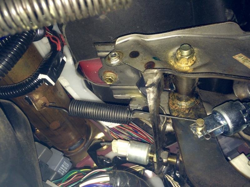

    Thanks everyone here for the info! Switched the torsion spring out with the Toyota 4-cyl linear clutch spring, don't miss that squeak at all.

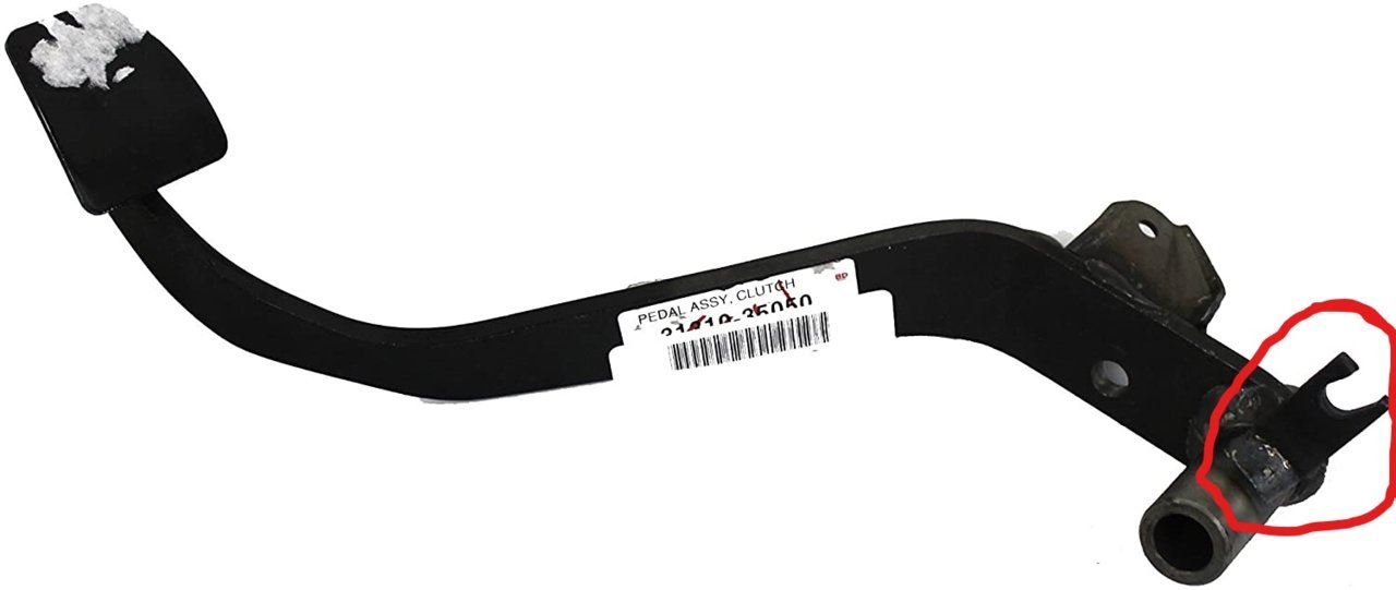

    I did this mod a few months ago, just popped the torsin spring out and put the linear spring in.( Toyota pn# 90507-14030 ) A couple of days later the arm where the torsin spring sat started strumming on the linear spring and drove me nuts. I pushed the linear spring over as far as it would go and that solved the problem temporarily, every now and then that arm would start strumming the spring again and I would have to push it over. Today, since I am not working thanks to C-19, I took the pedal and bracket out and cut the welds to the spring arm and knocked that sucker off and reassembled everything. Now it is quiet and no squeaks or strumming of the linear spring.

    Can you take a photo of the bracket you broke off? I’m doing this mod and would love to make sure it’s done correctly the first time :bananadance:

    Okay, see the tab in red? Cut the weld with a cut off wheel and knock that off with a hammer and reassemble. Good luck!

    Awesome, got the job done and it works way better than that POS factory clutch return spring! Thanks so much!
