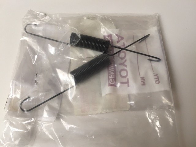

    ThunderOne
    ThunderOne Well-Known Member
    May 20, 2009
    #17473
    10,042
    Mitchell
    Nashville
    1ST GEN OR GTFO
    Toyota NERD
    If they can't find it, tell them to look it up on Hillman. That's where the guy at ace found it and got it from another store. Item no. 540210
