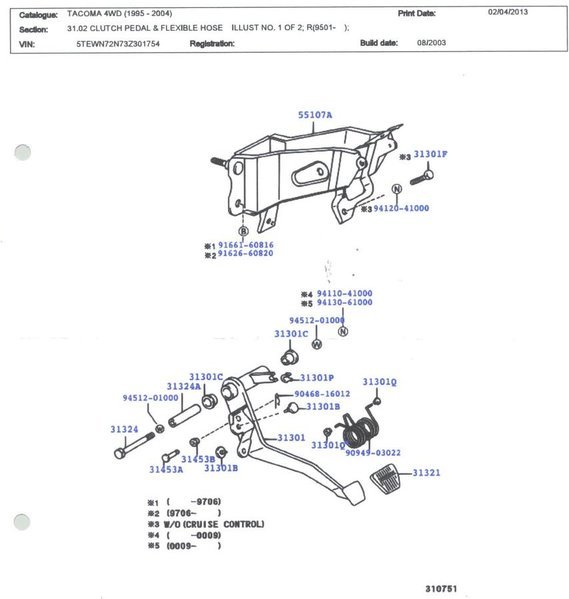

    downloadfile-2.jpg It's was the 31301Q X2 and 1x 31301P. The metal "post" the the 31301P bushing sits in is what my brake return spring was catching on and making a clicking sound everytime I pushed the clutch.
  11. Jul 31, 2016 at 5:19 AM
    #171
    Adirondacktaco
    Adirondacktaco Member
    Nov 26, 2015
    #170711
    22
    04 TRD 5spd 6cyl
    Toyota Part # 90389-05017 corresponds to 31301P IN FirstGen Jer posted parts diagram. That's the only one I've ever had to replace.
