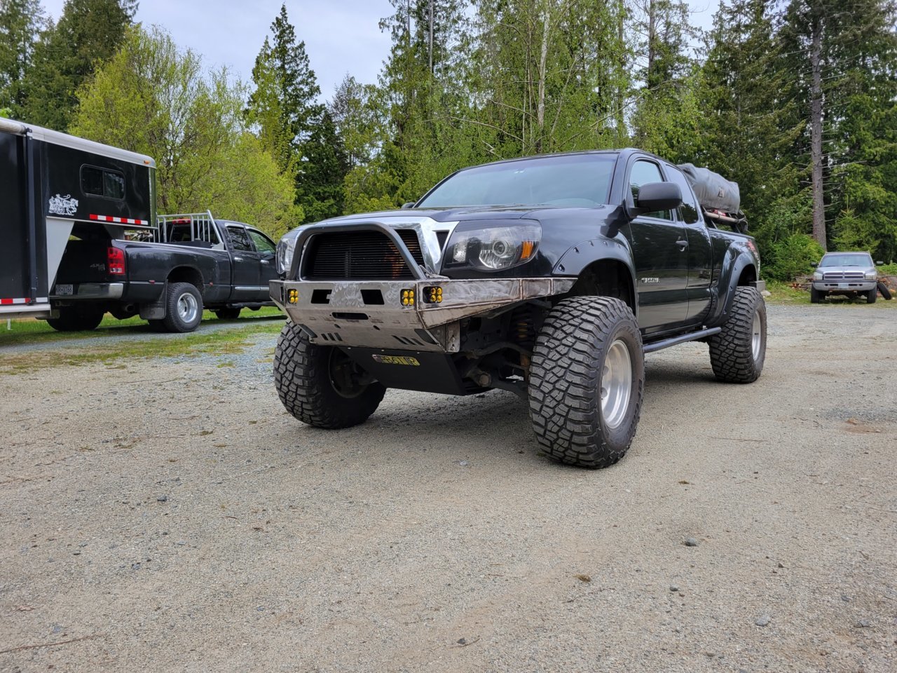

    why does this not have a side reinforcement like C4
  2. May 28, 2022 at 12:10 AM
    #402
    Slashaar
    Slashaar Trail Limo Supreme & Certified Hole Massager
    Nov 23, 2017
    #236717
    15,529
    Josh
    Kansas City, MO
    2015 Tacoma TRD-Sport DC LB
    Coastal HC Front, 6112s+650lb King Coils, JD 62 Swap + 14" Fox 2.0s

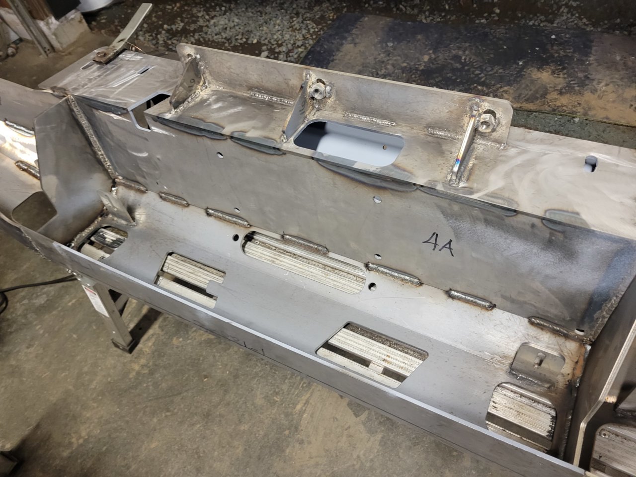

    because it's fixing a non-existent problem. I've never heard of anyone winching off their bumper.
    Also if you look at this photo, you can see it gets bolted through the cross member so it's more rigid anyway.

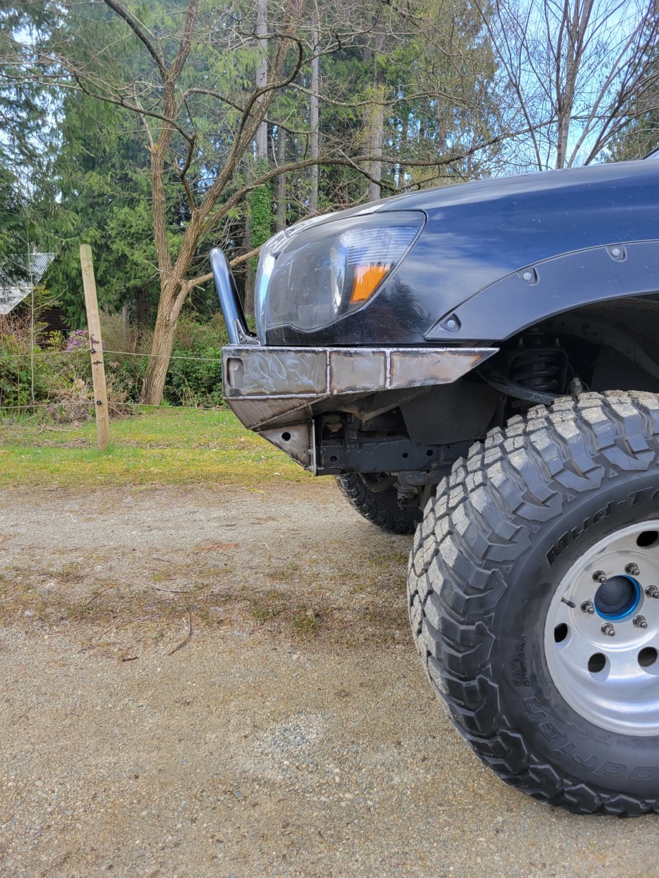

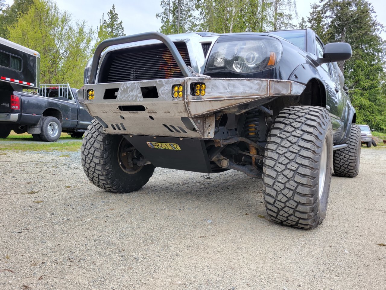

    I've winched several times off my coastal bumper with my Badlands Apex 12k and I'm sure several others in this thread has as well. I reinforced my frame horns however and that IMHO is necessary if you are going to be winching.

    Can you provide more info on how you reinforced your frame horns?
    I wouldn't necessarily say it's a gimmick
    (https://www.tacomaworld.com/threads...rcement-plates-plate-before-you-break.186212/)
    there have been a few reports of people ruining their front ends by winching without reinforcement.

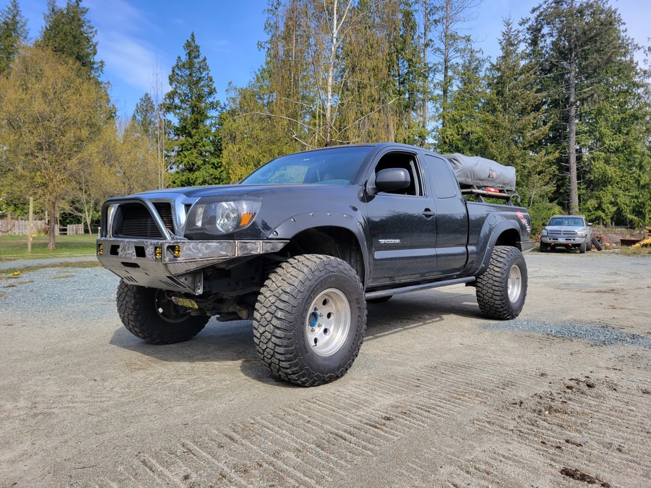

  7. May 28, 2022 at 10:20 AM
    #407
    Blackie Mc Truckie
    Blackie Mc Truckie Member
    Nov 6, 2015
    #168883
    24
    Jamie
    BC Canada
    2005 TRD 6spd access cab, it's black
    3" lift, K&N cold air intake, Magnaflow exhaust, rims unknown, 35" bfg km3's, custom built box w/12" sub, retro fit headlights, Hurst shift knob, coastal offroad bumpers, custom skid plate, custom grill
    Thanks bud
  8. May 28, 2022 at 10:33 AM
    #408
    Blackie Mc Truckie
    Nov 6, 2015
    #168883
    24
    Jamie
    BC Canada

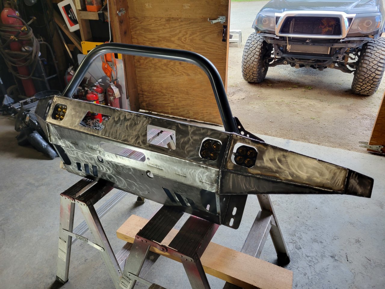

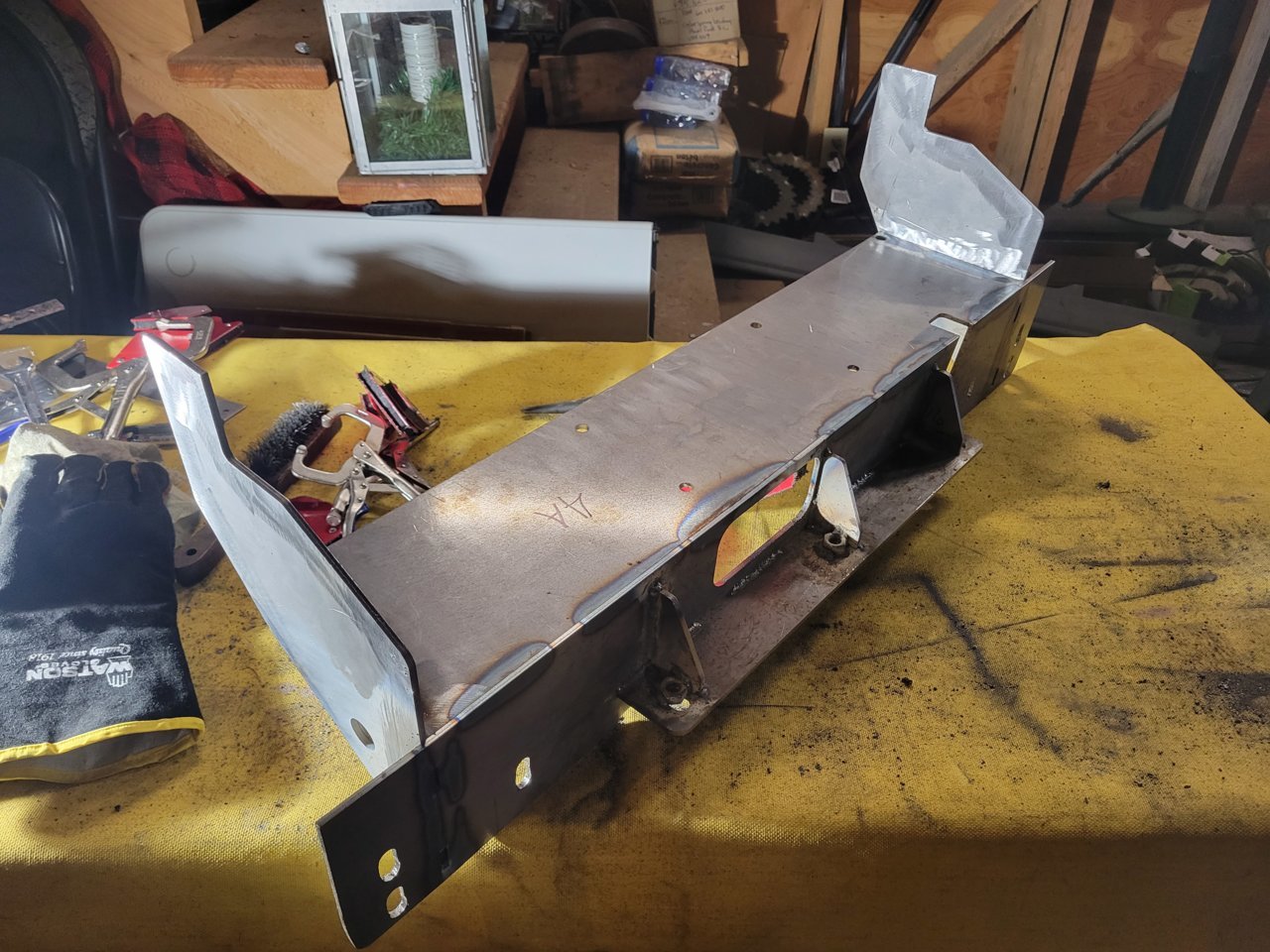

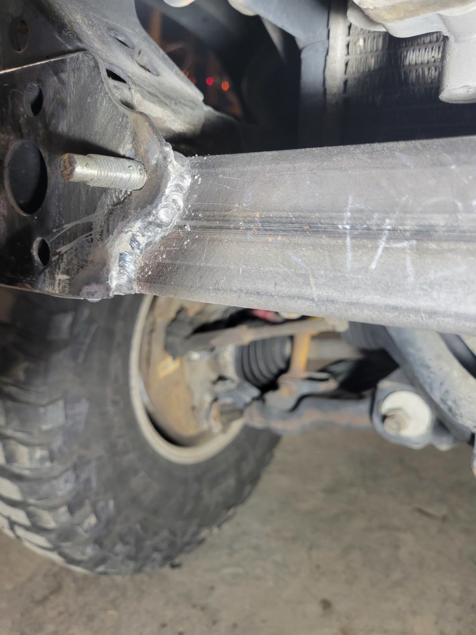

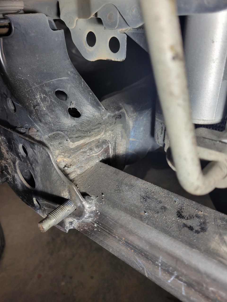

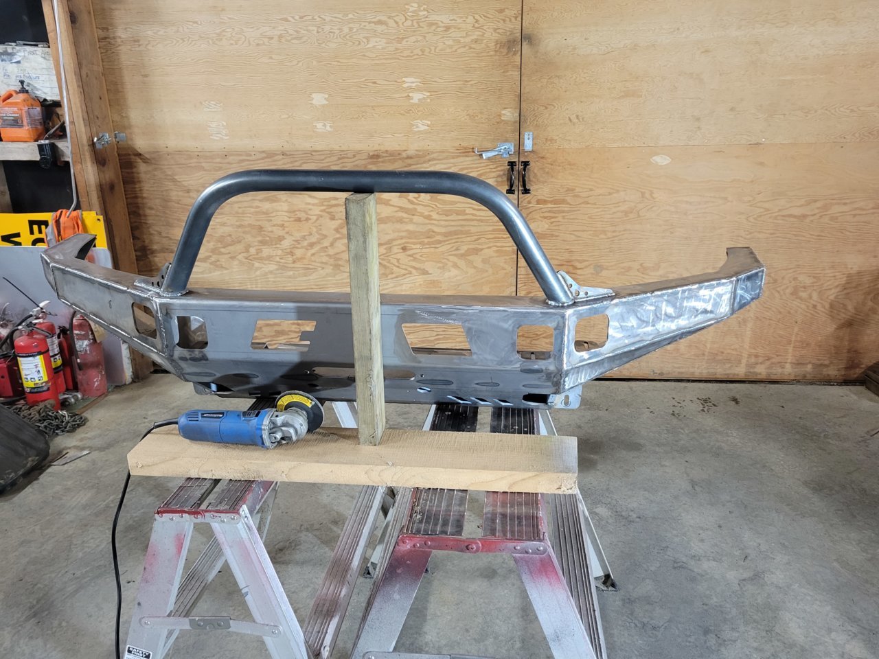

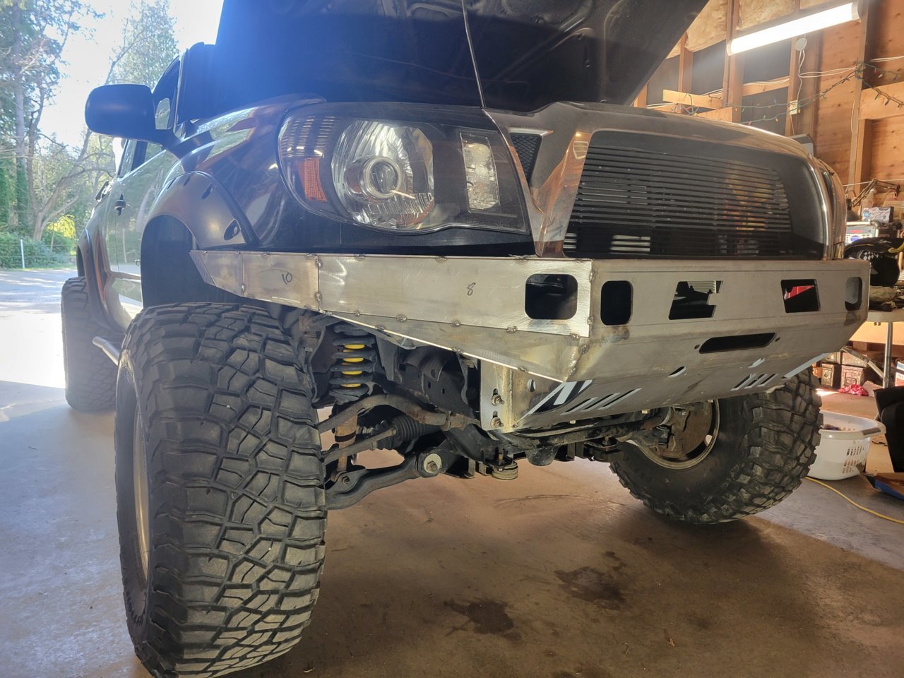

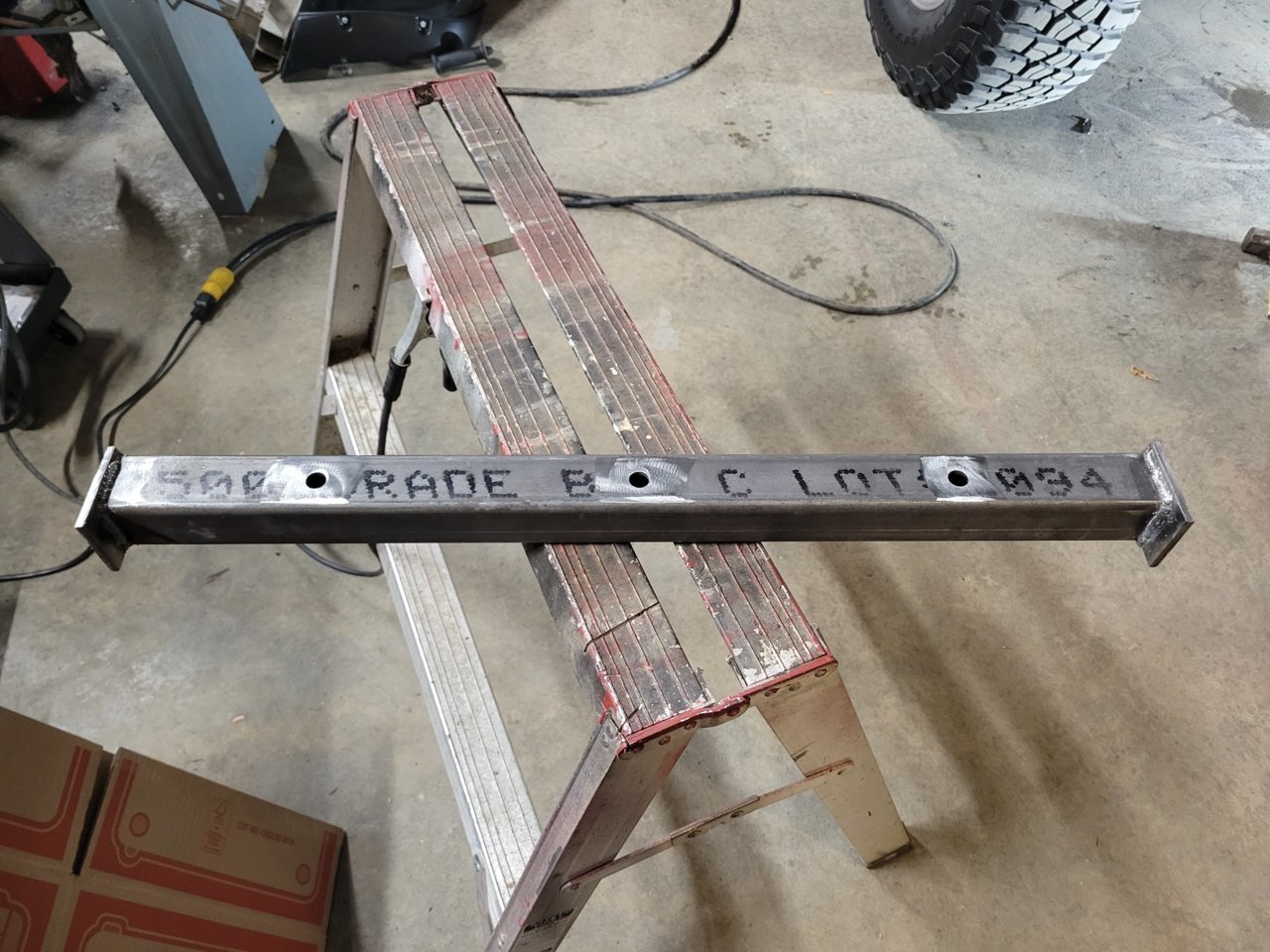

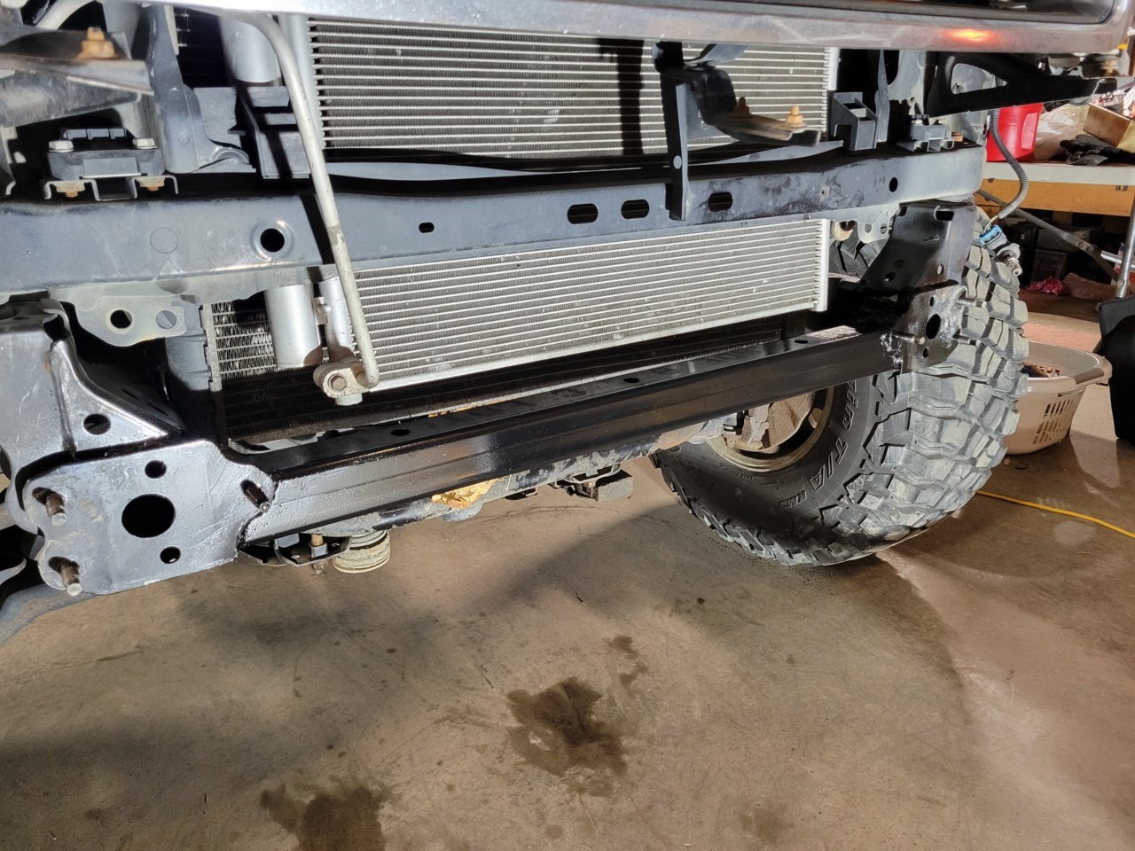

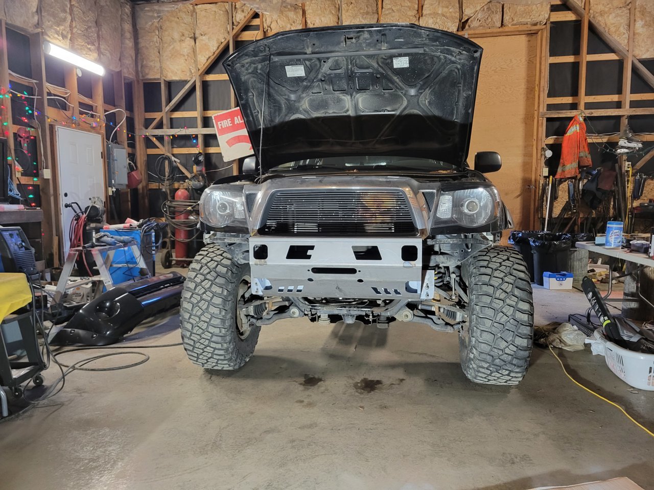

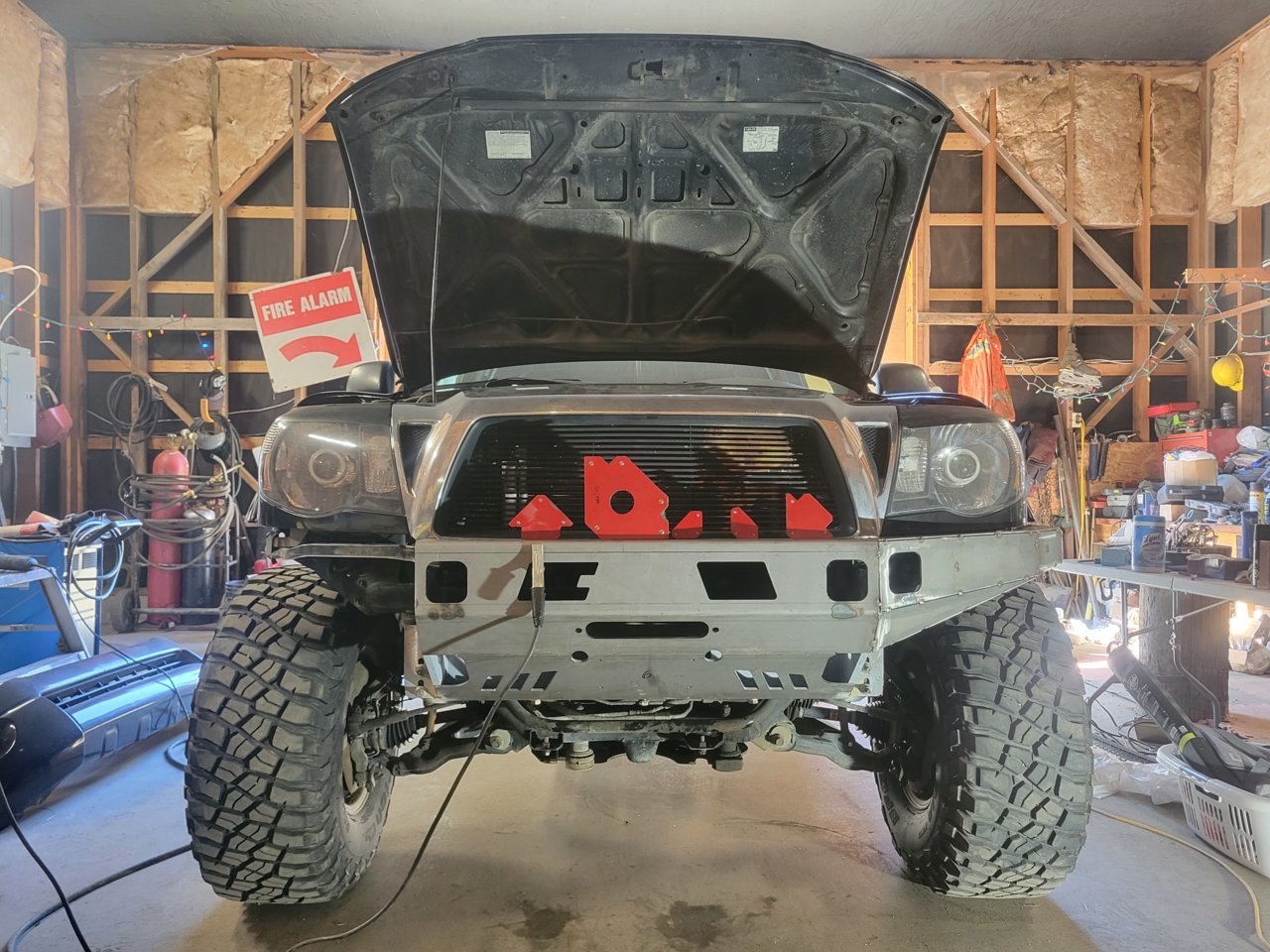

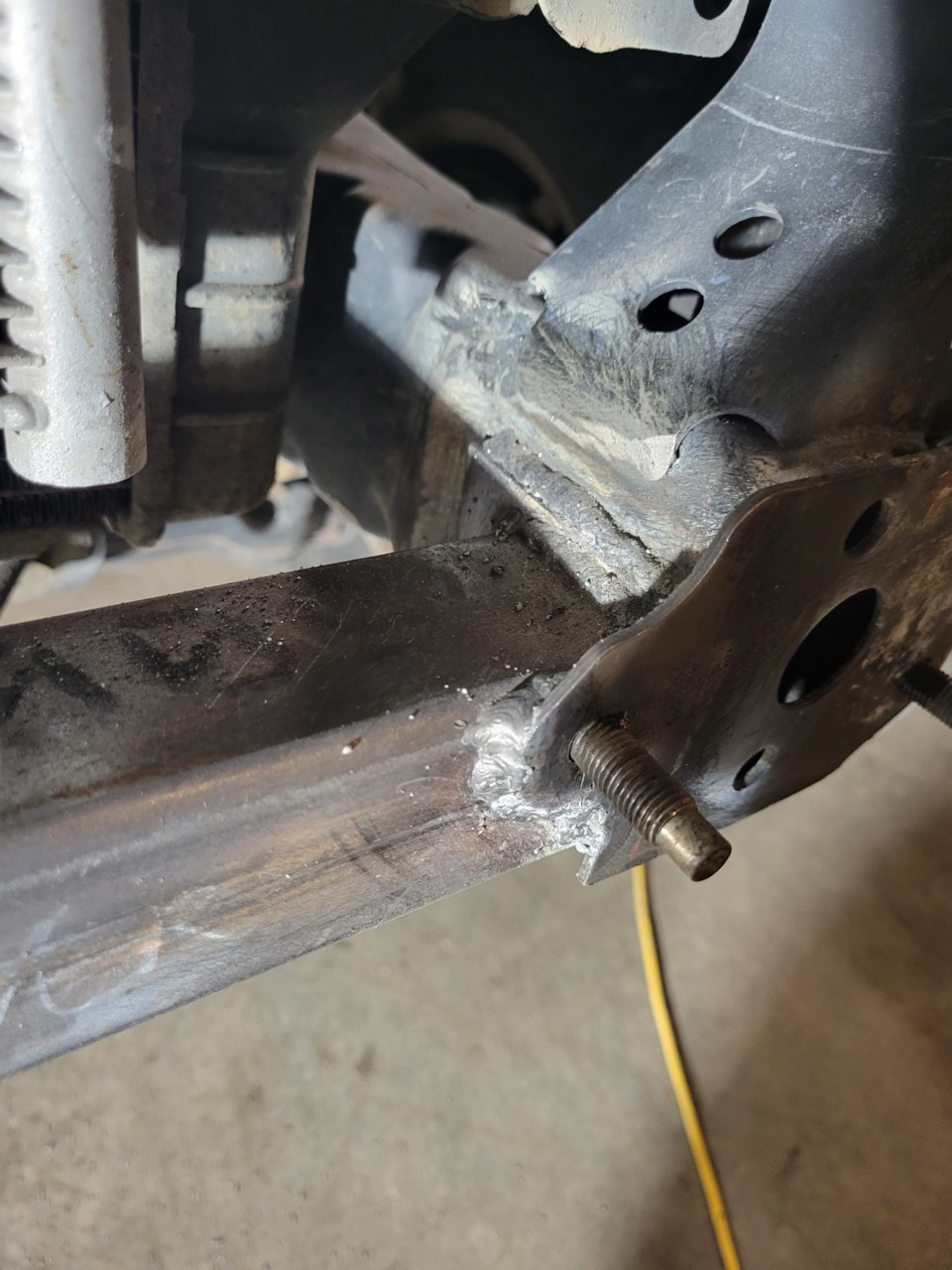

    Here's a couple more pictures of how the new crossmember gets installed between the frame horns. Once it's fully welded it's pretty strong...I hope lol..then the bumper rests on the new crossmember and bolts through it. I just hope I welded it good enough haha.20220418_223834.jpg 20220418_223851.jpg 20220418_223857.jpg 20220419_113631.jpg 20220419_115257.jpg 20220418_204428.jpg

  11. May 31, 2022 at 4:46 AM
    #411
    AStinkyBumb
    AStinkyBumb Well-Known Member
    Oct 5, 2017
    #232070
    1,125
    Indiana
    2013 DCLB SR5 4x4
    Did you also get the high clearance skids to protect your steering rack and belly?
    Slashaar likes this.

  13. May 31, 2022 at 3:24 PM
    #413
    Blackie Mc Truckie
    Nov 6, 2015
    #168883
    24
    Jamie
    BC Canada

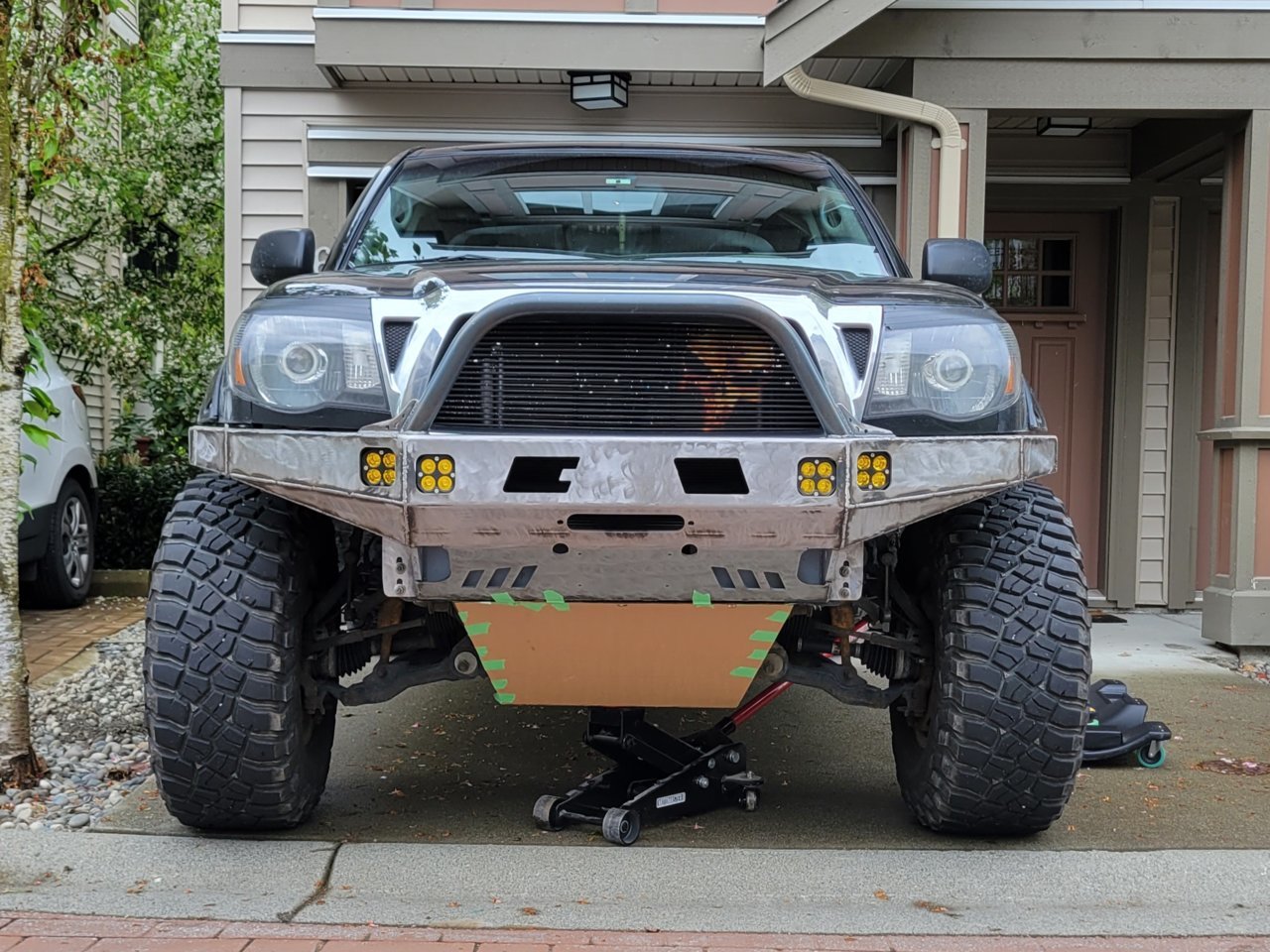

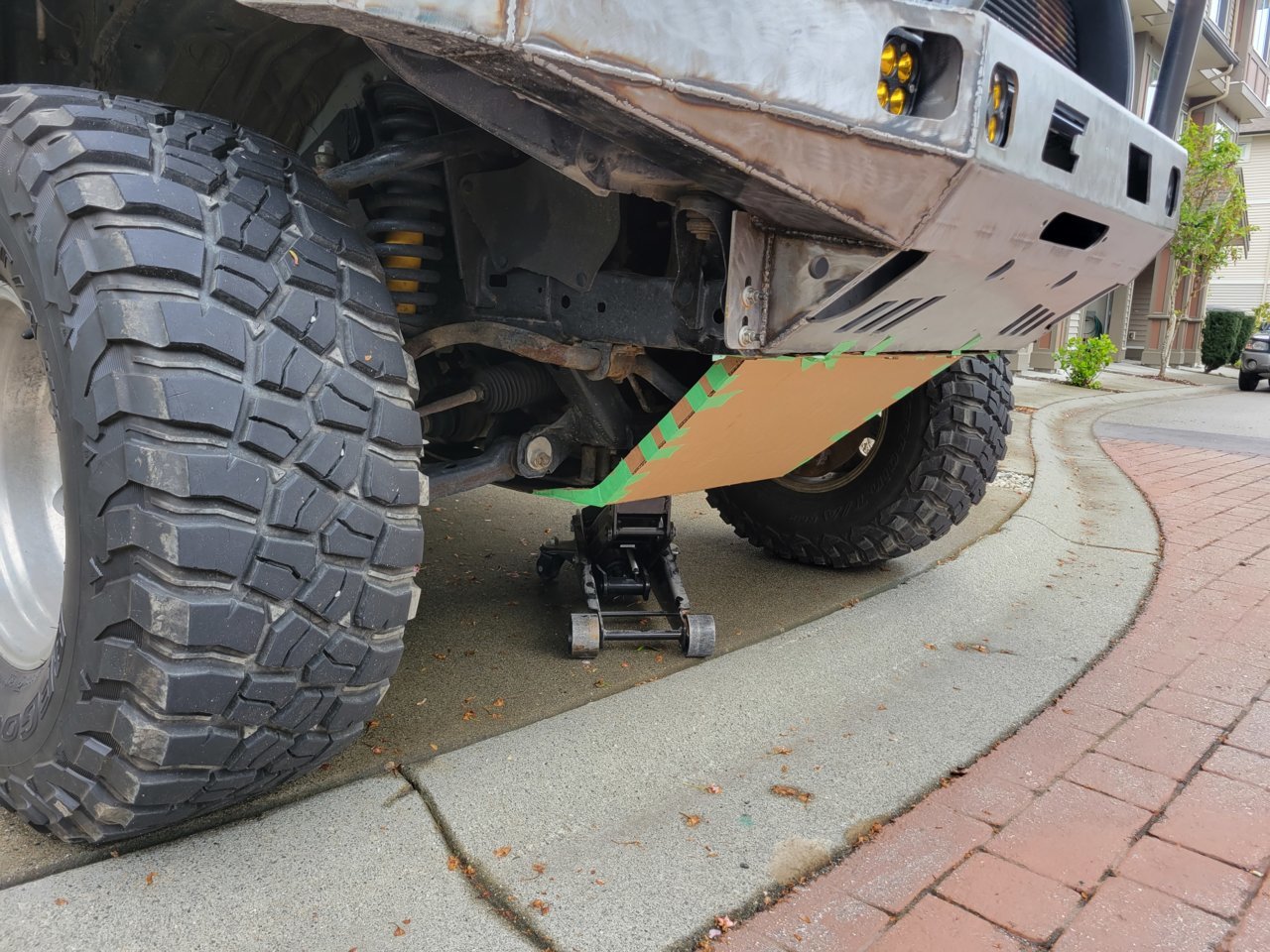

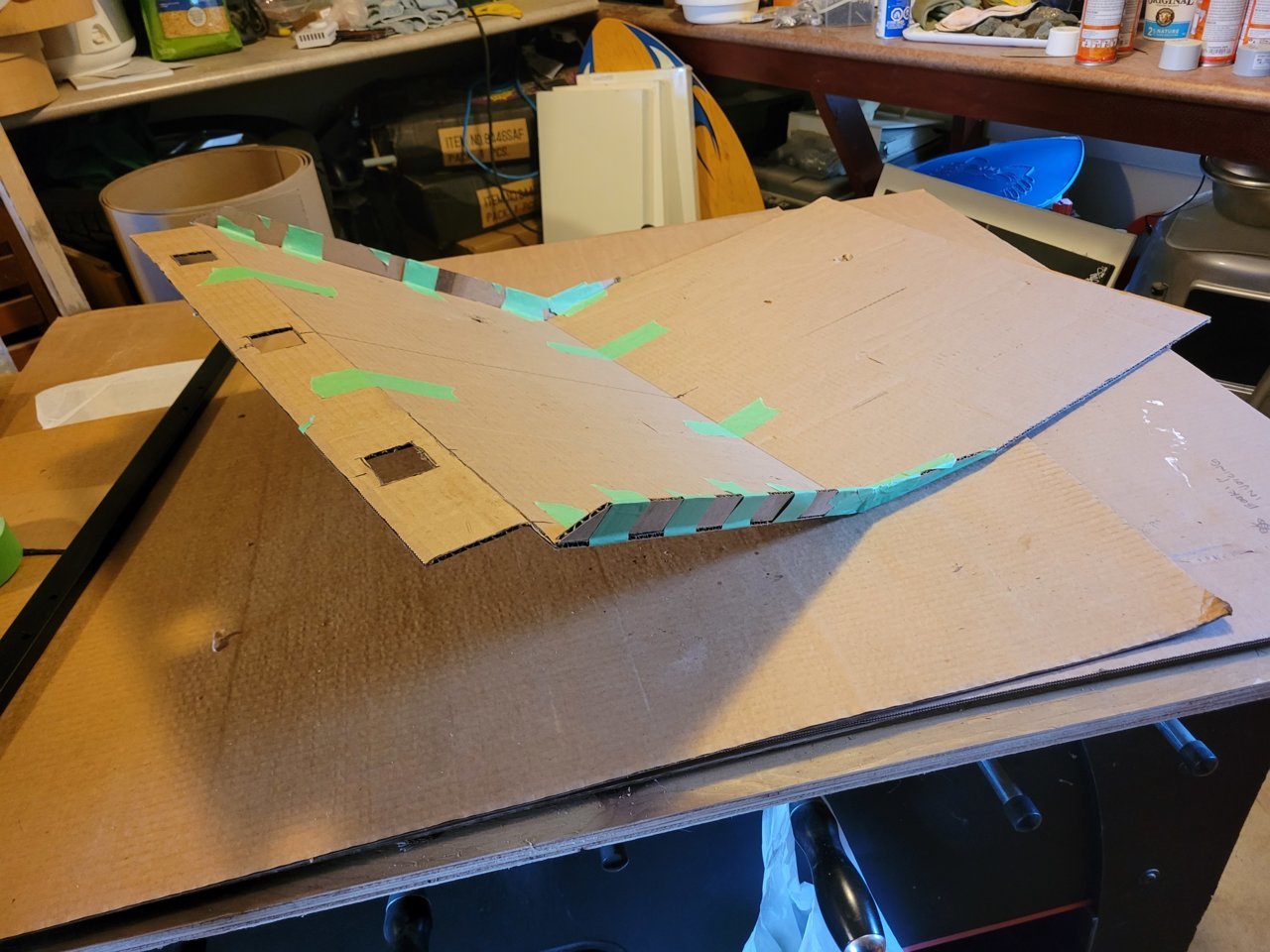

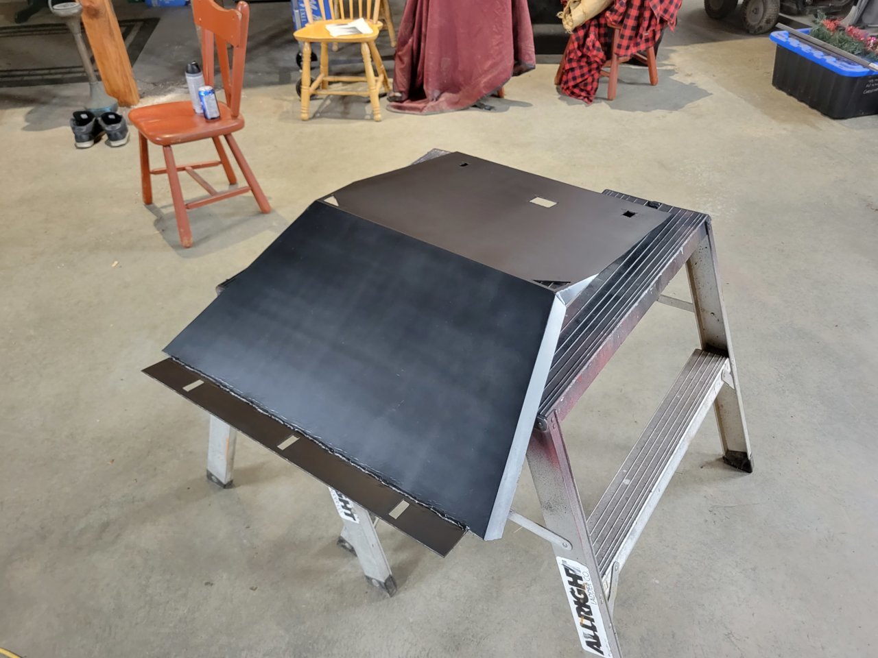

    I didn't go with the CO high clearance skid because I wasn't ready to cut my exhaust that's required to install it... so I fabbed up my own out of some 10ga I found. It's pretty thin material and it doesn't have any stiffening ribs because it's so close to the swaybar but it's a little better than nothing I figure. If i remove the swaybar i can then beef it up a bit...20220514_145405.jpg 20220514_145045.jpg 20220514_152945.jpg20220523_111649.jpg 20220523_111658.jpg 20220522_224657.jpg

    Some cardboard will have you a template in no time. Yeah I haven't had any issues. I winched a prerunner up a steep hill offroad and the same ford ranger on 2 or 3 occasions. All in the same day.

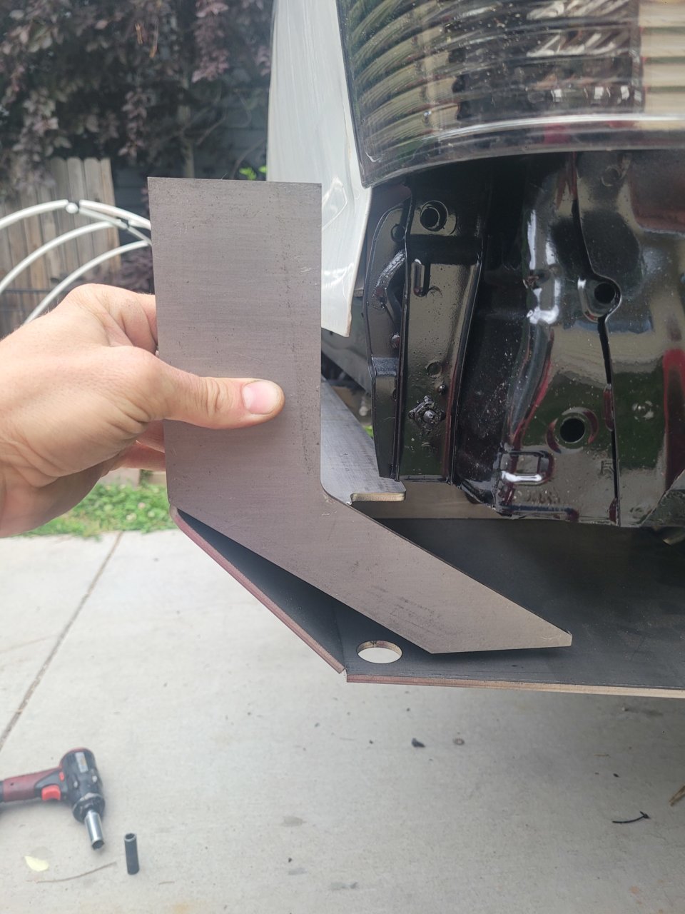

    That's why I welded a 3/16 plate to mine. SOS carried these plates, but is no longer in business.
    Relentless doesn't make one or doesn't anymore, but BAMF makes a reinforcement bracket. but you'd have to cut it in half to use it with the Extreme Clearance bumper from Coastal. The C4 one looks like it'd still work though.
    https://www.bayareametalfab.com/FBR...inforcement-brackets-2005-to-2022-_p_142.html
    But again, I'd think with the coastal Extreme Clearance it's a non-issue with the new crossbar and 3 extra mounting points.
