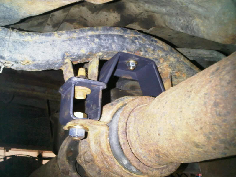

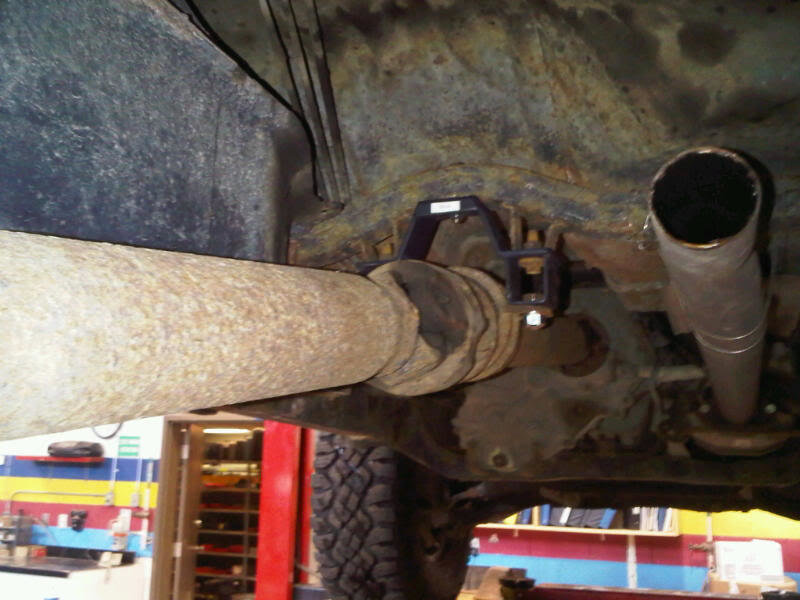

    Have you done the CB drop? I had a very similar problem as you after I did my lift. When coasting I had a very distinct sound, same as what you described. I just installed a CB drop bracket from Beefed Tacos today.
    It is like night and day! I have no more dash rattles and no more low speed vibes while decelerating/accelerating (around 40kmh/25mph)
    Now my D shaft angle is virtually non-existant.
    ...regarding the ghetto straight pipe, a cat-back exhaust is on the way :p
