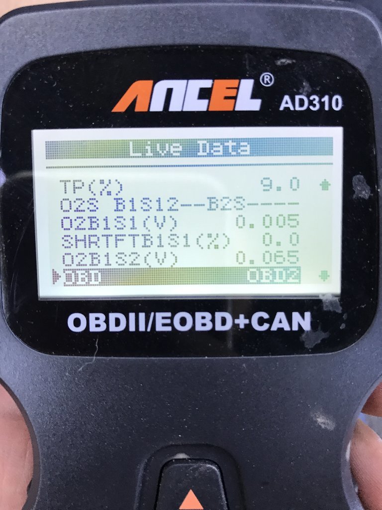

    It does itll be like at .015 qnd the second one will be at like .040

    I'm confused. The output should continually fluctuate from 0.1 to 0.9 and back to 0.1 like every second. Does yours do that?
