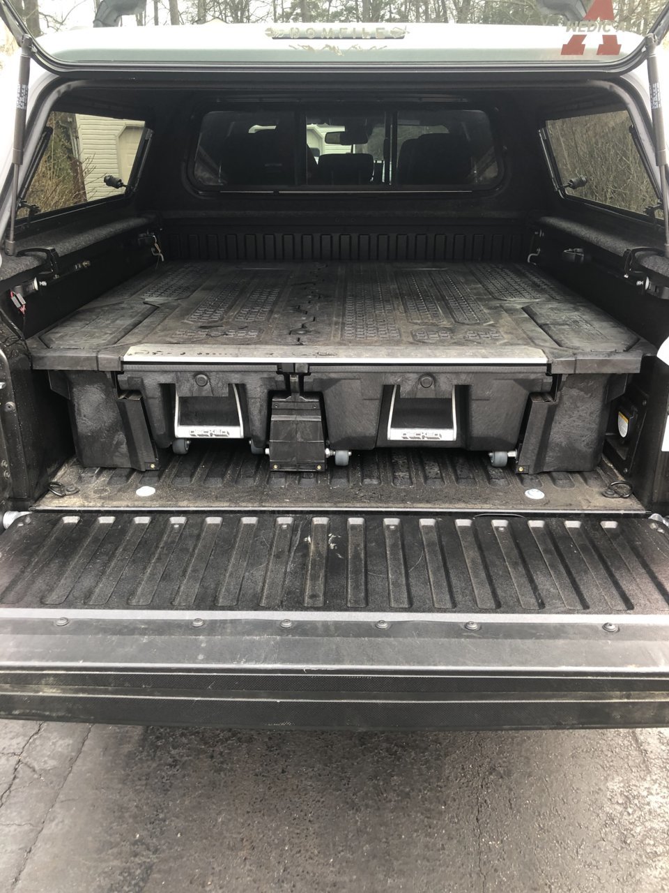

    Finially got decked. Another great Craigslist find and well within my budget.

    Very nice! I have seen these but I take it you don't need to haul things like trash cans? It ought to give you plenty of good storage though.

    nah my truck is mostly for hunting and camping. also, the decked system comes out in about 20mins.

    I didn't even think about throwing a deer in there. I guess you would have to remove it for hunting as it would probably be a mess getting blood all over it

    Nope I use a hitch cargo for deer. It’s hard to lift them up alone

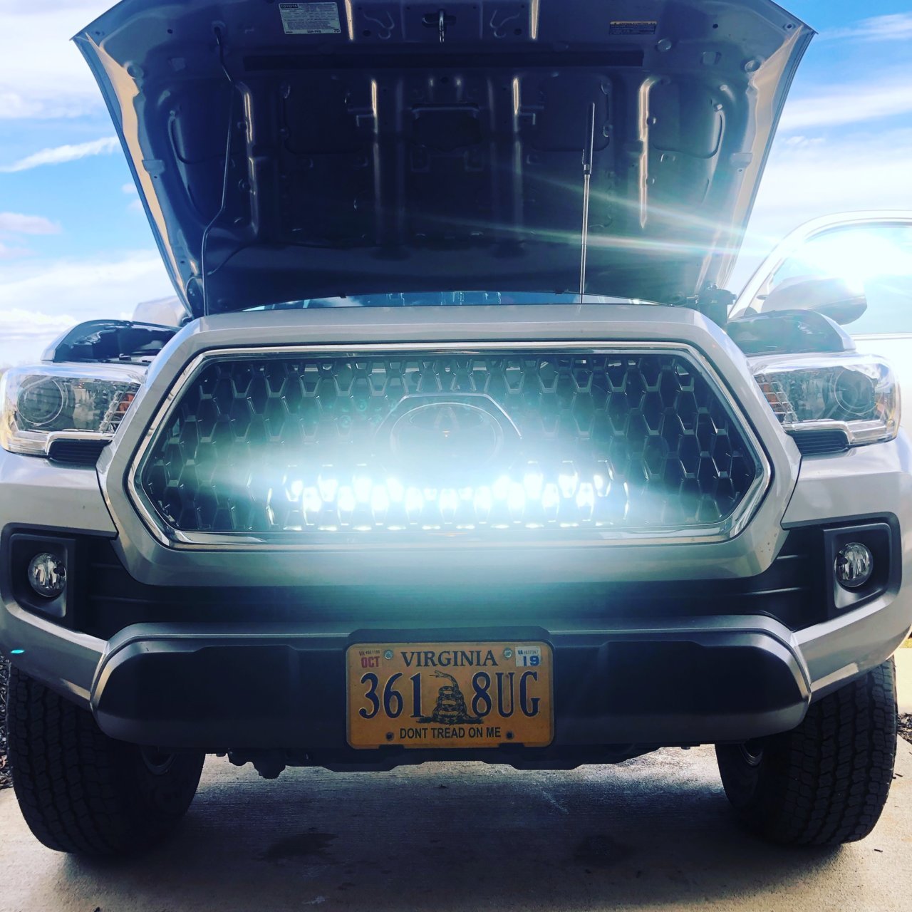

    Well, I’ve finially installed my lights bar that @JWROSE4 gave to me close to a year ago now. OEM switch should be here tomorrow. The radiator support had 2 holes that matched perfectly with my light bar. The grill had to be cut to fit around the bracket. But otherwise perfect clean install, and fairly hidden.

    Looks good man! Is she bright behind the grill like that?

    Surprisingly yes

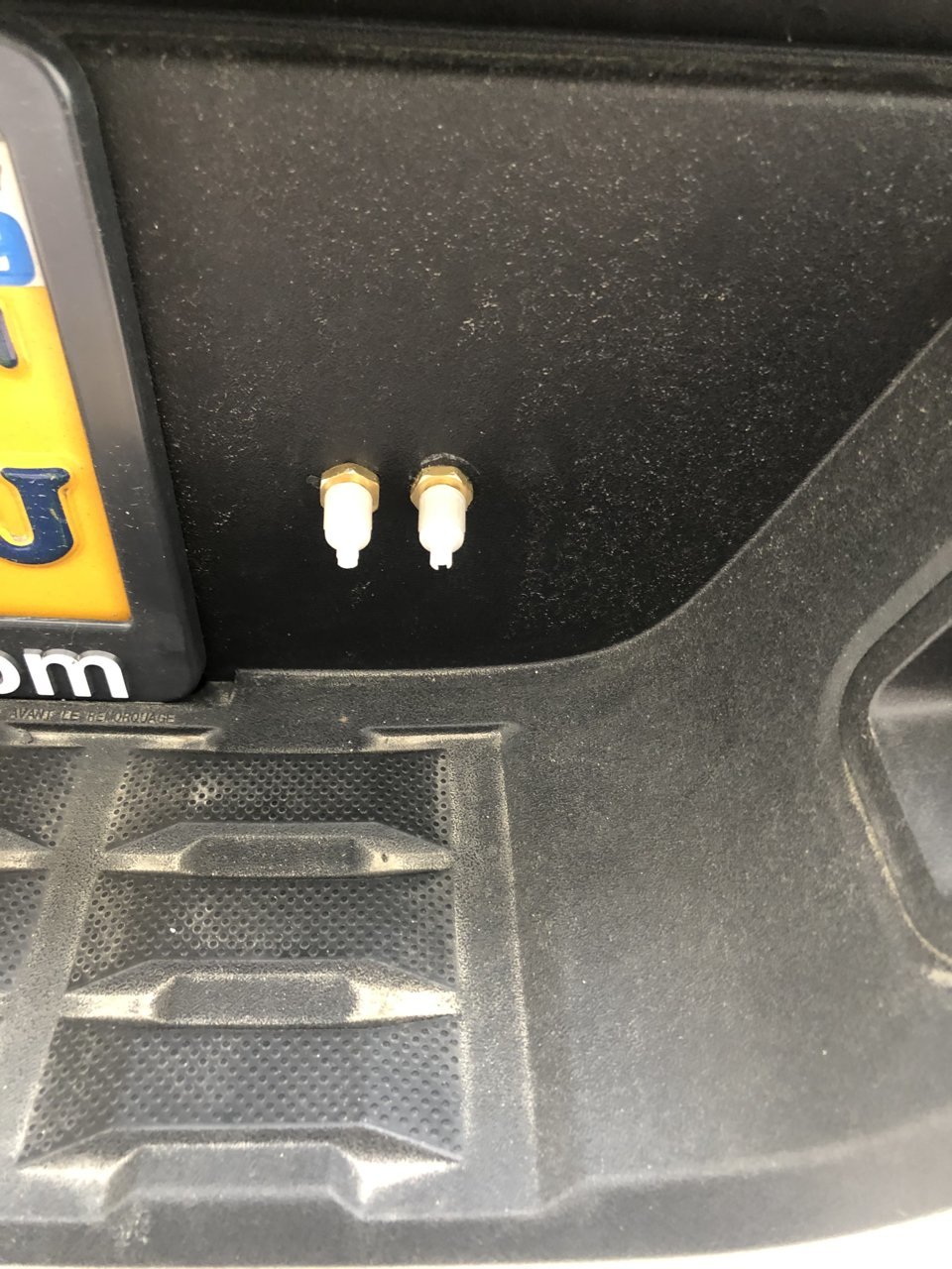

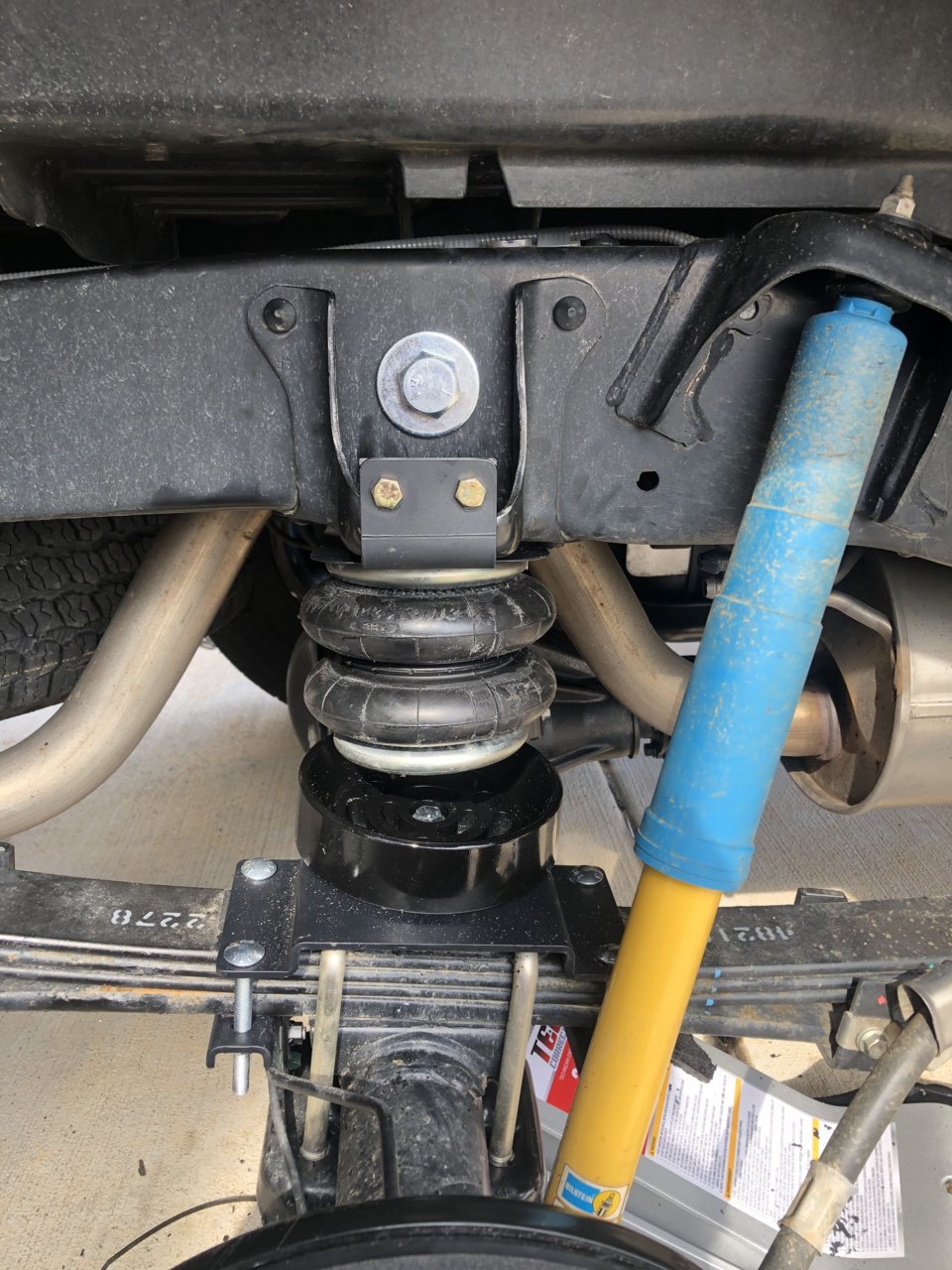

    Firestone airbags installed. No leaks thank god. Took about 3.5 hrs probable would’ve took less if I had found my socket set sooner. Testing them at 10psi first and will adjust as needed.

    Update on the airbags. The truck is best supported at 20PSI with about 500# in the bed. 25PSI with camping and RTT on.
    I have ordered TC bed stiffeners, 12 volt and USB plug for the bed for the fridge. Im also building a roof rack that is alittle sturdier than the cap rack.

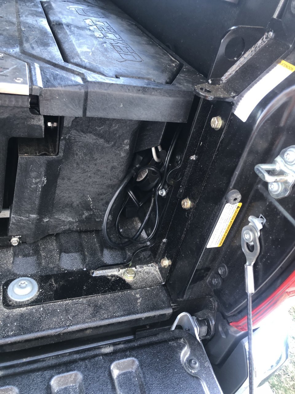

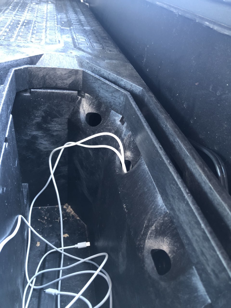

    Installed the fridge plug and 2 iPhone chargers.extended the outlet plug.

    Any clearance issues with the TC Bed Stiffeners and Decked system? Looking good!
