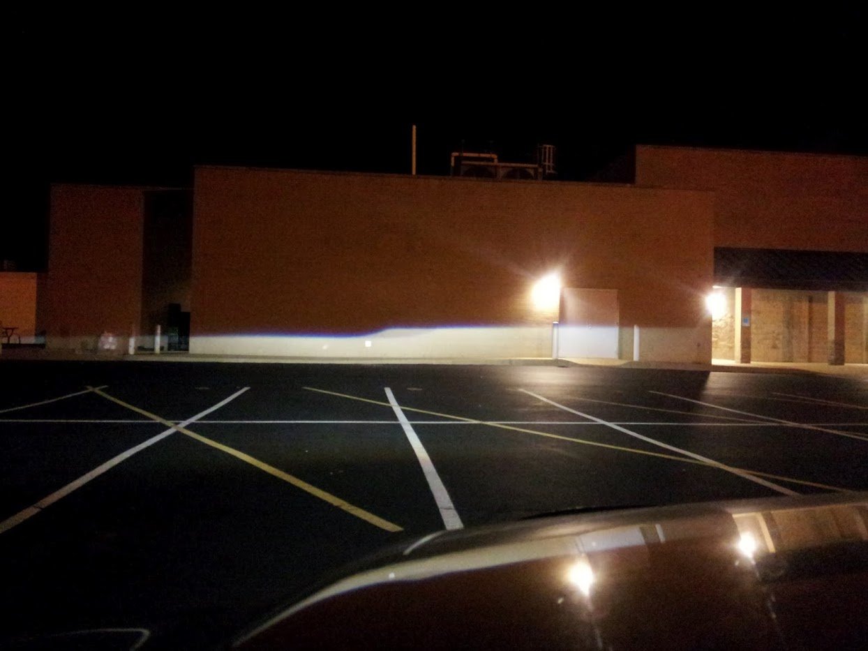

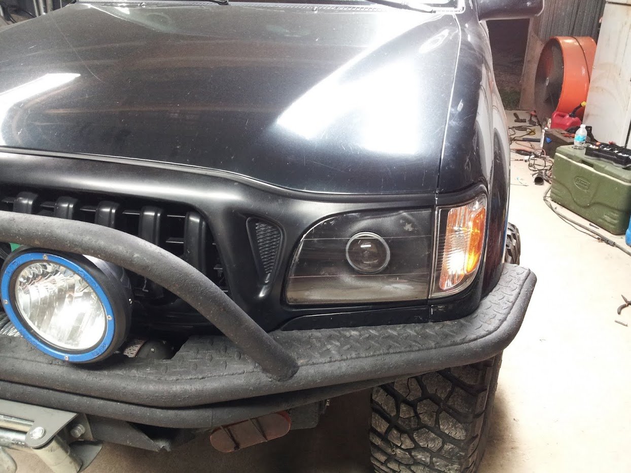

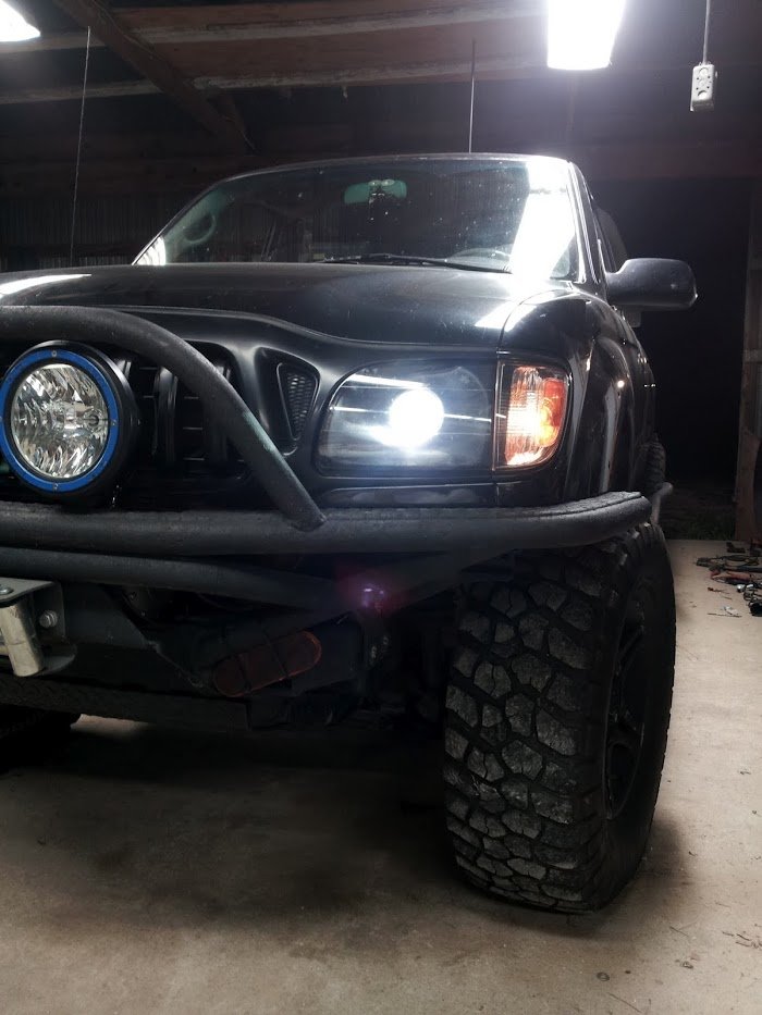

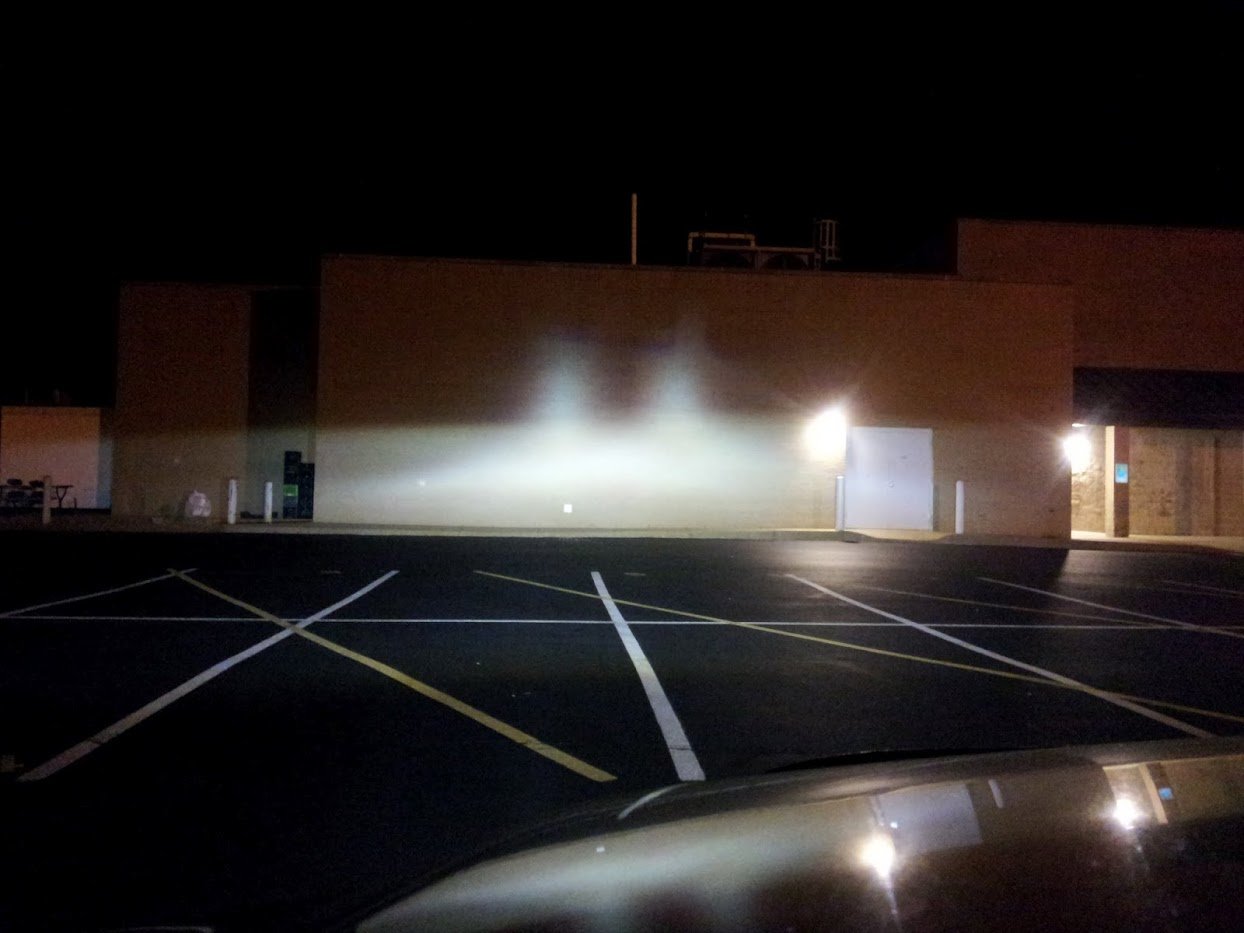

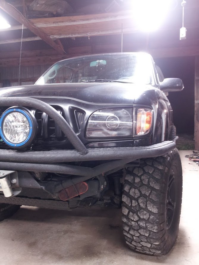

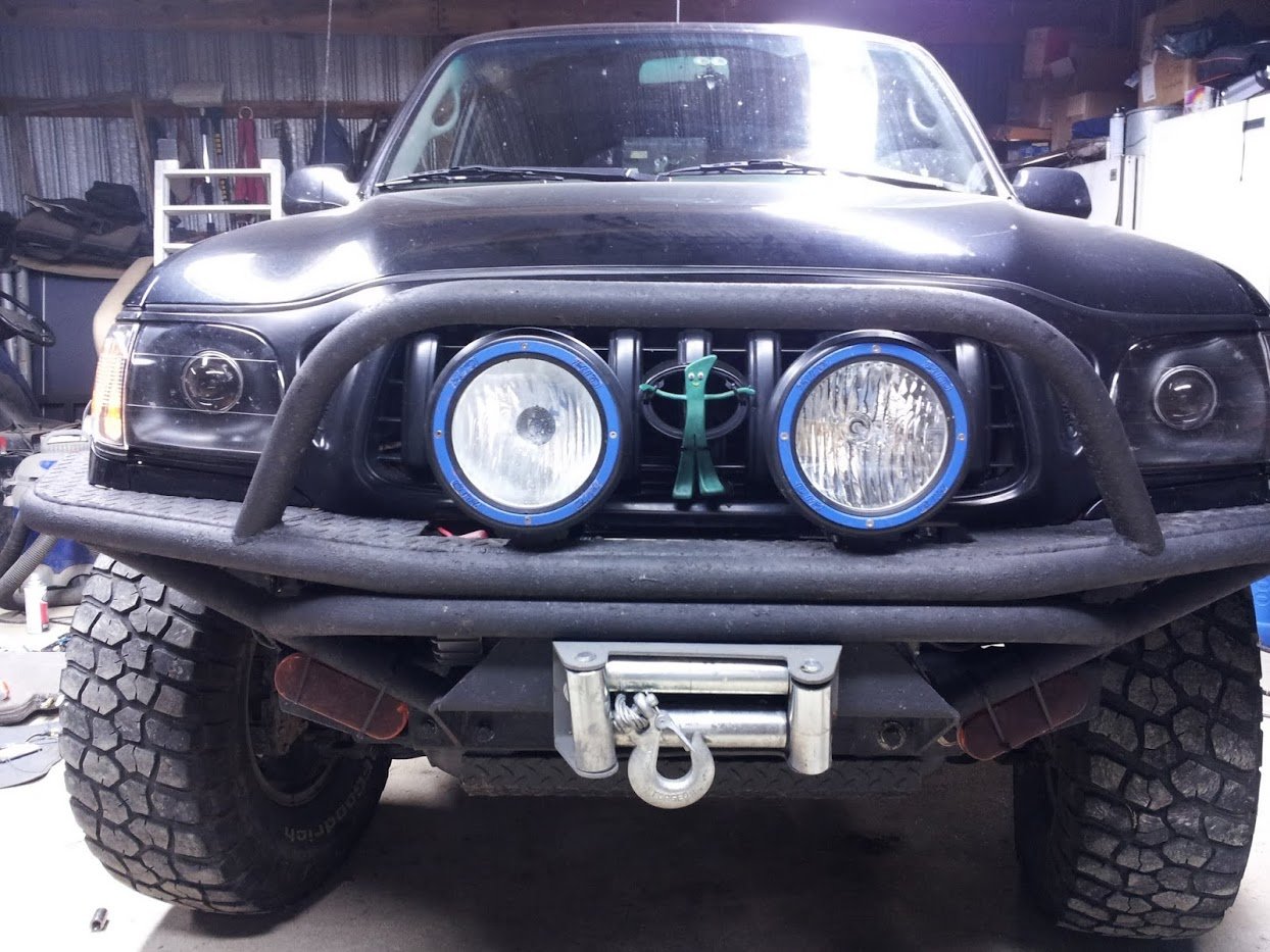

    retro, 2nd time for this truck.
    same i had on the truck before but after getting into a wreck i didn't put them back in until now. sealed them up a little better and put clear housing lenses on.
    clear lenses and spaced.
    low:
    high:
    high w/ 2 7" kragens:
    and my "security system"
