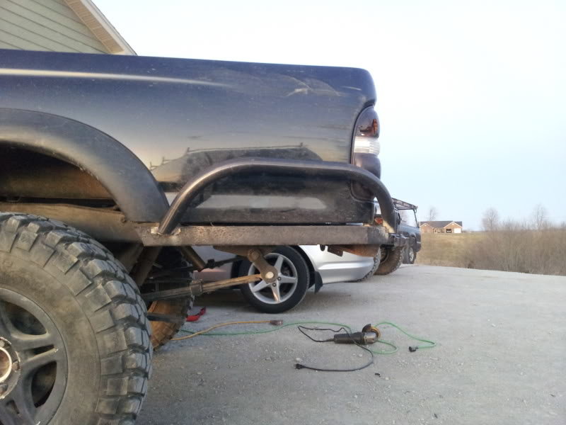

    hack-fab(that's me, haha) high clearance rear bumper

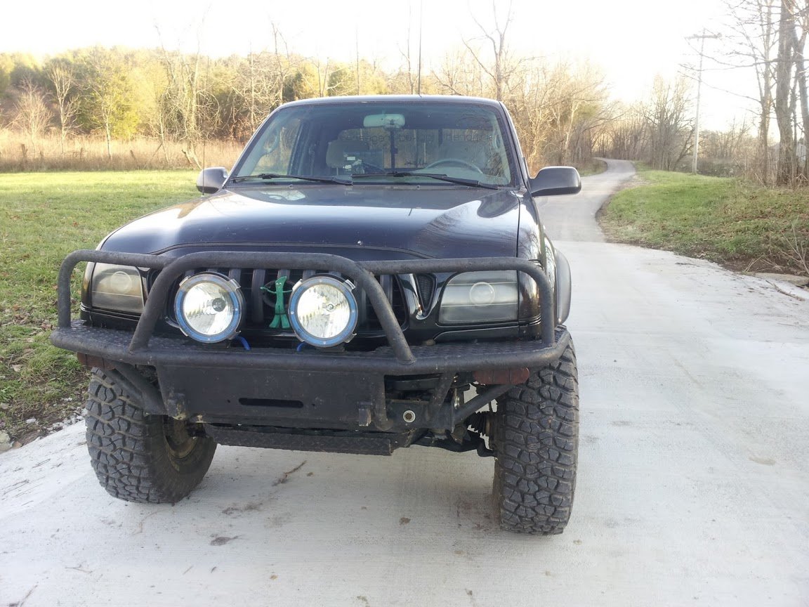

    2̶x̶ ̶7̶"̶ ̶K̶r̶a̶g̶e̶n̶s̶ ̶u̶p̶ ̶f̶r̶o̶n̶t̶

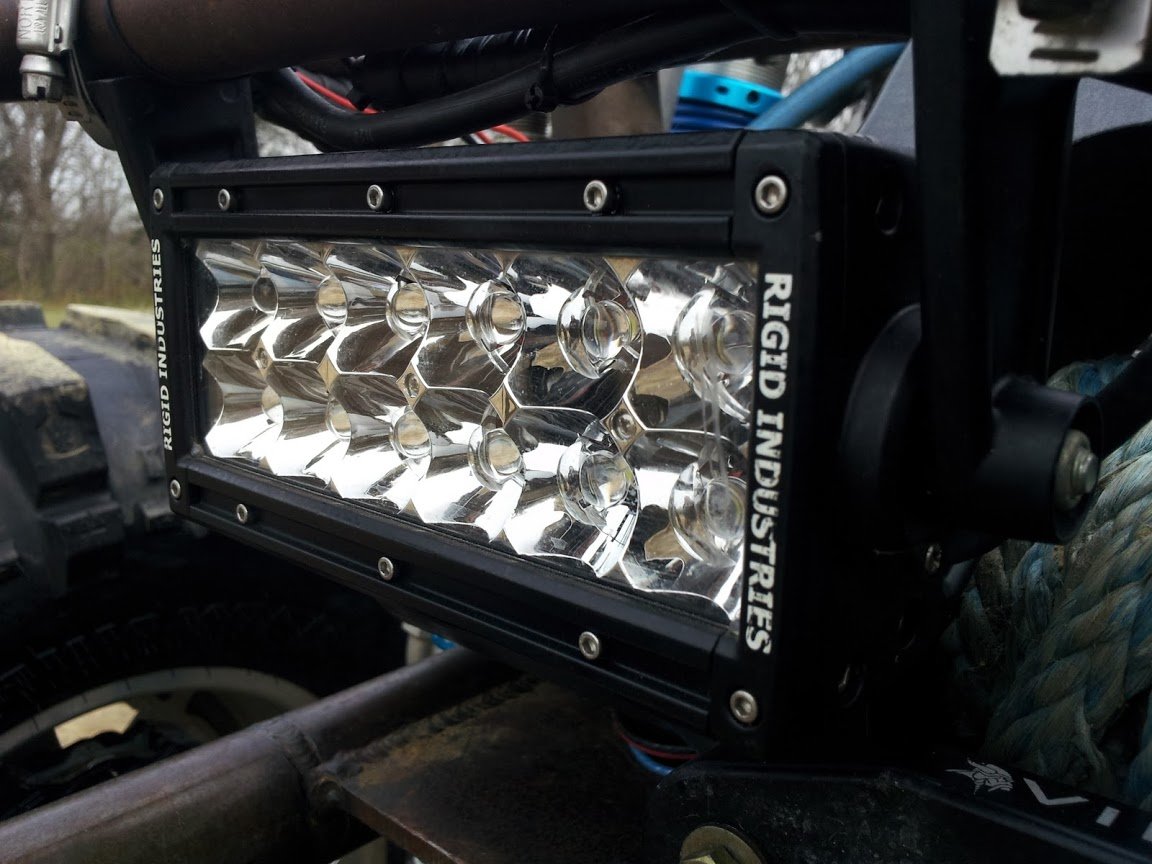

    30" dual row LED light bar up front

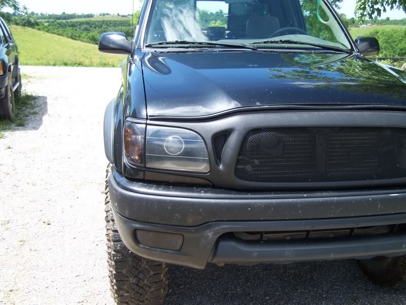

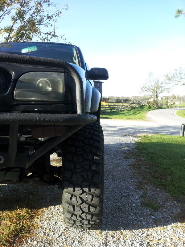

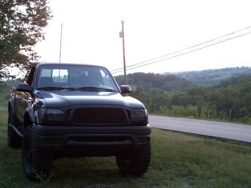

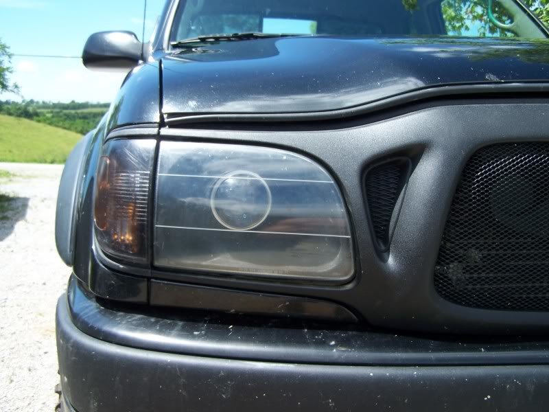

    blacked the lights out.
    and deckplate mod

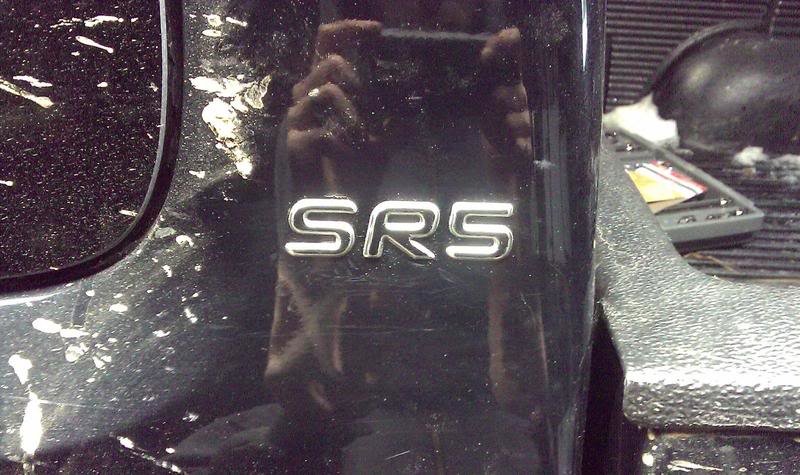

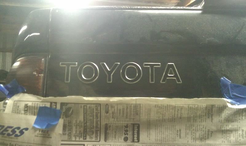

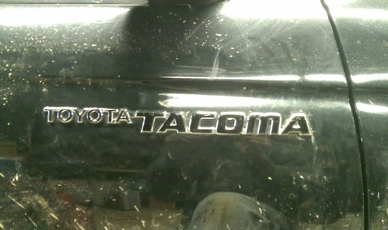

    i wanted to continue blacking out the truck, so the chrome lettering was next to go. i've never seen anyone just paint the badge face, so that's what i decided to do.

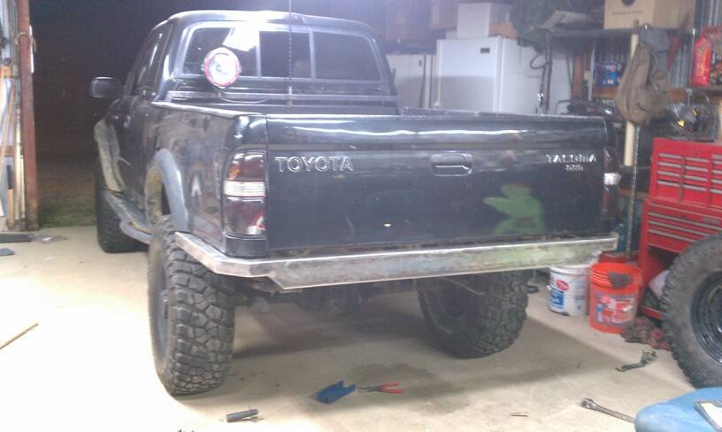

    i also decided to paint the bumpers too
    and got 33" goodyear duratracs put on. loved them for everything but the mud, which i understand they are an AT.
    also got my sliders welded on

  7. Dec 6, 2012 at 9:53 PM

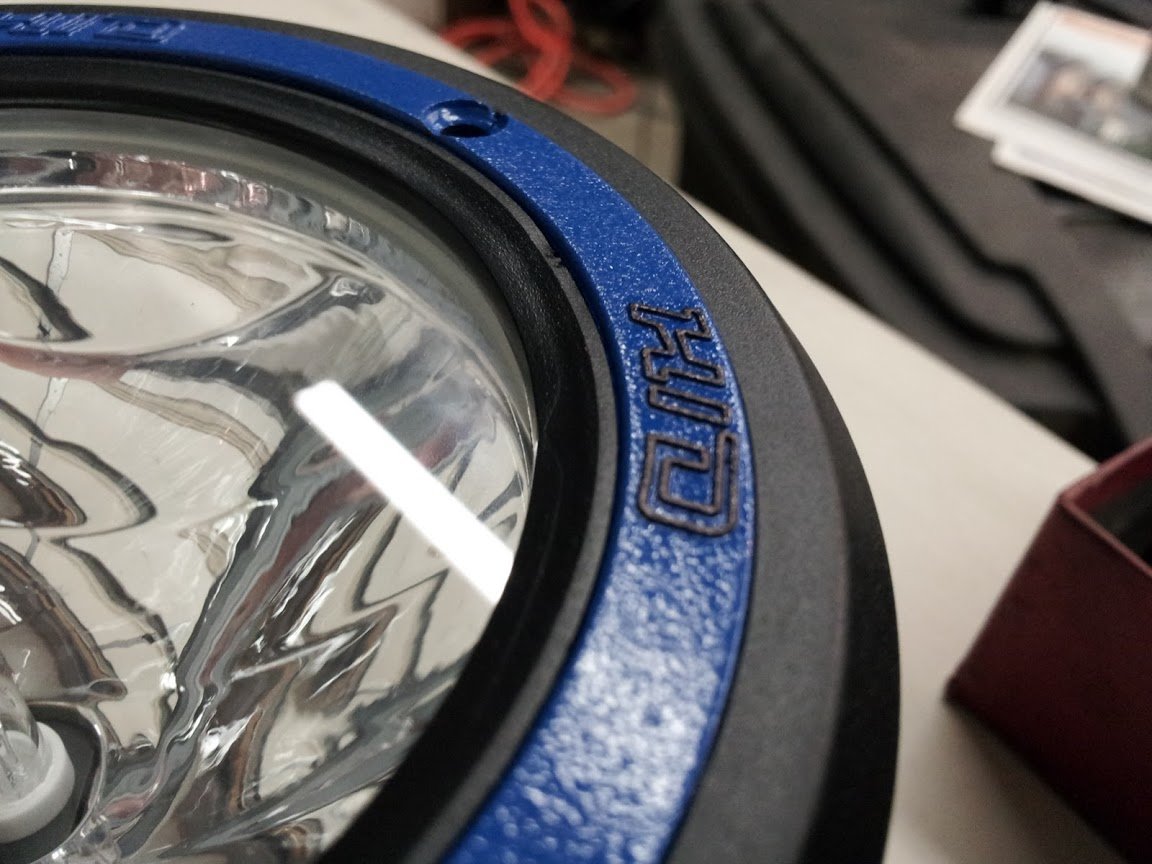

    Nice truck! Love the blue rings on your Kragens

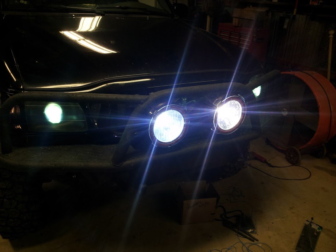

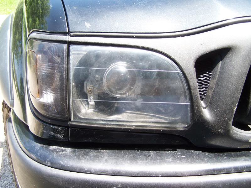

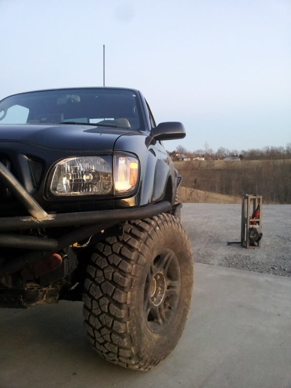

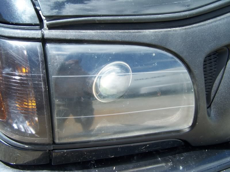

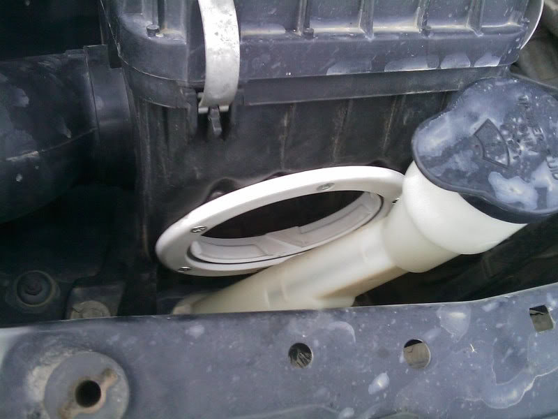

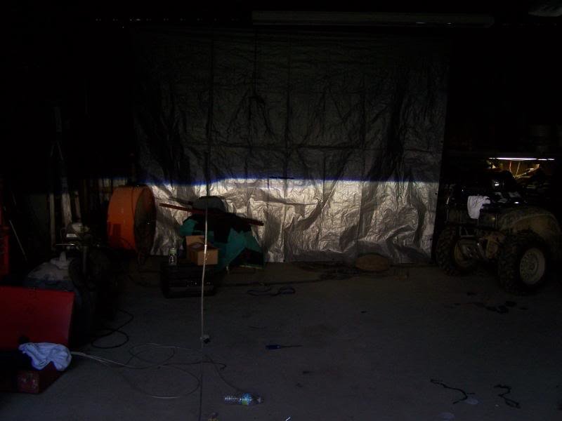

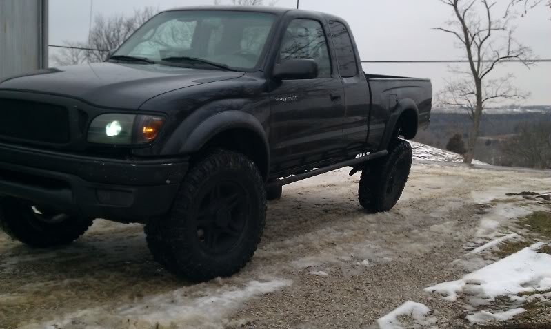

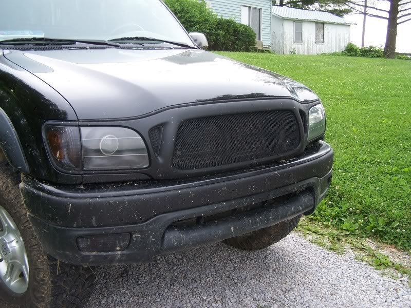

    after not being able to see anything at night, i had to do a retro. i've had experience doing them in the past and i believe this was my.. 5th one i'd done at the time? i'd almost say it was the best thing i've done to the tank.
    i used Porsche projectors(bi-xenon) with philips 85122 4300k bulbs. one of the reason with choosing the Porsche projectors again was the fact they are one of the widest projector out there.
    at 25ft, the top cut off is 37.5" from the ground.
    and vacuum formed my own shrouds. also looking through these i realized i forgot to mention i did a grill. bought the mesh at lowes.
    andddd more black was added. wheels. and beefed up the stock skidplade.

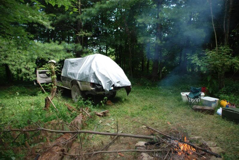

    another harlan trip with my girlfriend at the time:
    my ghetto tent:

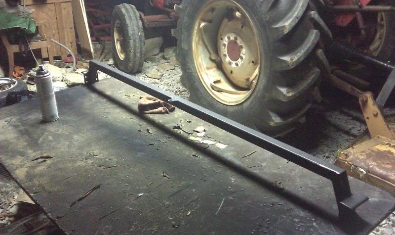

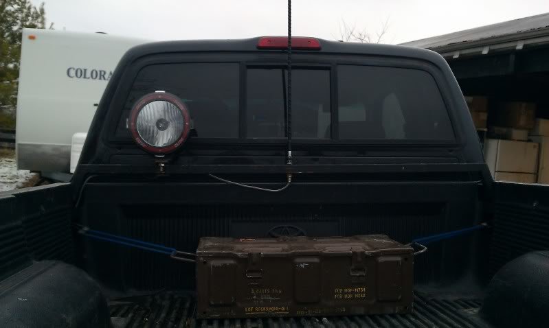

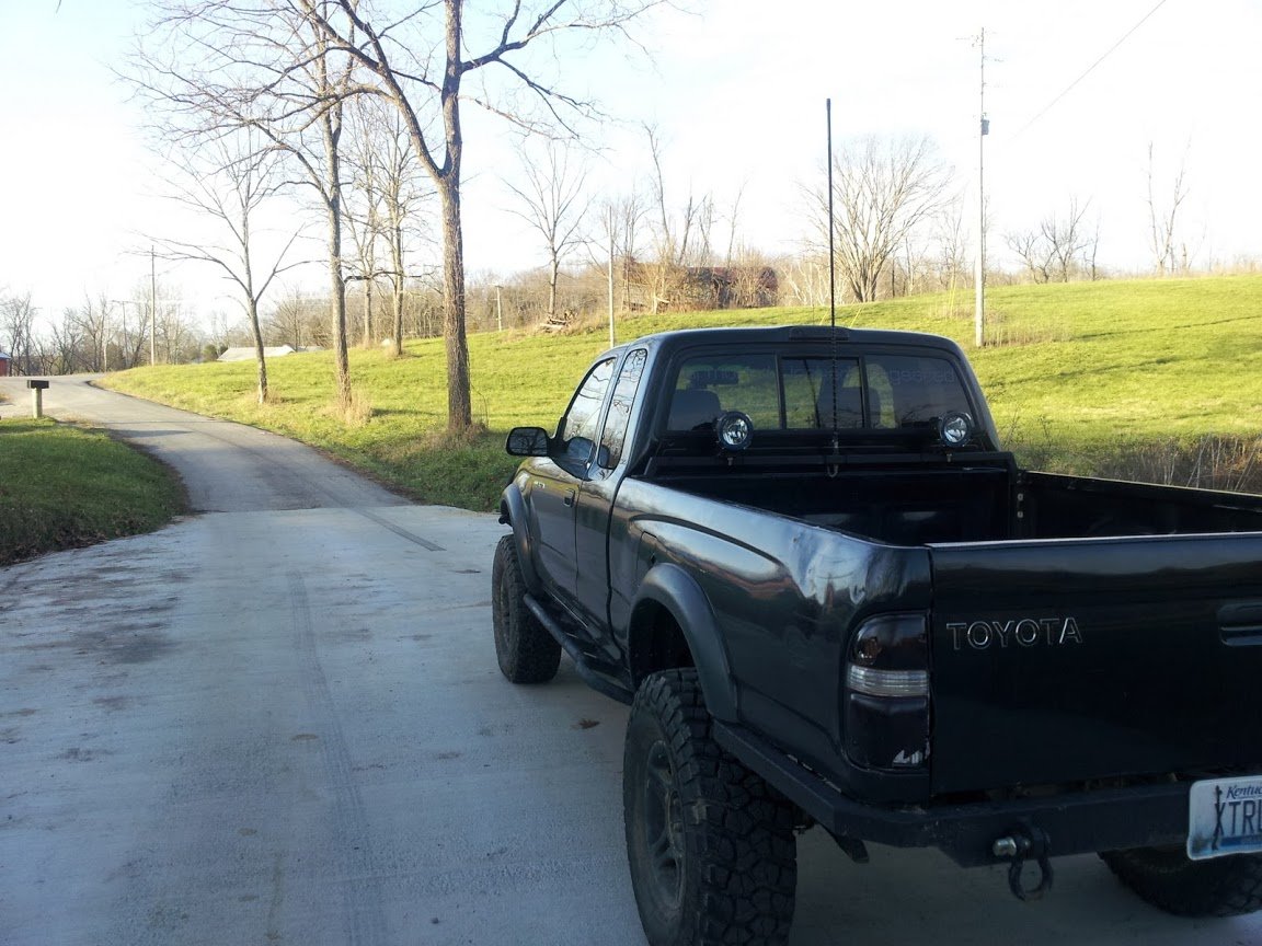

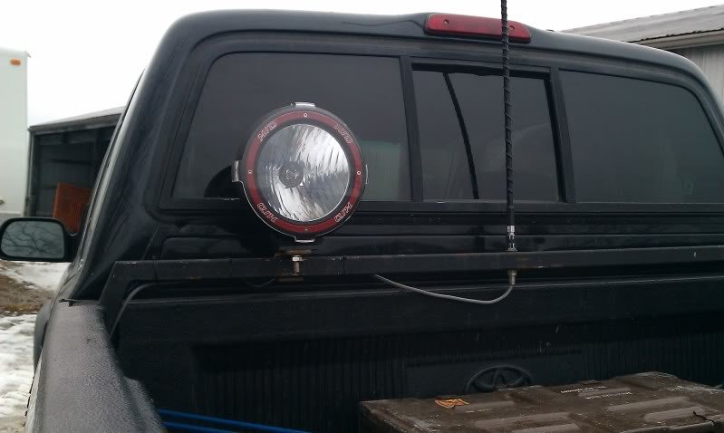

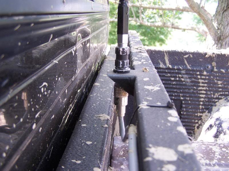

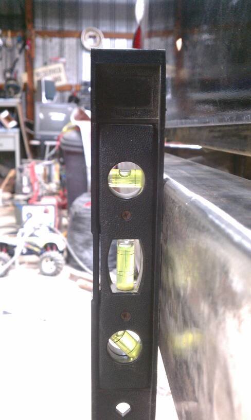

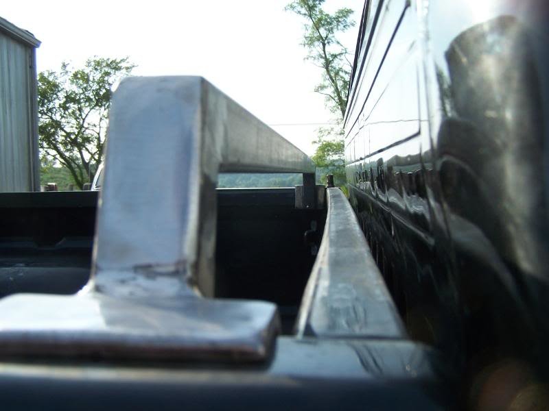

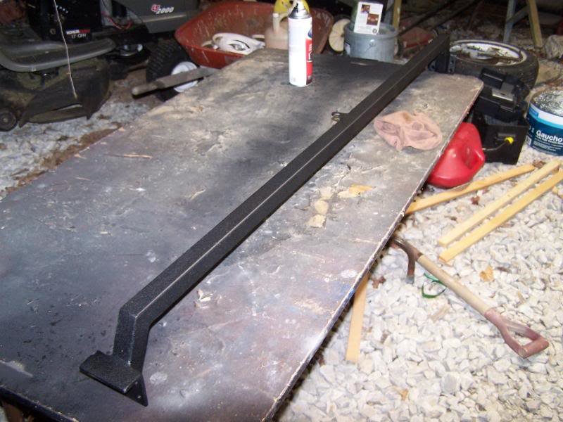

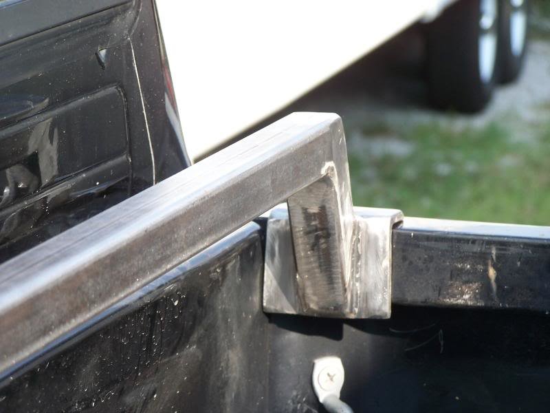

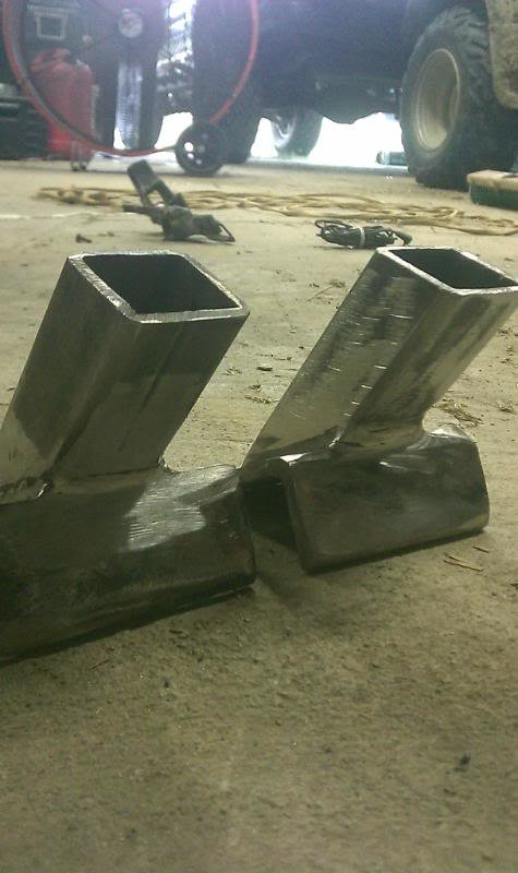

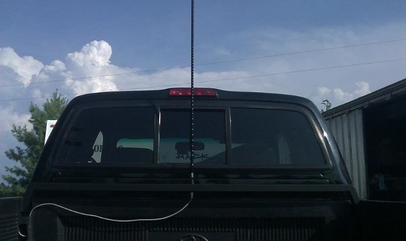

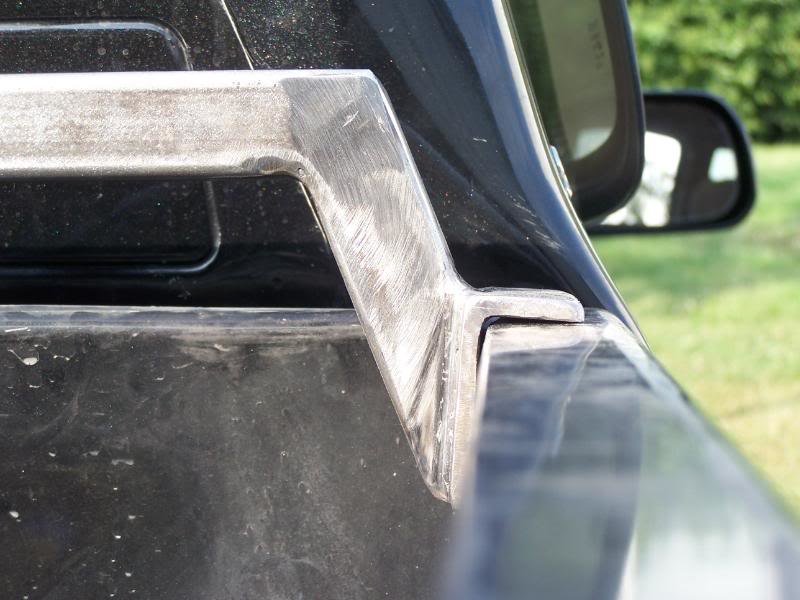

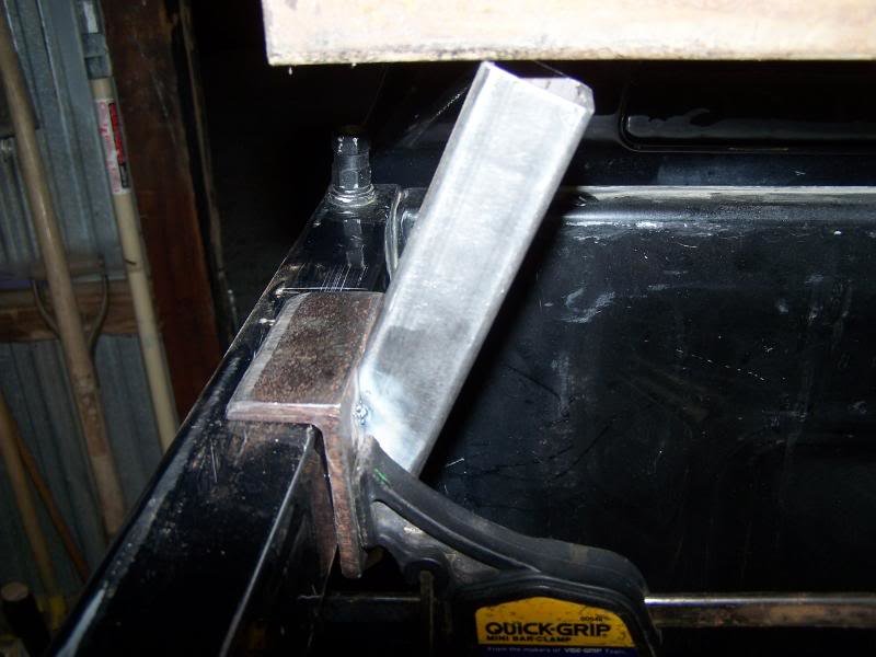

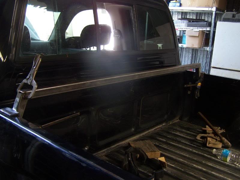

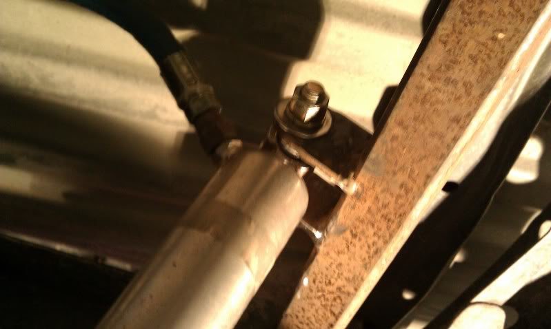

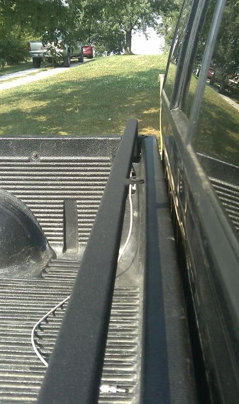

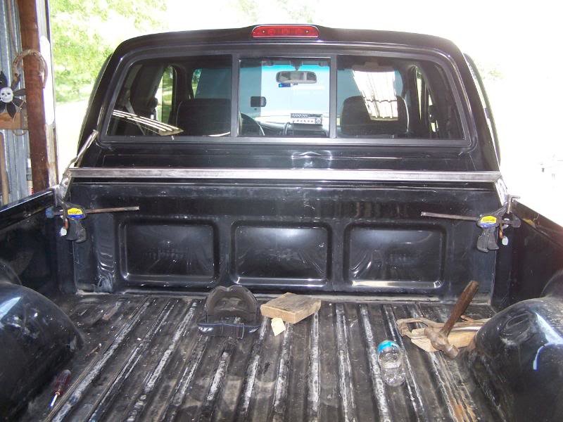

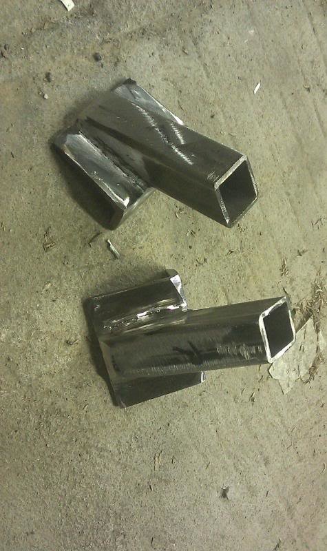

    made my bedrack and eventually found that my cb ant mount was too weak. there's a ton of pics on this one, sorry guys.
    i made the support arm angles to be about 25°, which looked to be the same as the side of the cab coming up.
    and fixed!

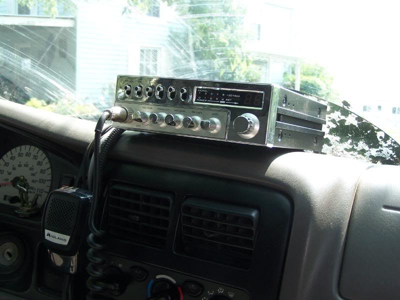

    this is the CB i was using. it was given to me for free and was only help on by industrial velcro, it wasn't going anywhere though. when you tried to get the cb off the dash the velcro would hold so fight the bottom plate on the CB would bend.

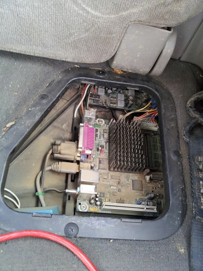

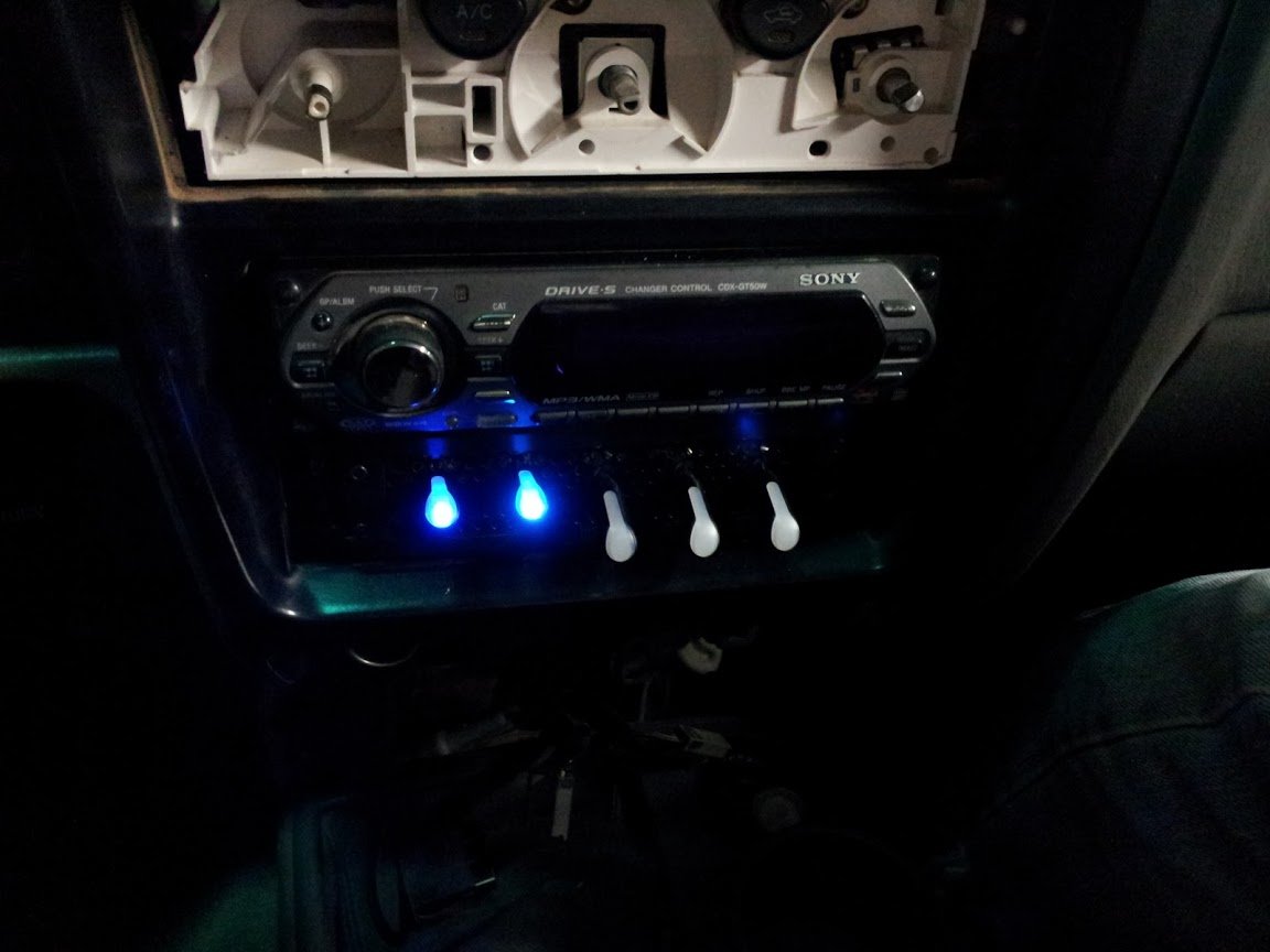

    this would be the start of my truckpc. i had this in my car previously which is why it sayd "carpc" on it. at the time of these pics it was on windows xp with an 80gb hd and 1gb of ram. i think it was a pentium 4?
    it used to be a nice clean truck.. till i started some :sawzaw: poser shots!

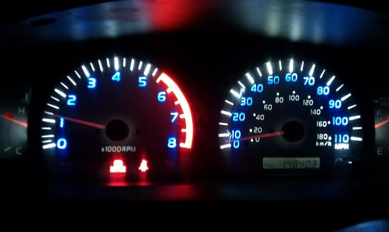

    not a fan of red lighting.
    24 white superflux 5 chip LEDs. def an overkill, but i made them for another project a while ago and never used them.

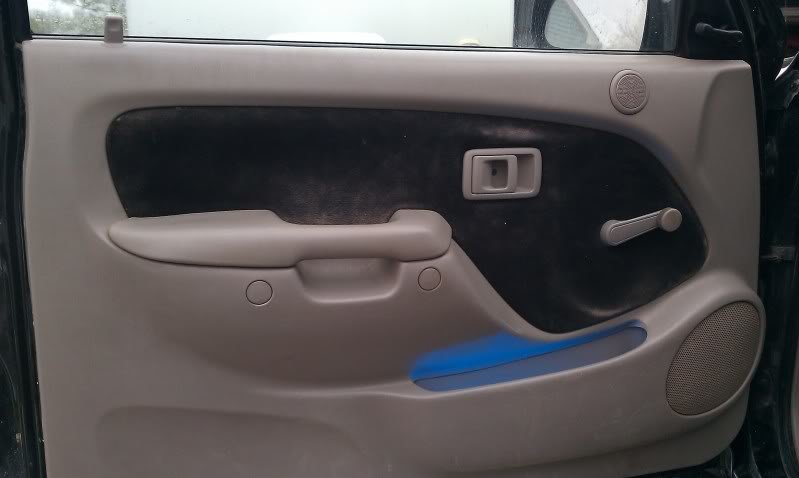

    i painted the door fabric black to match the rest of the truck.
    i also put a 12" blue cathode in the door pocket, and have 3 SMD LEDs per side in the footwells.

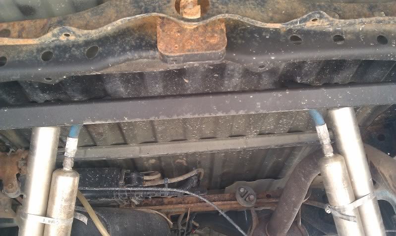

    then it was time to start on the suspension.

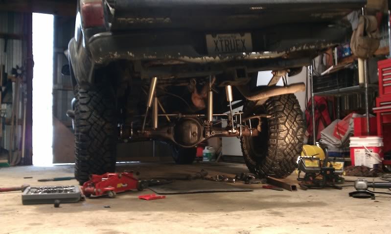

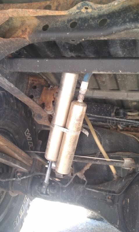

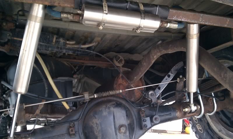

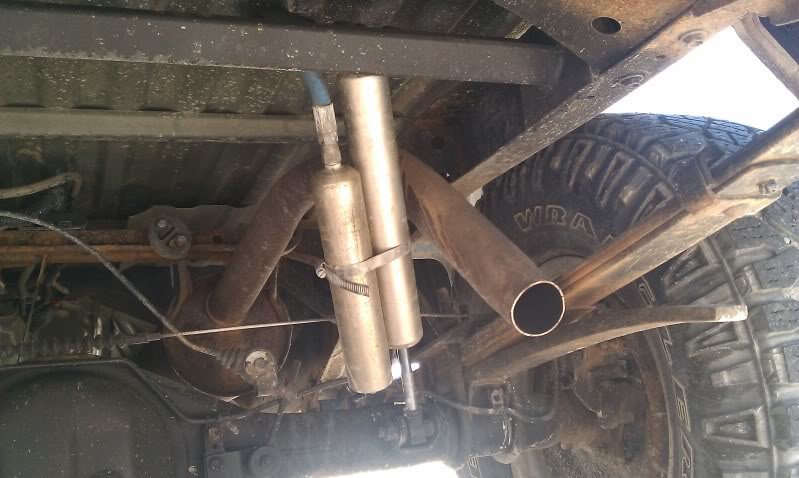

    bilstein 7100 10" stroke
    they sit a few inches back from stock, and are angled /\ just a tad - 6" in from the frame box to be exact. and my redneck way of attempting to stuff the tire.

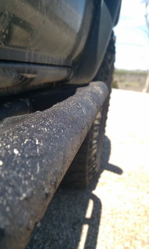

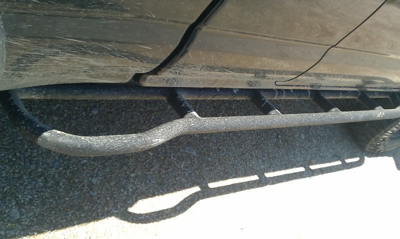

    the sliders had rusted bad. i originally used spray on bed liner (rustolium i believe) because i loved the finished texture but i had already re-sprayed it twice so i was done with it. it works great as long as whatever you spray doesn't get touched often. so. ~3 hours of sanding on one side, it was ready for something new. i picked up duplicolor bed armor with kevlar and got to work. i love the way it came out, but i don't have anywhere to test it just yet.

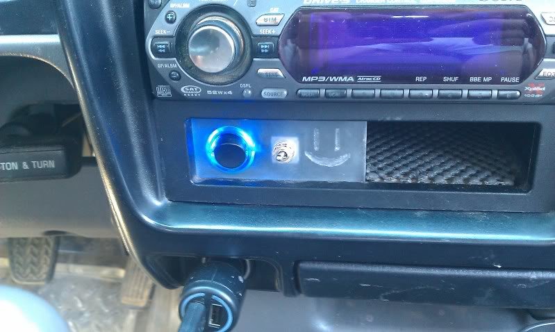

    the last switch mounts i made for my aux light and interior lights was a joke. so i remade it. frosted the front, and added .. well yeah. haha

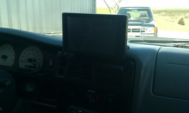

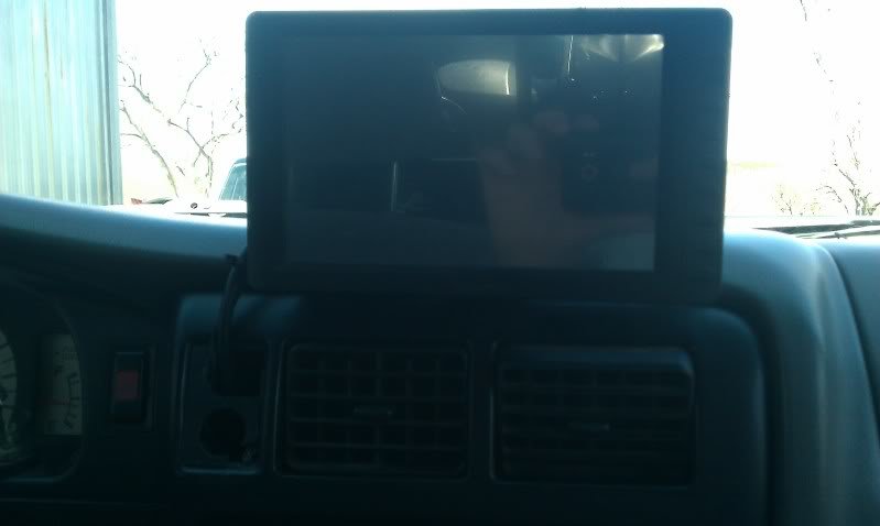

    and remounted the truckpc screen
    and also upgraded the hardware.
    it's so nice having all my music and videos at my fingertips, as well as the internet, and everything else i could possibly need.
    dual core intel atom with 2gb ram. 200gb sata hd @ 7200rpm and 7" touchscreen.

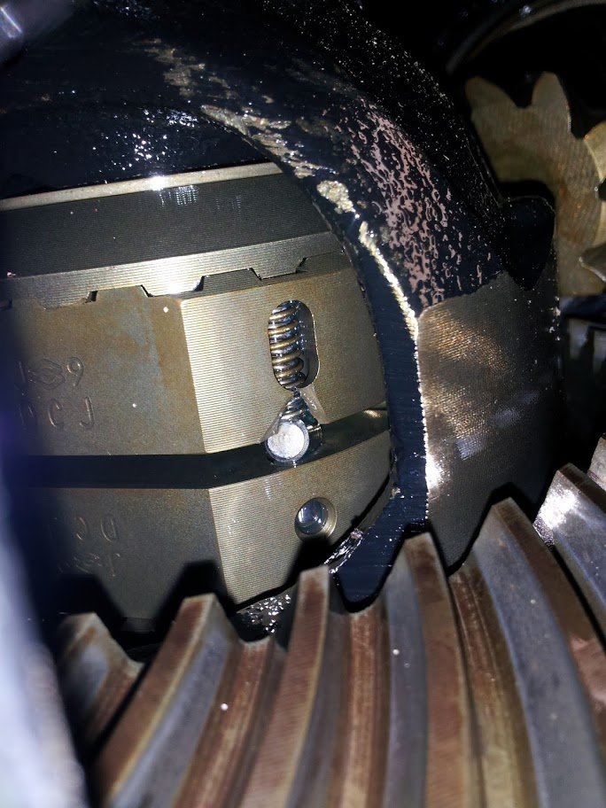

    lockright is in the rear. in the tanks life time, i've gone through 3 lockrights. i will never recommend them again if you do any serious wheeling.

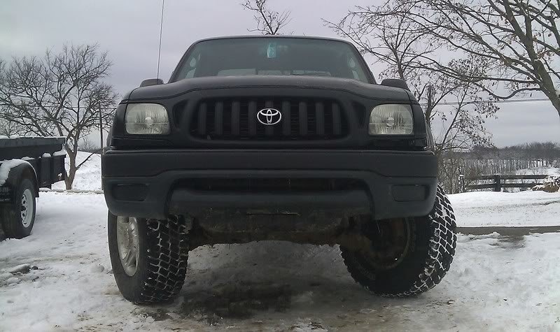

    snow wheeling (before sliders)

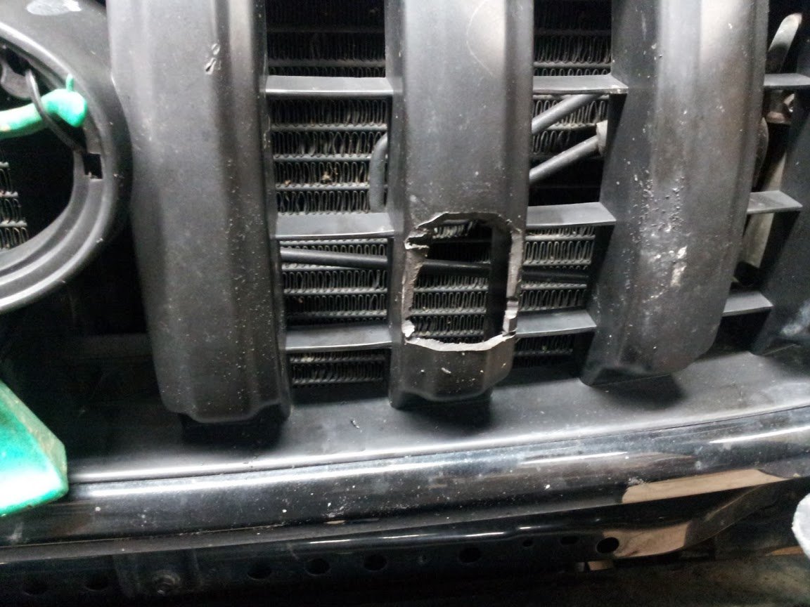

    oh and remember that pic with the chevy tied to me pulling me out of that mud pit? i didn't like it in the picture with me and needed a background for my phone.
    ended up hitting a deer. snagged a badlands bumper out of it.
    that stupid little thing did $2500 worth of damage.

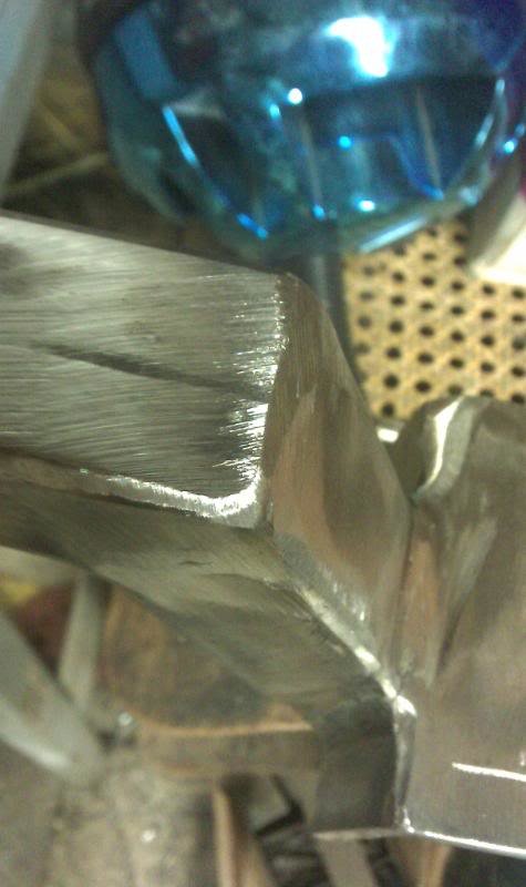

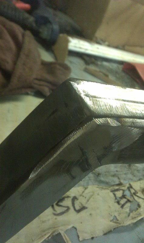

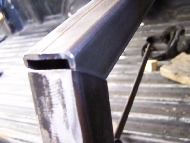

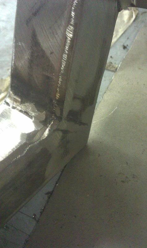

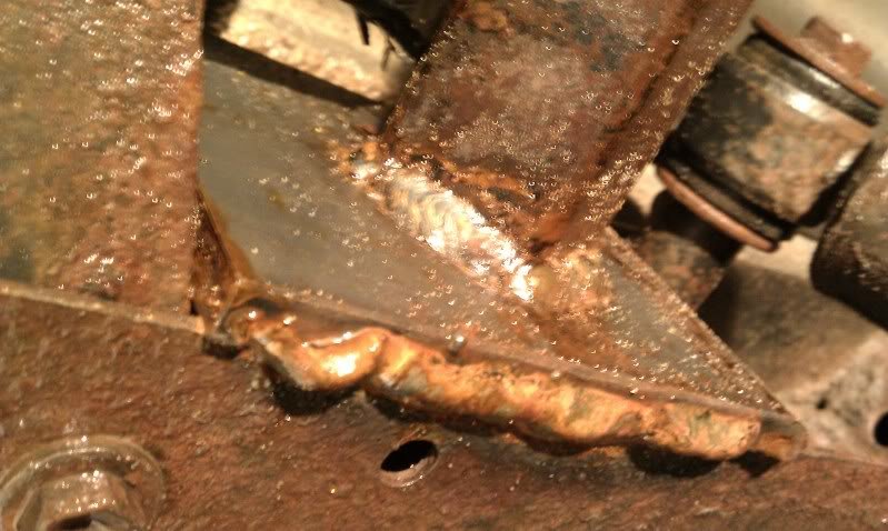

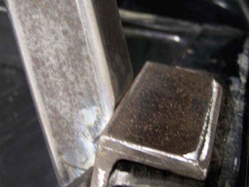

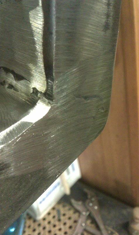

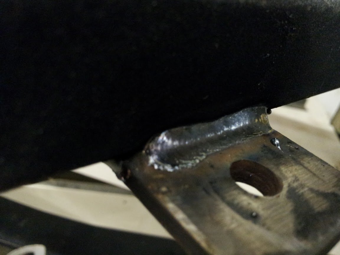

    made tube doors. i think this was only my 2nd welding project. used flux, and i know it looks like junk but so far they have held up nicely.
    had a 6" tree stump eat my sidewall. afterwards, went with 33" KM2s
    how to stop rain when you have on tube doors
    bye bye bedsides
    oh, the older yotas didn't even need to cut their bedsides... they just rust out ;)
    compared to my other stuff, i think the welds came out great!

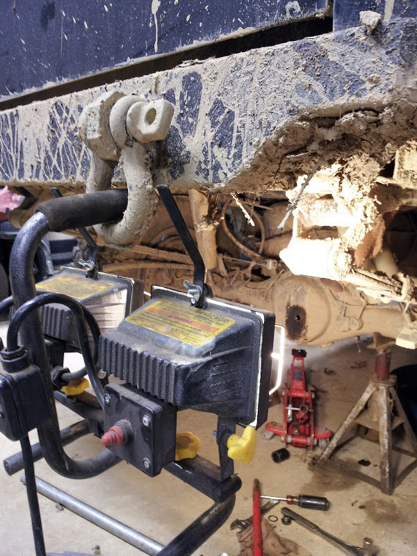

    got stuck bad and had to get pulled so hard it bent the frame. luckily rust recall saved my butt
    (taken from my thread)
    went wheeling a few days ago and decided to climb a creek bank only to find a 8ft drop off right over the top - which i didn't know until half the truck was hanging over. after 7 hours of trying to recover it, i finally got a buddy with a sami down to pull me out. haha that was the best part, because every time he tried to pull, the whole sami would literally jump off the ground and go sideways. anyways, he got me out but when i got back home i noticed the bed was sitting low on the driver side. i just thought the bumper i recently finished(last week) bent up since he was only tugging on one side. after further inspection i see that my frame is bent right past my slider in the bend that goes up to the bed.
    what the heck. i'm surprised the bumper didn't give at all and the frame bent first. not looking forward to the price tag to fix it :\
    these are the tires just hanging off the dropoff
    so toyota replaced the frame and blahblahblah. it was perfect timing, that's for sure!

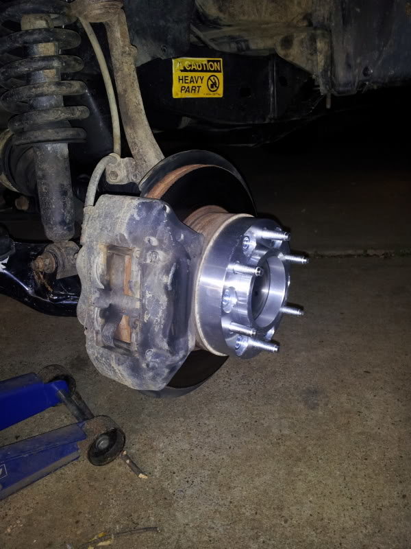

    oh yeah, i also added 1.25" wheel spacers from all pro to stop my rubbing. tires are even with the fenders

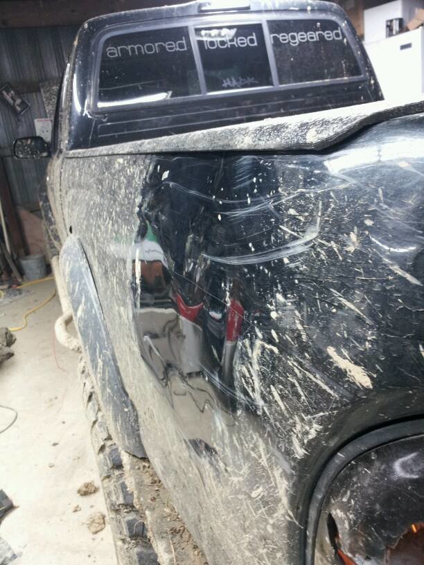

    finally got some body damage
    tried to pop it out the best i could, but i think it's worse.

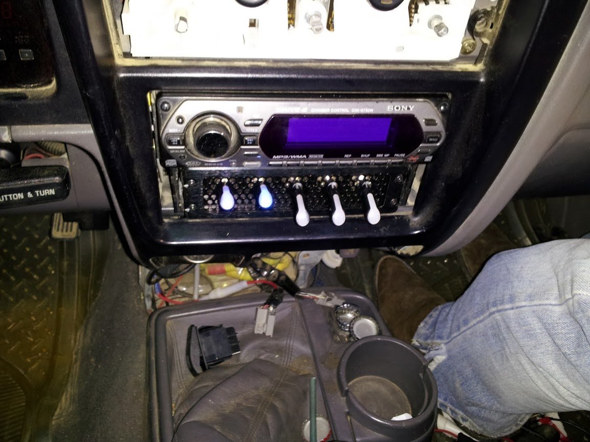

    got sick of one of not being able to use my phone charger when the truck isn't on, so i snipped the switched power and tied the power line into the stereo power.
    don't know how to show that it works with the truck off, but here's 2 pics

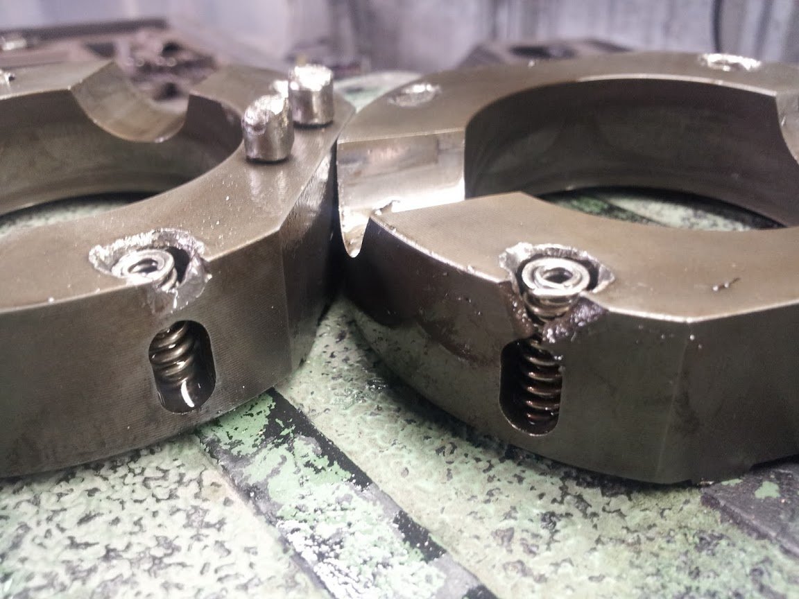

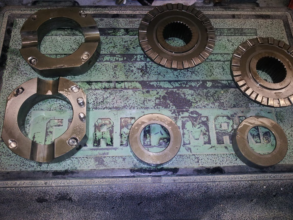

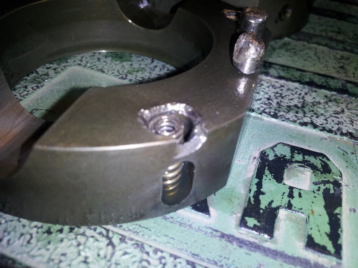

    killed the lockright.
    richmond replaced it under warranty.
    clevis' can be used for more than pulling people out with
    getting prepared for some upcoming electrical additions. so wanted a new switch panel. originally bought these switches:
    but seen this at microcenter and figured i could use it:
    then found out that microcenter carries one that already has LEDs on it. so i returned the green one and got one of these. it was a 3 way switch with red and blue LEDs:
    (review)
    http://hardwarebistro.com/?option=c...FAN-ATIC-5-Port-Military-Switch-Baybus-Review
    but it was going to be more a headache than anything. it required both a 12v and 5v input. the LEDs were wired for 5v and the switches put out 12v on one position and 5v on another. that wasn't going to work. none of my relays switch on 5v, i think 7v was the lowest. so i had to redo it all. went to radioshack and bought single switches that had red and green LEDs in them, so i took that out and made them blue. here's it finished:

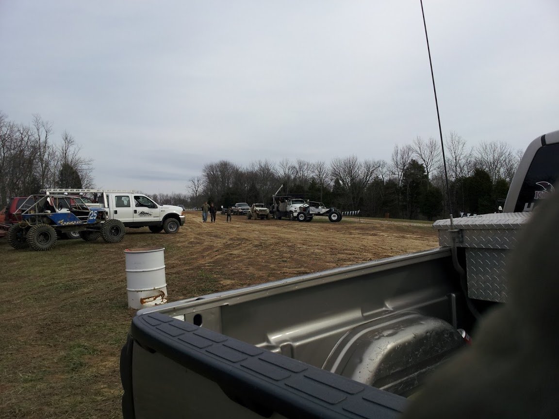

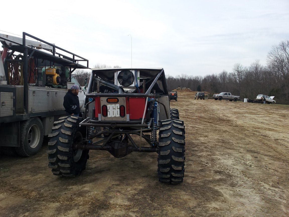

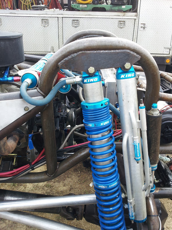

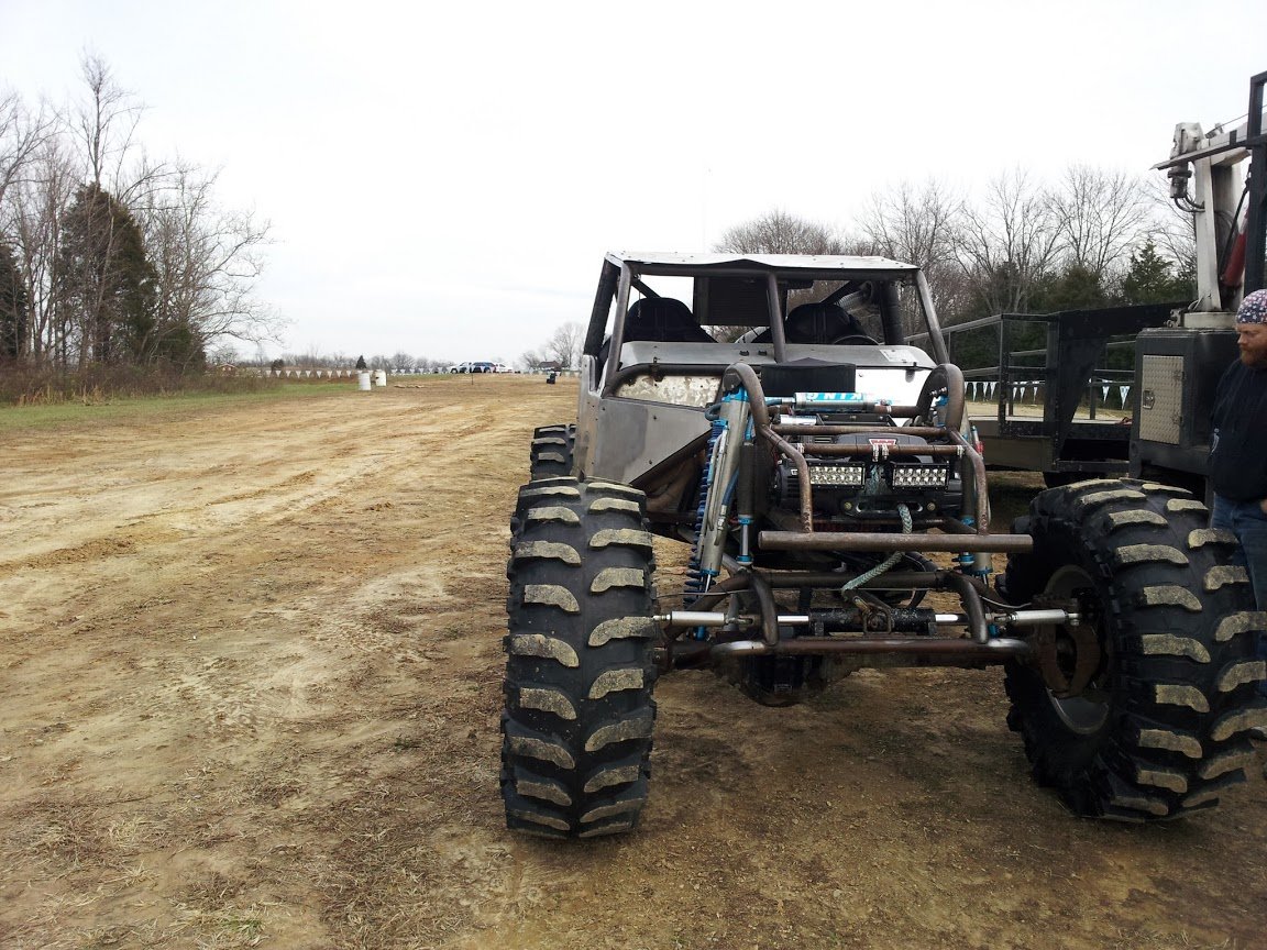

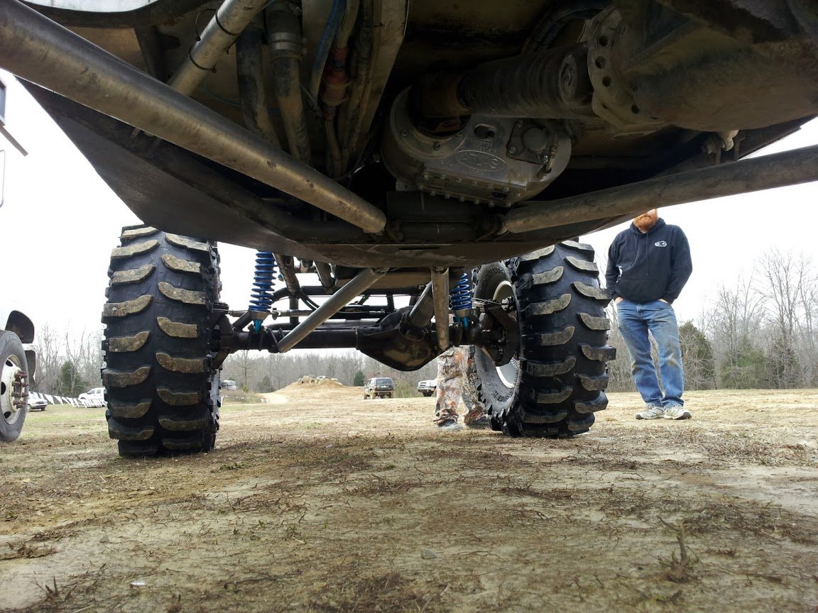

    rode with some friends up at dirty turtle and seen Mike Sweet, number 366 from KOH. basically drooled over his rig. got a few ideas from it.
    first two are size comparisons. this is a beast. the second is tire size next to by buddy who's 6'5

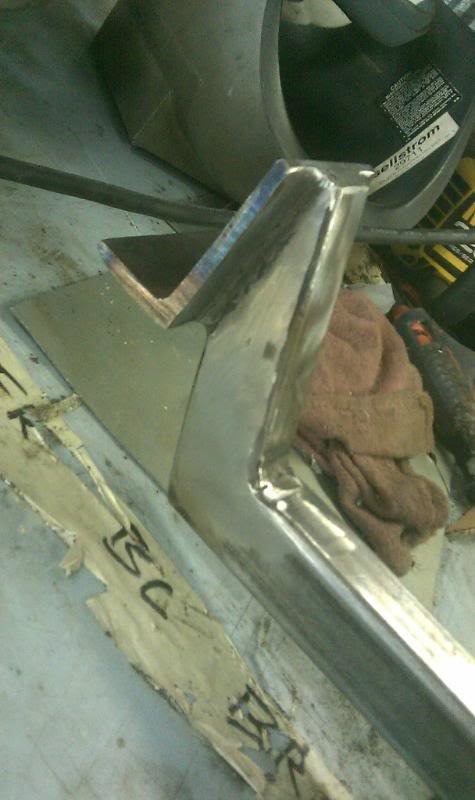

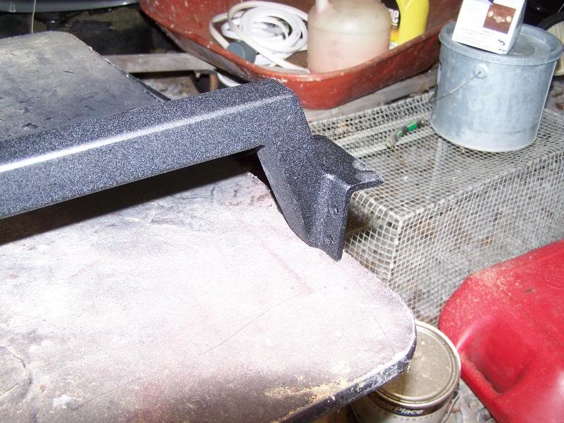

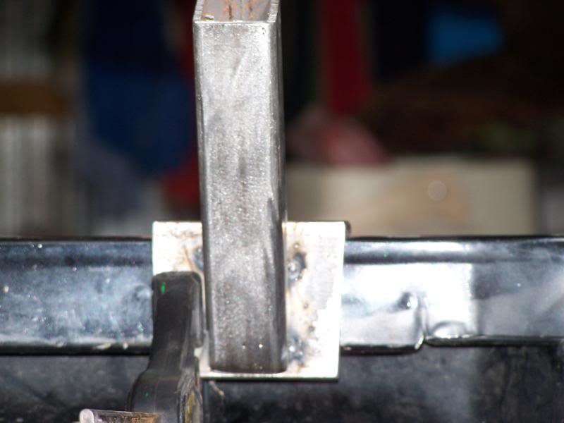

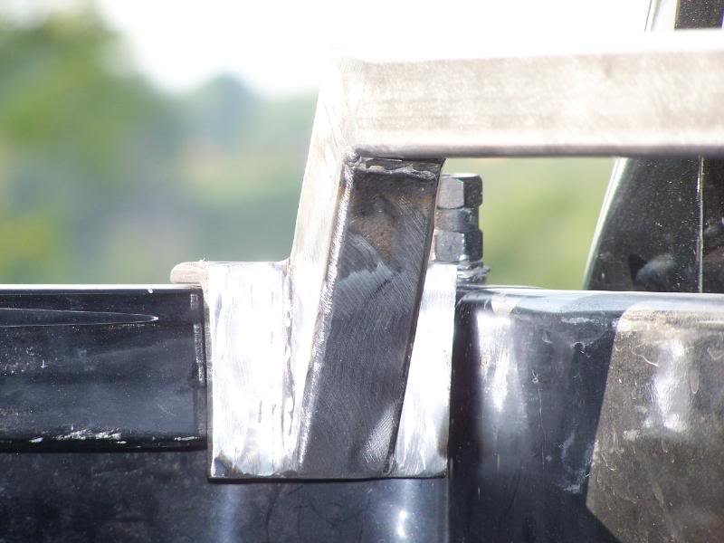

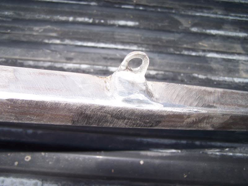

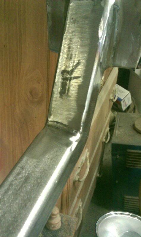

    ordered new kragens from the group buy. had to weld a new tab on my bed rack for one of the 4". moved my old 7" up front so that i have 2 7"s up front and 2 4"s on my bed rack. you can def see a difference in design on the 7"s. the new ones have different pressure bulb making them seem brighter. they also don't use an aluminum mounting plate but plastic which feels incredibly cheap. also changed the wire loom to blue. new theme will be black with some blue parts.
    talked my buddies into getting a kragen or two. these are just random pics

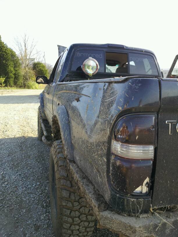

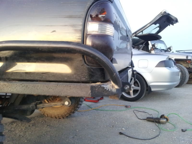

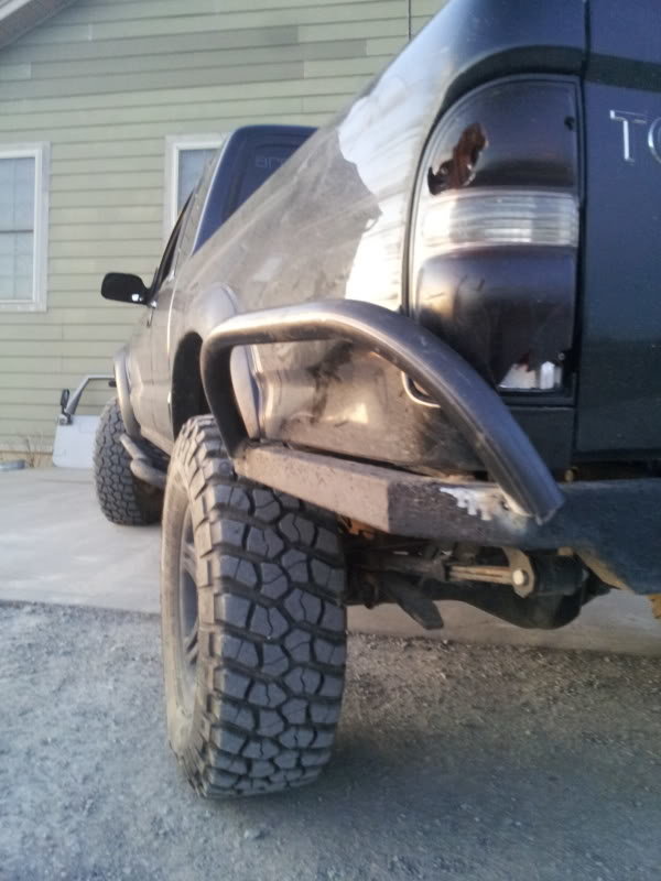

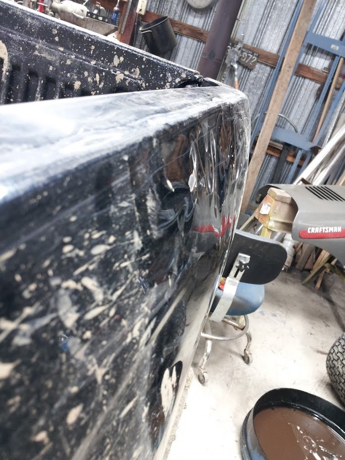

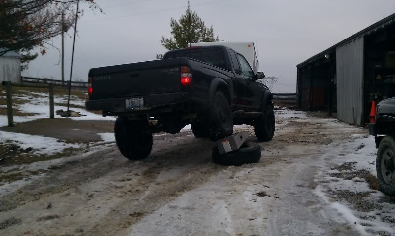

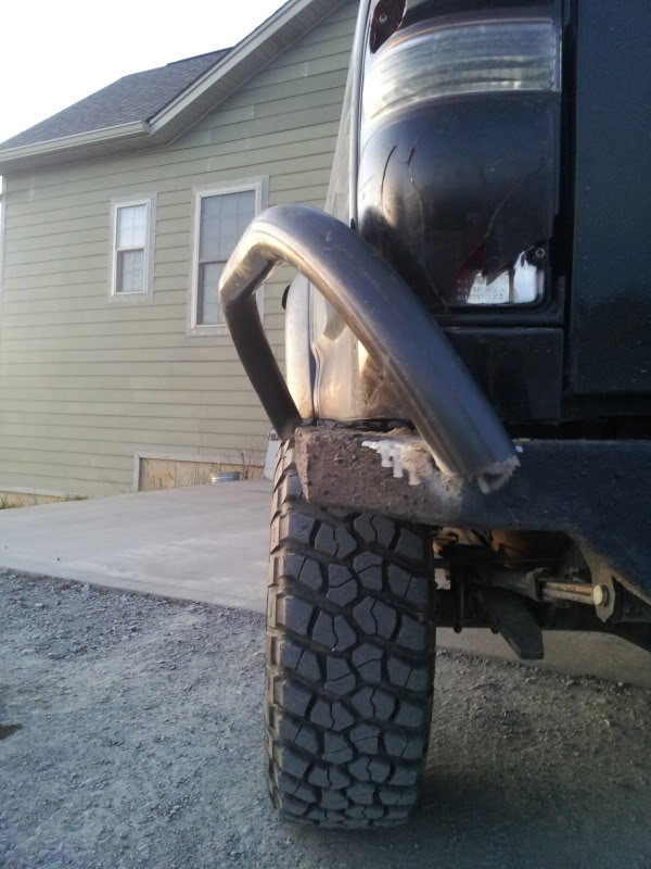

    then tragedy struck.
    The parking brake somehow failed after i started it to warm up and it went rolling over a hill backwards. jumped a rock drop off, did a 180, took out numerous trees, a bee hive house, and finally was stopped by a tree, still running. hopped in and back it up off the tree.
    if it wasn't for the badlands bumper it would for sure be totaled.
    was a little less than $200 from being totaled.
    but i had too much work into it, i wasn't about to let it go.

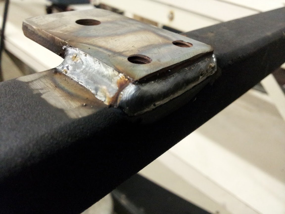

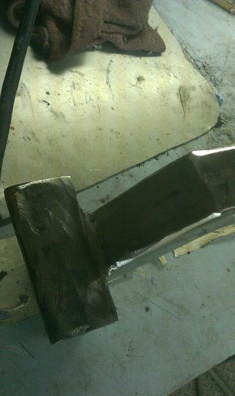

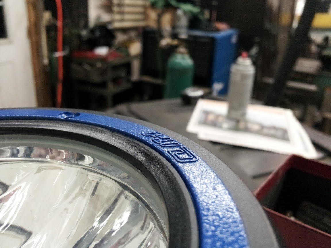

    this came in and already decided i wanted it plated and was going to make a light bar for it. since i was driving a rental car and the plasma cutter was at my uncles i loaded the car and left.
    trip to 491 offroad to rest it all out. it was a day after i got it back. i also slightly slid into a tree haha.

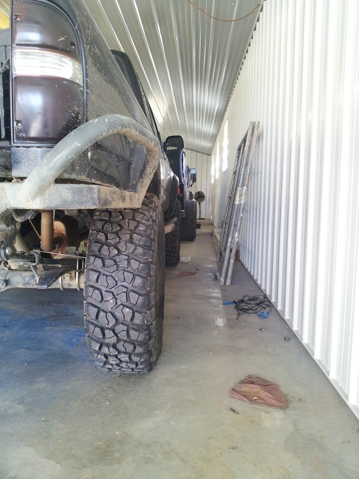

    my rear bumper has always been my main cause for getting me hung up on stuff.

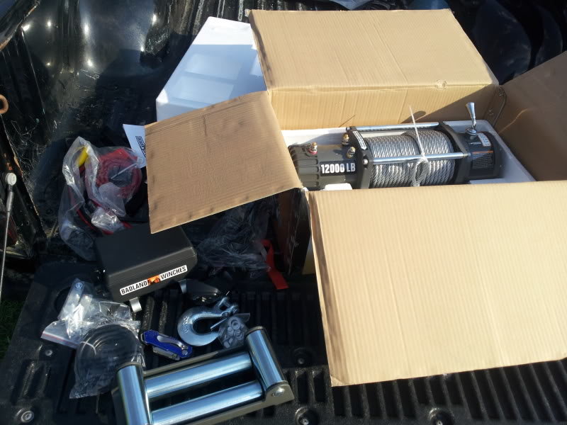

    blacked out the kragen covers and detailed the tank. afterwards i hated the way it looked though. and was able to fully flex it all out
    and got a few new toys
    say what you want about badlands since it's a harbor freight brand. i've had 0 issues whatsoever out of it and i've used it alot. same with the tube notcher.
    i hate the roller fairlead. you should see it now.. all beat and banged up and one roller is missing. thank you rocks!

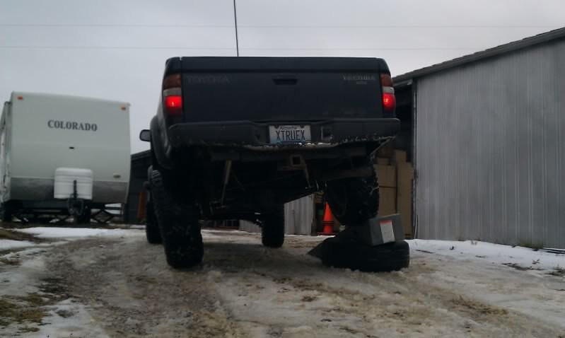

    and made a tire gate. though for now it doesn't swing so it's more a tire carrier.. and changed the design midway through.
    boogerwelds
