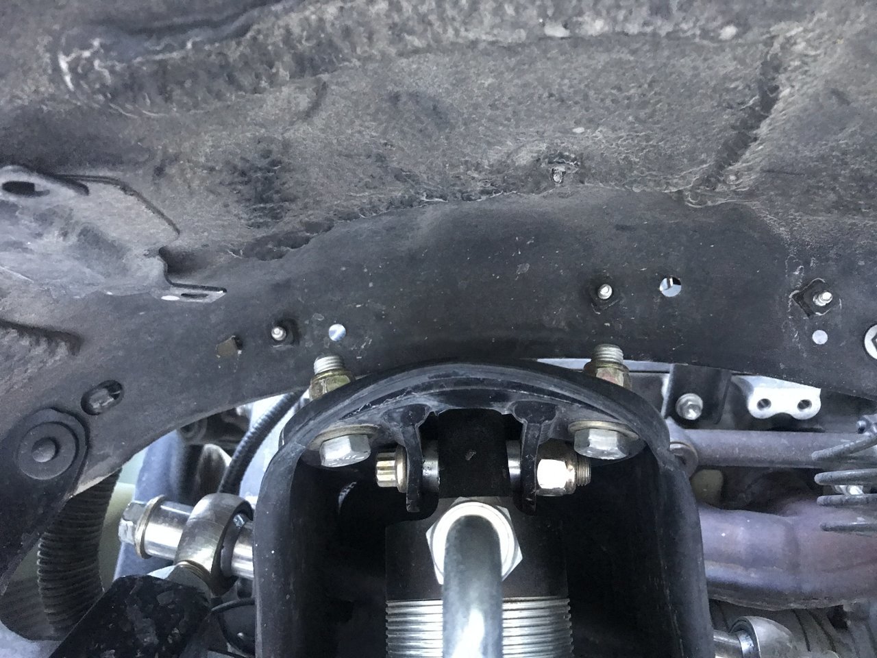

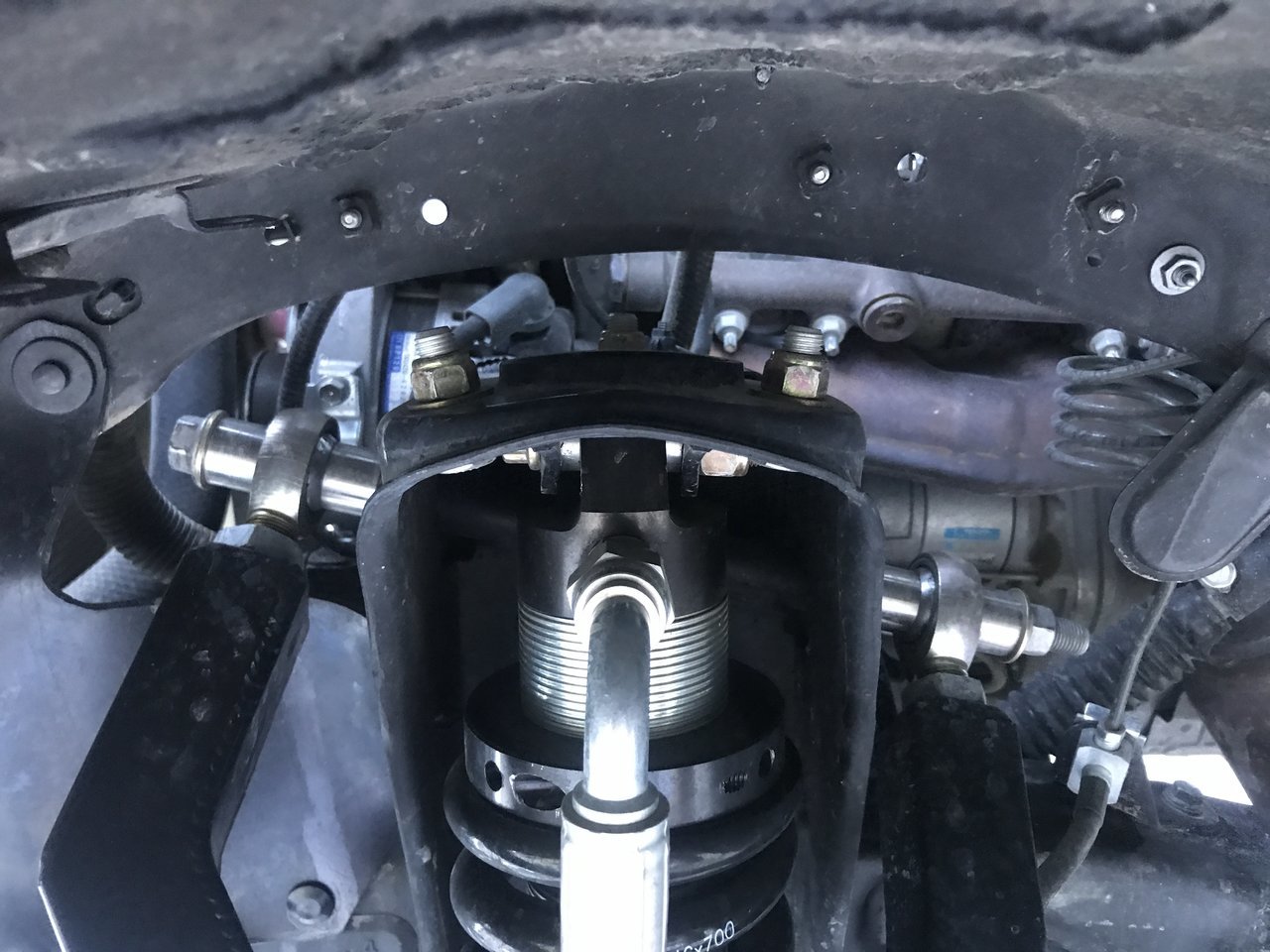

    What have y'all done to reinforce the coil buckets other than the total chaos type of of gussets don't want to spend 100$ when I have the steel

    Whoa, I wonder if that has anything to do with Icons top hat design.

    It does. You can out a toytec lift spacer on the top of the bucket to prevent this with icons. After the fact its kinda f'd

    These are Icons? I have Icons and don't look like that. Those top hats looked flipped to start with so wouldn't blame Icon here

    This looks like user error to me and those coil buckets need to be completely replaced before installing new shocks and gussets

    6 inch Douche Bag lift...what else do I need?
    Looks like a hard bottom out. Are your bump stops working/spaced correctly?

    . Heh only if that would work but I can straight it back up but was looking to see if any one has done something I haven't thought of in the way of reinforcements but yes I did jump it not totally on purpose however I'm running FOA shocks with dirt king LT checked the bumps they hit before zeroing the coil unless the bump deflects a bunch I will shim a bit but thx for quick response

    Make your own secondary mount.
    I did the same thing before, although yours looks really fucked up

    Agreed on this, It looks to me the top hat is already deformed and likely in process of failure. It mind boggles me that for LT Icon has this same design when MT guys have broken the top hats as it is from crawling and stuff. For those who don't know...search "icon top hat failure."

    The lt kit comes with the top hat that you have to install.
    These is clearly an issue of bumps not being proper, no bypass, and off-roading too hard

    If you hit it hard enough you will do the same thing...rubber bumps smash all the way down. A bypass would help a ton
