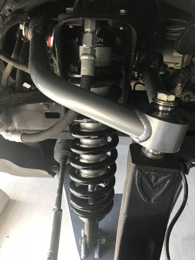

    This is what my icons look like. I need to clearance my coil buckets for the fitting. Are you sure those arent first gen LT coilovers somehow modified to fit a 2nd gen?

    Def get that top spacer to help out with keeping the coil bucket flat on top.

    I actually have some Toytec (not sure if 1/2 or 1/4") top spacers. I guess i just need to find some longer bolts that that thread into the icon top hat.
    Most LT manufactures dont recommend aftermarket bumpstops
