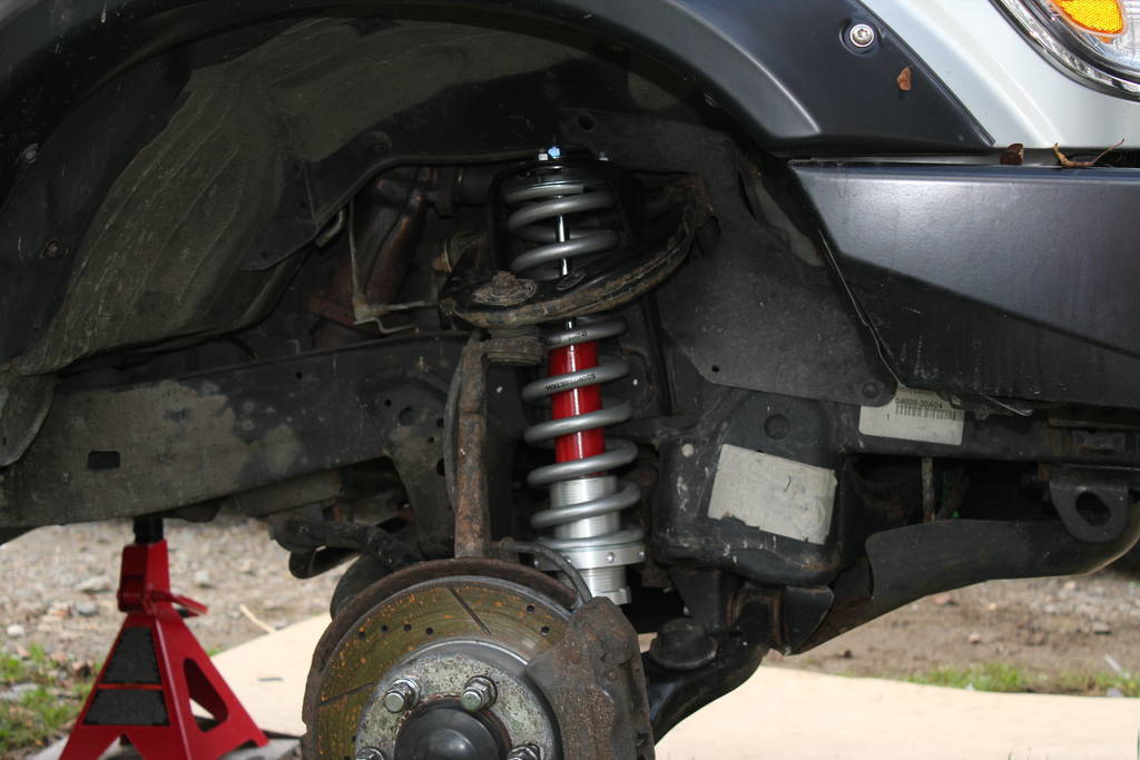

    If you end up with more than 2" lift up front, I'd drop the diff, Revtek has a good kit, $24ish thru Wheelers.
    I am only getting around to it right now, I wish I'd done it sooner.

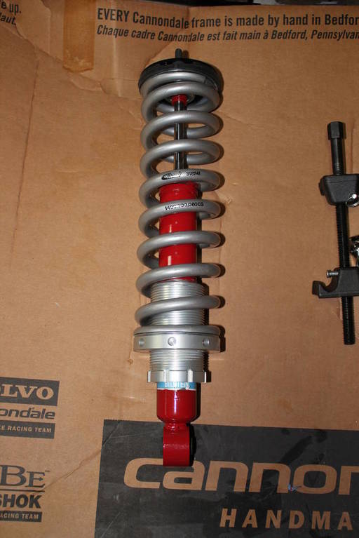

    This is the adjustable kit from Toytec, I ran the original coils set up to the top notch before adding the bumper, then I went with heavier coils.
    620lb Eibachs on 5100's (repainted)
    On truck
    Next to stock
    The heavier coils will be very stiff if you don't have any extra weight up front
