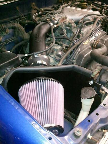

    I'm happy with my K&N CAI, but I'm not sure I gained anything from it, except the knowledge of how to install one. I have seen no difference in MPGs or power, but I don't do any off-roading nor did I dyno it prior to the install. Perhaps I should have dyno'd it before and after.
    It is what it is....and here's mine.
