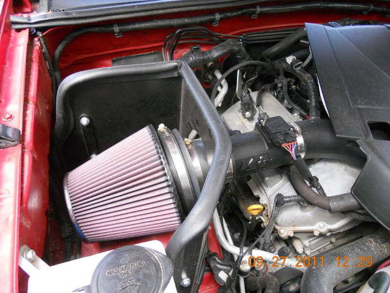

    I like my K&N CAI and it works very well with my supercharged 2.7 4cyl . I've wrapped my CAI tube with a 4" sleeve of thermal heat barrier sleeving from DEI . Also used extra foam material to completely seal all hot air from getting to the filter

    http://www.gadgetonline.com/AirInduction.htm
    Dyno test to back up differant airbox mods. Appears the best one is to remove elbow out of the fender whell. Adds around 6 HP.
    K&N filters actually hurt power over paper type.
