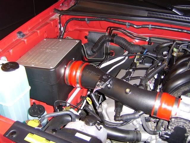

    TRD COLD AIR INTAKE FOR 4.0L V6 TRUCK
    Sale $325.00
    retail $399.00
    The TRD Cold Air Intake features:
    Unique powder coated filter housing w/TRD logo.
    3-angle 5.5” to 4” filter flow adapter.
    4” diameter roto-mold intake tube
    o Transitions to 3” diameter at the throttle body to
    maintain critical flow characteristics at the MAFsensor.
    o Maintains long-term fuel trim within + / - 5%
    Reusable high-flow, low restriction air filter
    Testing done to stringent Toyota standards
    Performance Improvements
    Peak to Peak Power Gain1 Largest Gain2
    Horsepower
    +11.0 HP @ 4,850 RPM Peak +15.0 HP @ 3,150 rpm
    Torque
    +19.0 ft-lb @ 3,600 RPM Peak +25.0 ft-lb @ 3,150 rpm
    1 As tested on 2006MY Tacoma.
    2 Individual performance improvements may vary.
    FJ Cruiser All
    Tacoma 2005 -2006 V6 Engine
    4Runner 2003 – 2006 V6 Engine

    i just got one of those too but mines not in yet i still gotta pay for it my boss is givin it to me for cost though hell yeah. is the picture you posted of your truck? im gonna get the trd cat-back exhaust too shes gonna pur!!!! workin at the dealership is the shit!
