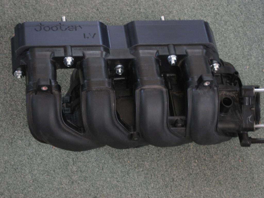

    I'll be doing another dyno sometime next week to test a two inch thick intake manifold spacer that I developed for the Toyota Yaris 1NZ FE 1.5 engine. This is the prototype. I just installed it a couple of days ago so the car needs to be driven for a while for the ECU to relearn the new operating parameters. :)
    With the engine cover on, you can't even tell it's there. ;)

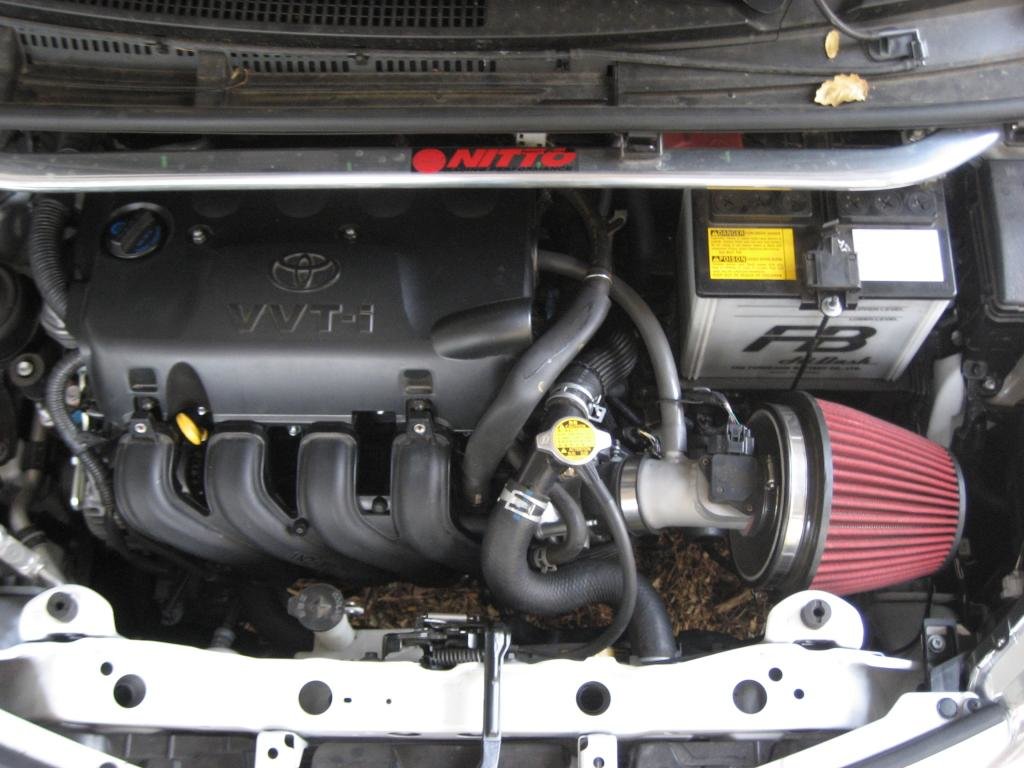

    Since this is intake thread I'll throw it back on topic............K&N intake tube, Volant box with homemade clear lid & aFe dry flow filter. Had the scoop but didn't like the dirt and moisture that had straight path to filter box and it made no difference in performance, so I sold it. Just has the fender air into box. And as countless others have mentioned, this is aesthetic underhood appearance item and a sound maker. MPGwise and HPwise, it is simply placebo.

    That's a clean neat setup. The black intake looks good along with with the black valve cover. :thumbsup:
    I'm also pretty sure my intake doesn't make any power. I just think the sound is really neato. :)
