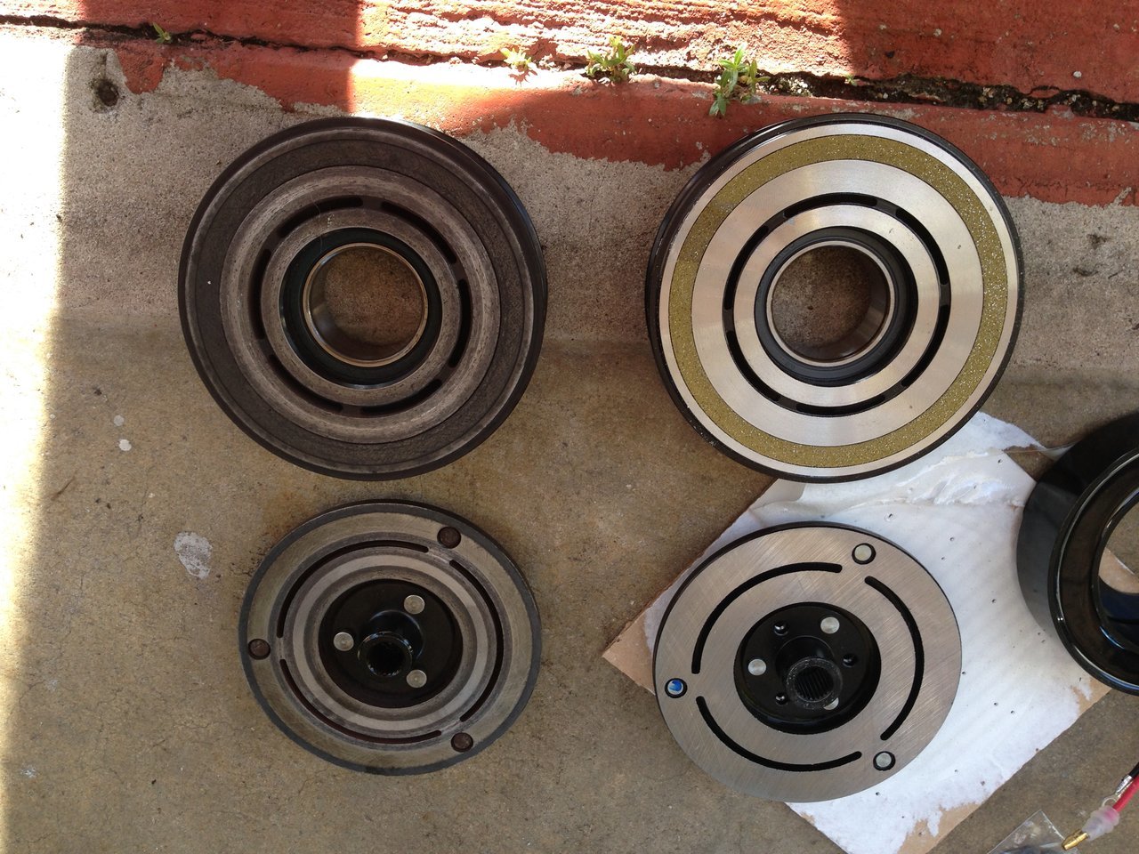

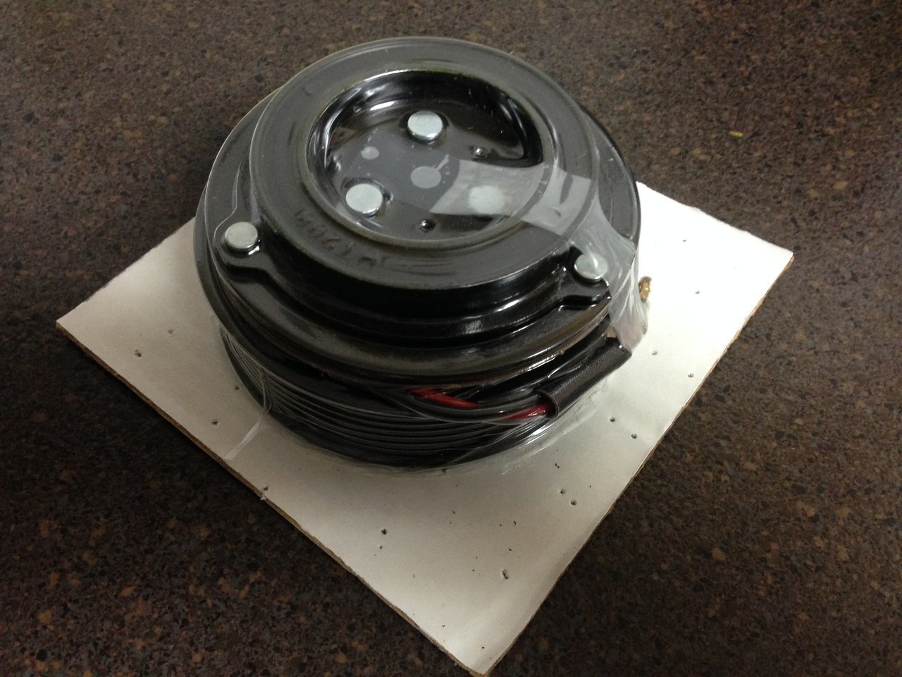

    You can remove the compressor clutch and dress up the mating surfaces. I did this using 60 grit sandpaper just lightly touching up the surfaces. Completely quiet now. Remove the drive belt then use a compressed air tool or else a strap to hold the clutch when removing the 8mm bolt. Snap ring pliers are needed to remove the pulley/bearing unit and coil unit.
    I just ordered a new clutch assembly for later as it seems to take a beating with all the on/off cycles this compressor does.
    BTW, the bearing is staked on the pulley.
    New clutch on, no noise during engagement.
    IMG_0272.jpg new clutch CA-935
    IMG_0274.jpg old and new
