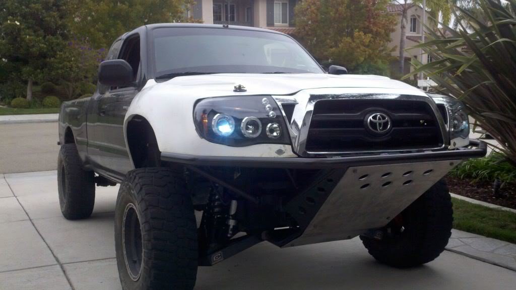

    Hey guys I originally had a build thread over a year ago, Richer Racing had done some stuff for me my senior year of High School then I enlisted into the Marine Corps. Anyway I have been back since late January now that im in the reserves and have recently really been going full kill at the truck again. Here you go guys, ill put picts up of its progress in order untill recent:

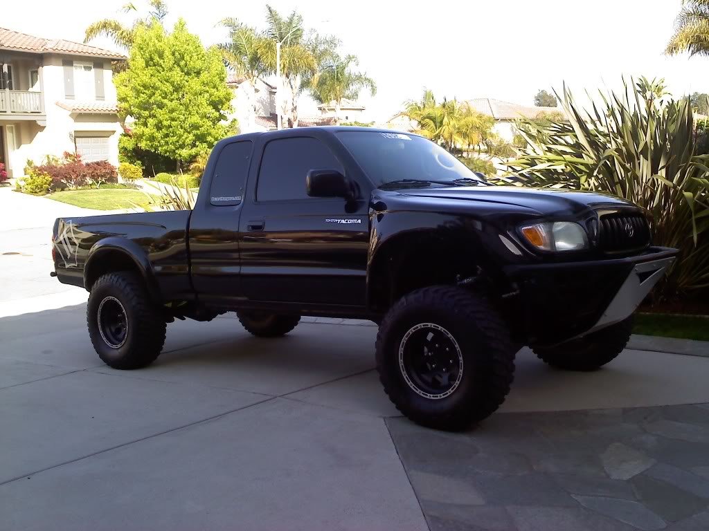

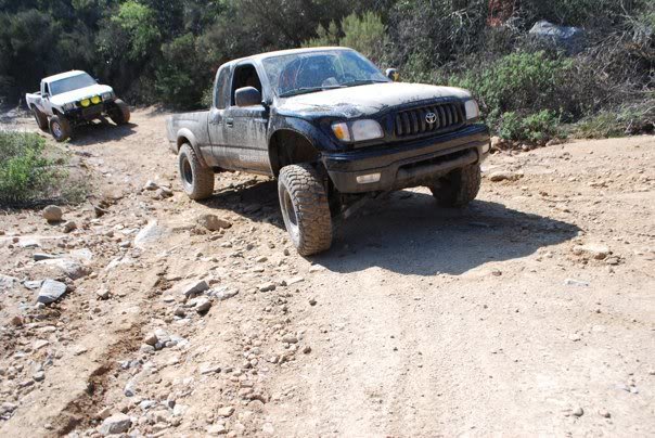

    Here is how it looked when I first got it and in high school:

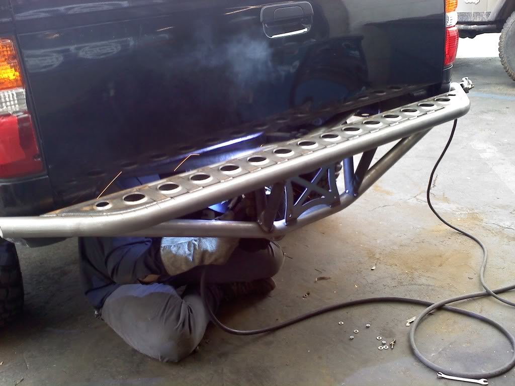

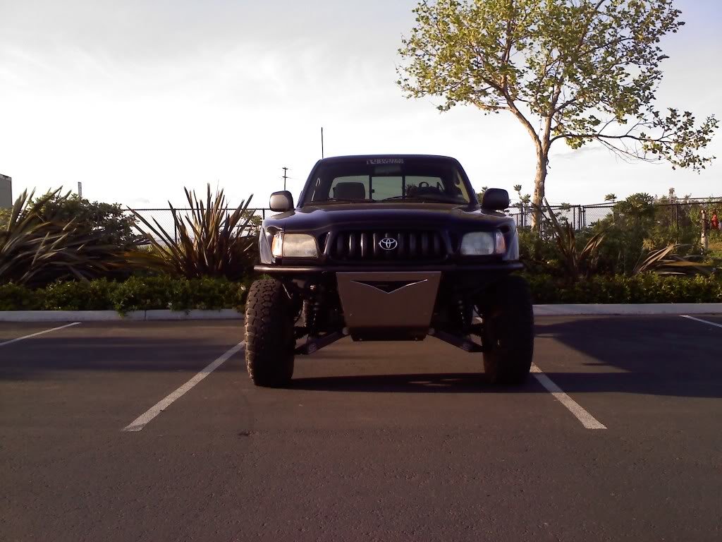

    Richer Racing built my bumper when a girl "got me" at a redlight while she was txting ha:

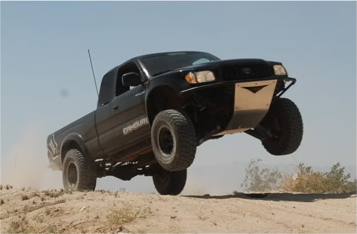

    And Then There was Long travel!!:

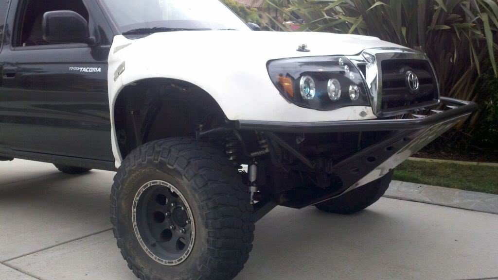

    Fucked my stock bumper so Richer built me one:

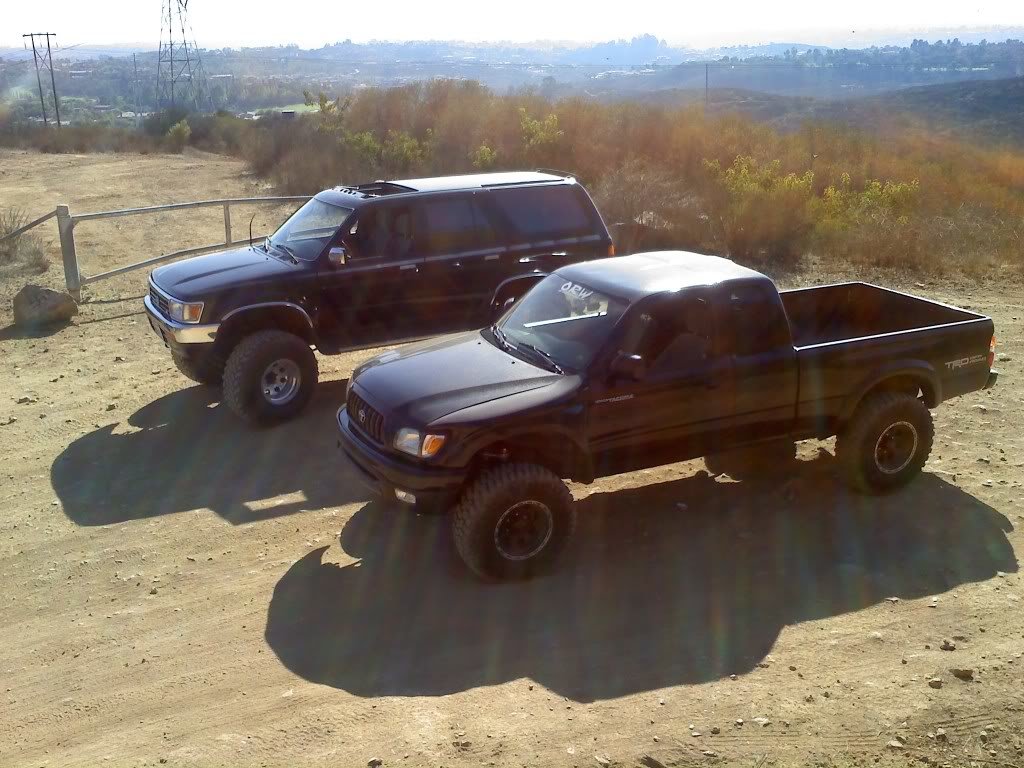

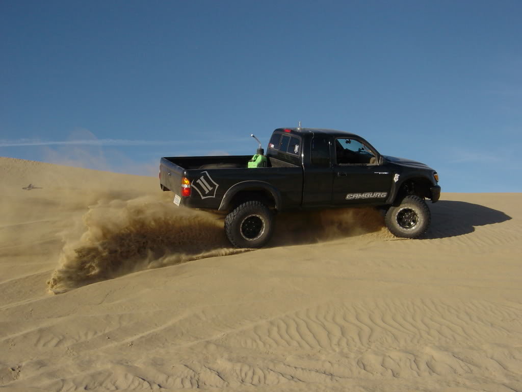

    Fucked around crawling wit TCYOTA and some others local to north-eastern san diego area:
    I went to an MDR race in plaster city and pit with Bro-Dozer motorsports:
    some funnnn

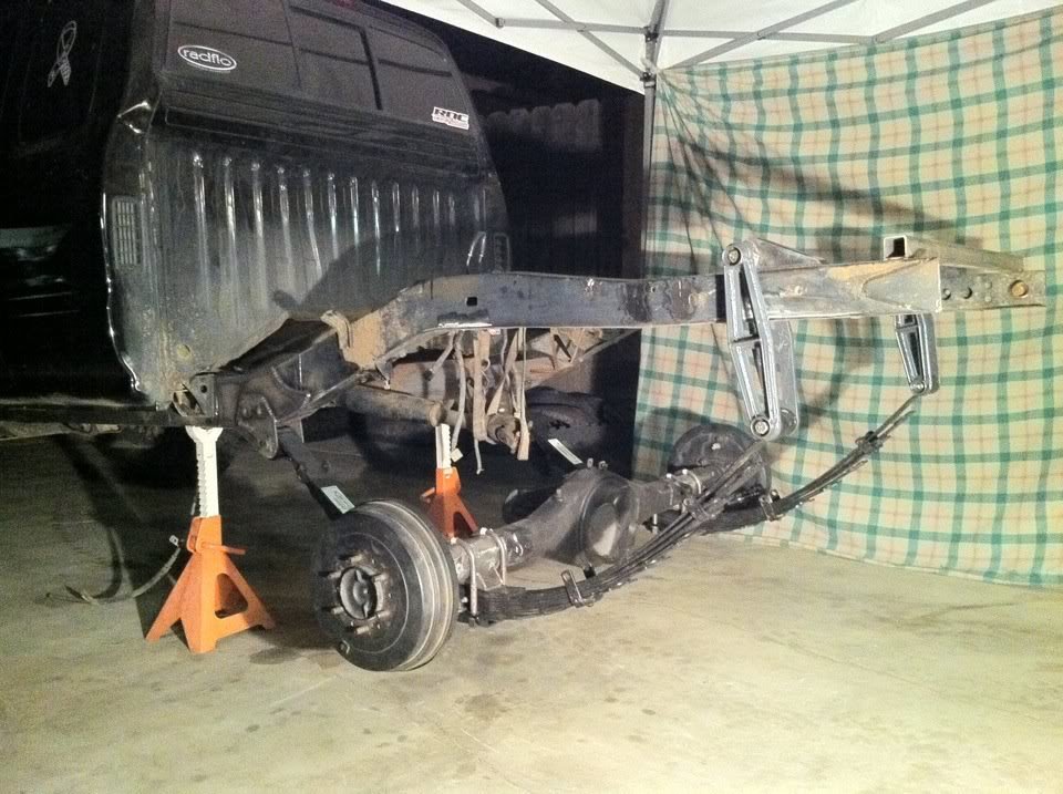

    then i left for marines and went to bootcamp and combat training, while at my school training in north carolina I ordered RadFlo tripples

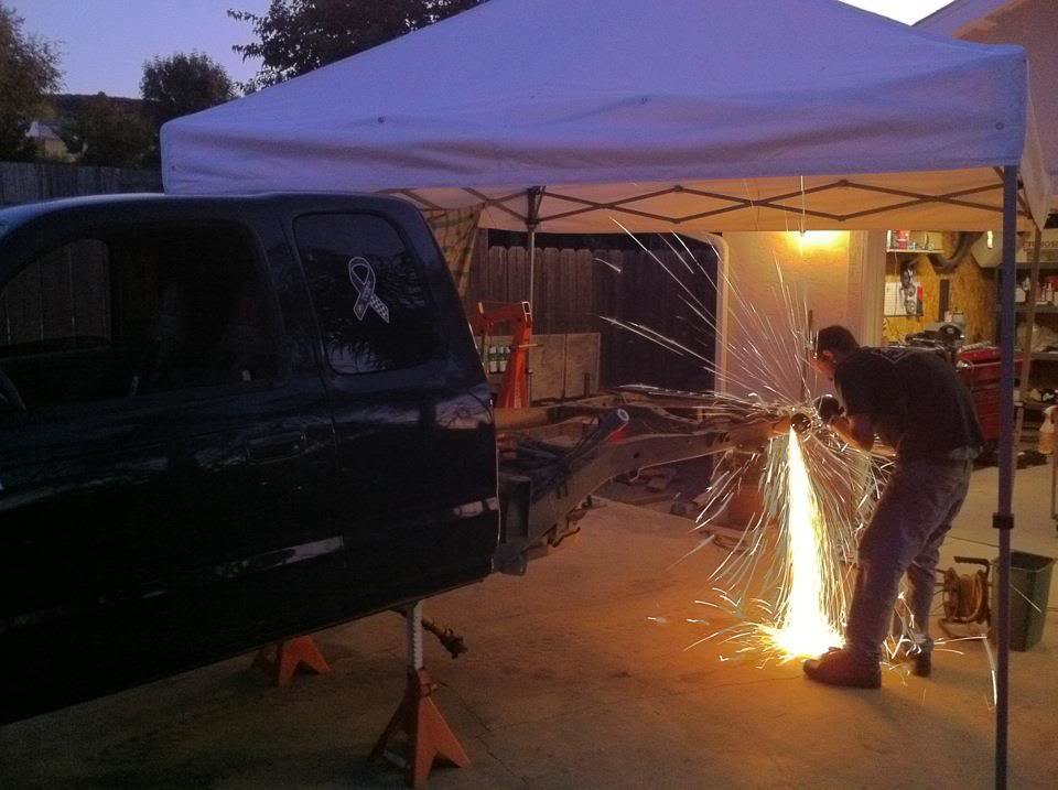

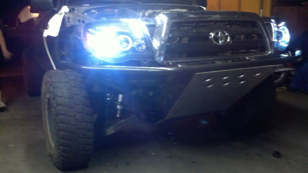

    picked up fiberwerx 2005+ tacoma conversion and grabbed 8" besides, put on HID lights and the fancy shiaatt. Will and Kevin at Janzer Bros Fab have been helping me currently. we made the new front bumper built, radflo bumpstops on , made much larger beefy engine mounts because the stock ones failed miserably. Also put in Beard ultra pro 2 seats with some tubbing in the cab for the harnesses and the sub in there.:

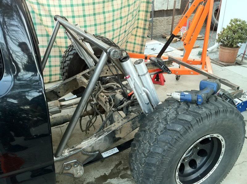

    Also have begun the bedcage, putting the raflo tripples, deaver F67 pack, RR 12" shackles, T100 axle with detroit locker and 4:88's, 2 bfg baja spares and 8" bedsides. Current progress as we just started it at Janzer Bro's Fab:

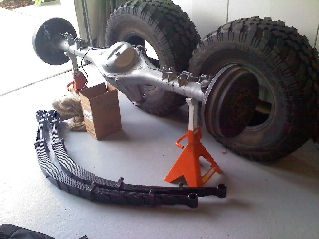

    Leafs cycle a clean 18"s. For the new axle, the fittings for the brake line's did not match up and no one makes a conversion thread fitting for the Tundra axle onto a Tacoma so we changed the fitting to American instead of metric like Toyota and made new hard lines, much easier.

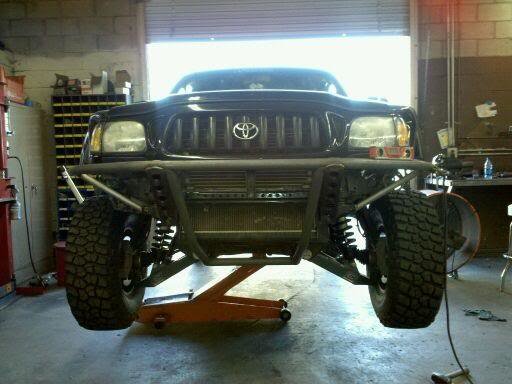

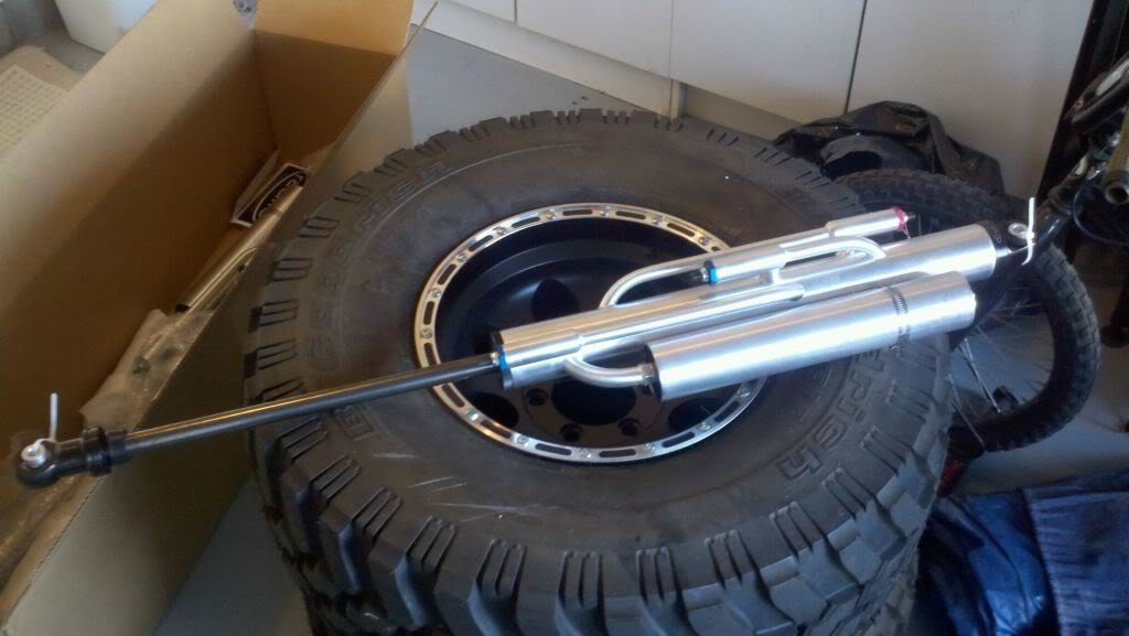

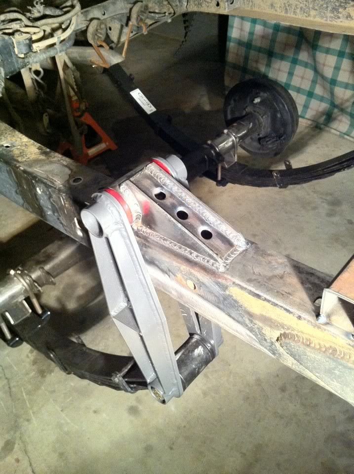

    mounted shocks today:
