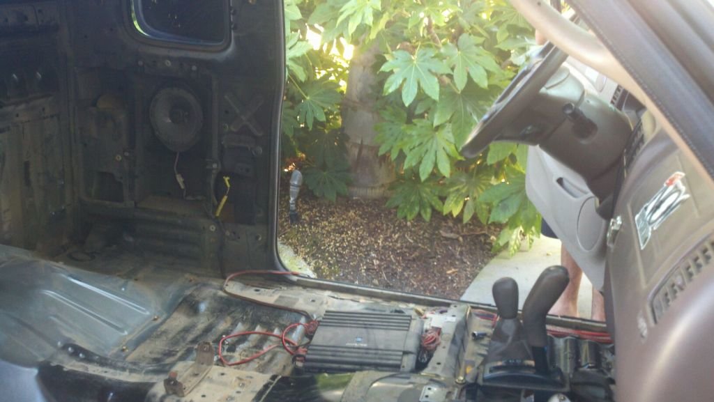

  12. Sep 11, 2012 at 11:41 AM
    #132
    ColesDirtyYota
    ColesDirtyYota [OP] Well-Known Member
    Jan 26, 2010
    #30084
    575
    Cole
    San Diego
    Dezert Built
    Camburg LT Icon 2.5" x 9" coilovers Radflo 2.0" Bumpstops Radflo 2.5" x 16" tripple- Bypasses Deaver F67 Race Pack Richer Racing 12" shackles Full bedcage Full 2" cab cage Tube bumper Solid motor mounts Total Chaos spindle Gussets RR gusseted UCA mounts Total Chaos poly urethane Steering kit T100 axle 4:88's/ Locker AFE dry air intake BA Muffler Trimmed the Throttle Body Fiberwerx 05+ clip Fiberwerx 8" bedsides Full JL speakers/ deck/ sub Rigid Industry 30" LED bar ORW LED amber lights/ brake lights Kenwood Race Radio HF jack with custom skid plat
    We'll I gutted the cab entirely over the weekend, me and Johnny Branch have officially started on the truck. Today the dash will be yanked so it is completely naked haha. Then start on the tubing tomorrow. the only issue's with the cab is the front right cab mount was bent in causing the floor to shear open and the rear of the cab is sagging down bit because the back fire wall cracked along with under the x-cab part at the bottom from all the off-road miles with no cab cage haha. so the body lines dont match up with bedsides right now. so we will need to fix the cab mount and floor and get the rear body mounts matched up again and fill in the cracks. all in all very excited to get this project going again. More picts soon to come:
    BTW i cleaned all the dirt and bullshit out after this pict haha

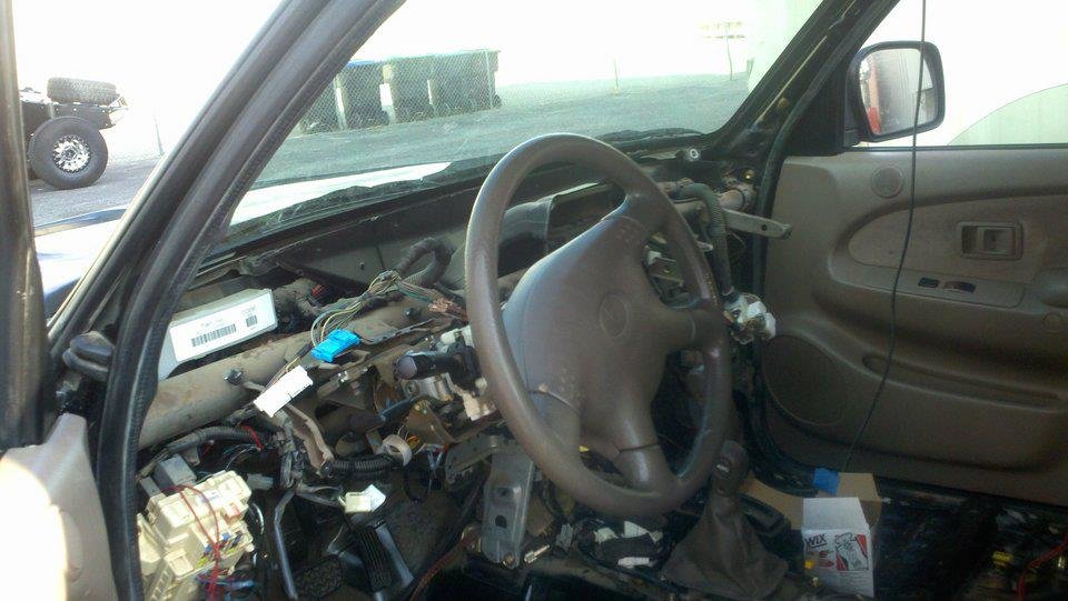

  14. Sep 12, 2012 at 10:14 PM
    #134
    ColesDirtyYota
    Jan 26, 2010
    #30084
    575
    Cole
    San Diego
    Dezert Built
    dash is gone! laying tubes tomorrow

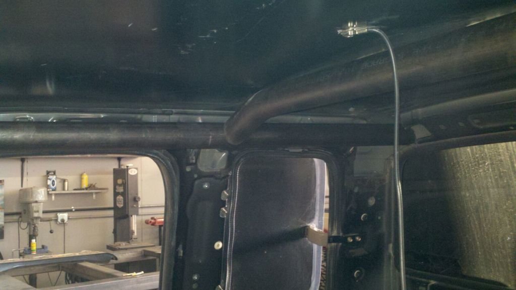

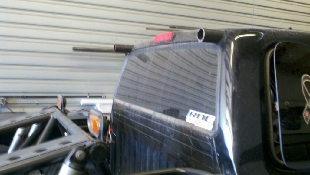

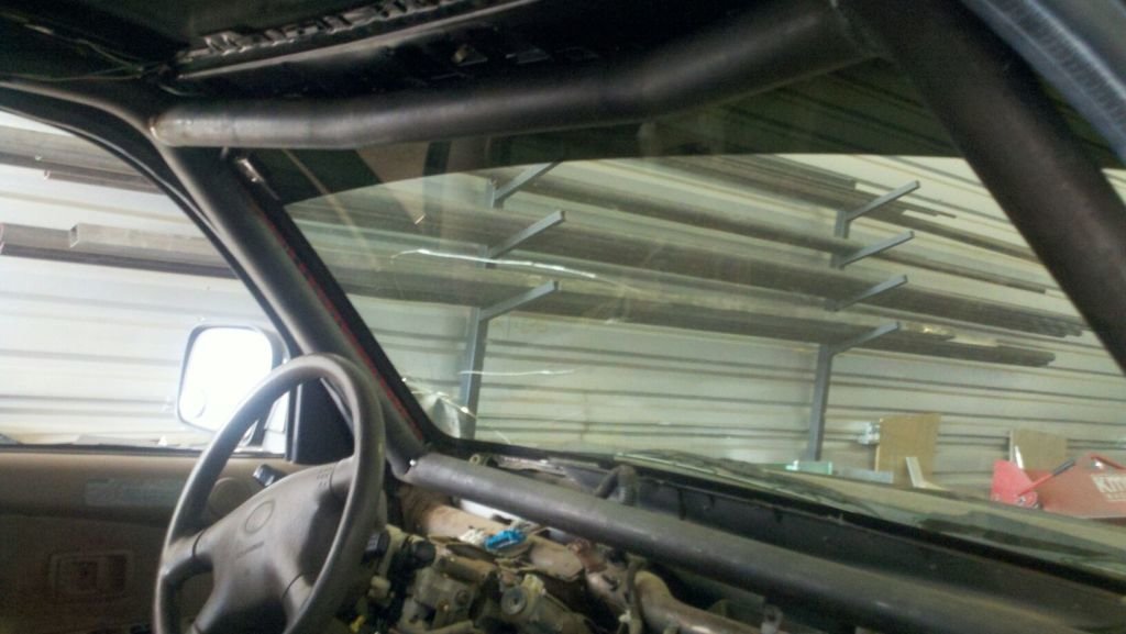

  20. Sep 25, 2012 at 9:13 PM
    #140
    ColesDirtyYota
    Jan 26, 2010
    #30084
    575
    Cole
    San Diego
    Dezert Built
    Well me and Branch got the dash bar in and the tubing now ties up and out the back of the roof, tomorrow he will fill in the x-cab tubing and dash bar to make the top solid, then bring it down and weld the top of the tubbing so its 360 degree welded. from there will put it back up and start to tie it all down threw the floor and into the truck's frame.
