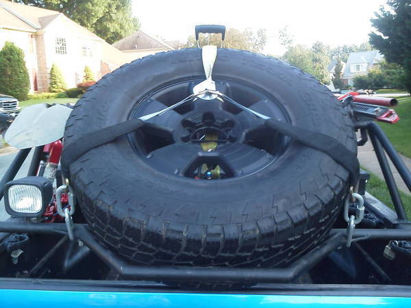

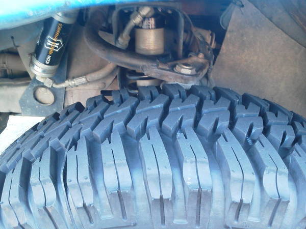

    Tires:
    photo somehow got skewed, but don't worry, the tire down't sit all tildedlike it looks in this one
    and lastly, a huge thank you to John, for hooking me up with a 5th sport alloy. took my best terra grappler as used it as a spare on it. also took my second best tera grappler and tossed it onto the factory steel spare, so i can toss that in the bed for wheeling trips to have 2 spares.
    you're the man, john!

    Appears to be a little more tread depth than the last set :p

    just a tad :rolleyes:
