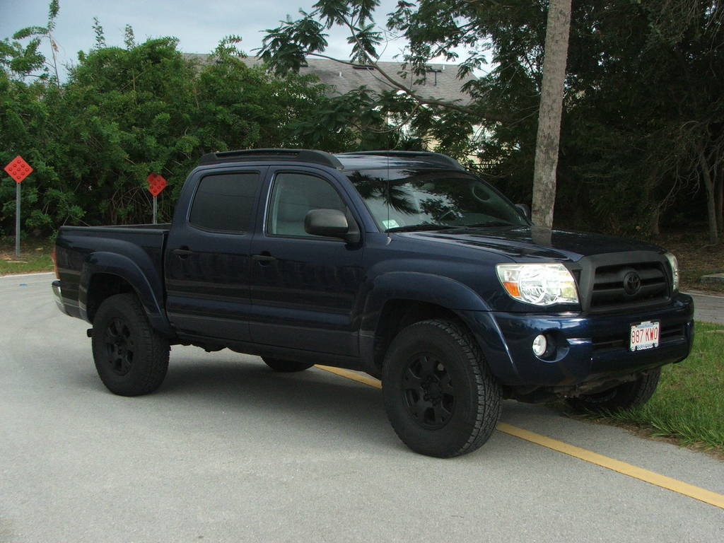

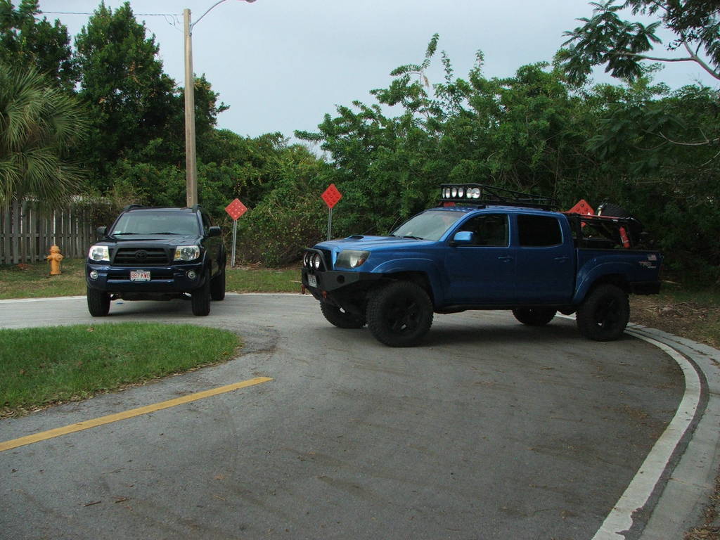

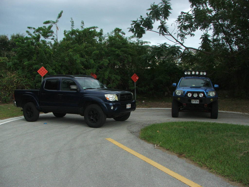

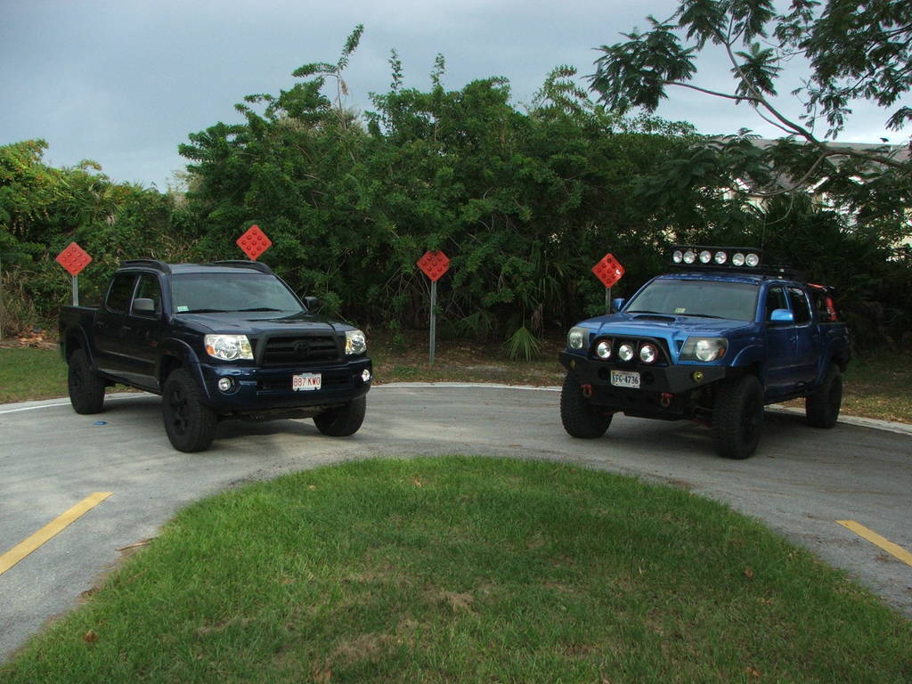

    spent the morning with a buddy painting his wheels. turned out good. he did the grill (used to be chrome) last night. still have to bedline his rear bumper, and black his headlights. he also just ordered lamin-x for his fogs.

    looking good bubb, hows flo rida
