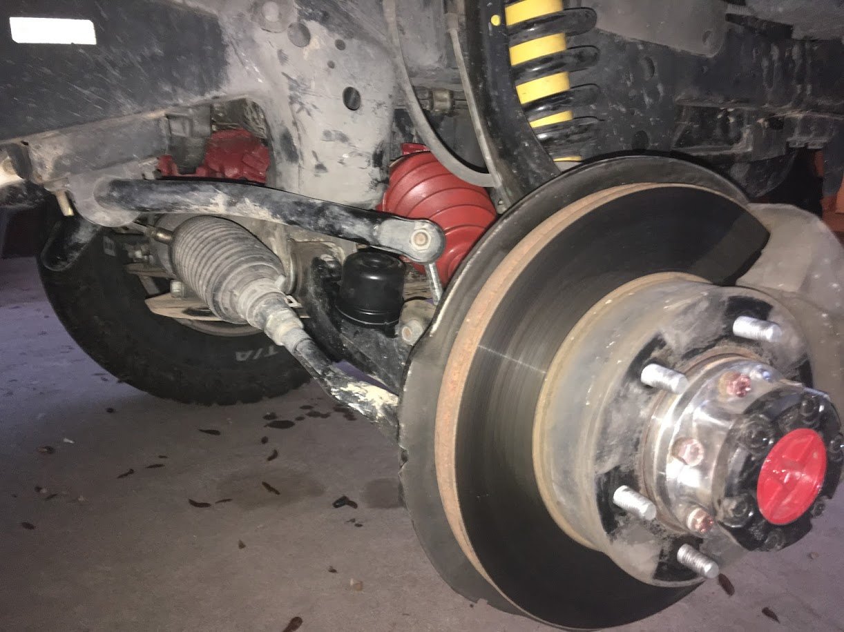

    Front End Vibrations/Noises Solved
    Solved all of my problems on the front end. Rolling with OEM lower ball joints now. My rotor on the driver side was warped when I bought the truck and I couldn't get it off for the conversion without hitting it pretty hard. Apparently I hit it pretty hard and it was causing the vibrations as it contacted every rotation on jagged edges that had been dug into the surface. Either way new LBJs and a new rotor solved my issues.
    Durobumps installed on LCAs
    Installed these front bump stops today. My second purchase from @Plastics Guy after my front diff bushings. Testing them out tomorrow off-road but they sure make the potholes around town nicer. I'd recommend them to anyone even if you just daily your vehicle.

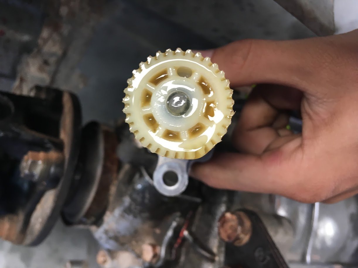

    Speedometer is 99.9% accurate.
    After the conversion I installed a cheap Chinese speed sensor into my plugged transfer case VSS hole. The gear included with it had 33 teeth. I determined this was too many and ordered two other gears. A 30 (#33403-39365) and a 31 (#33403-39345) tooth gear. The 30 tooth gear was almost perfect and is less than 1 mph off.
    Here is a small list of tire size, gearing, and gear count accuracy I've gathered from @turbodb and myself.
    • ~0% error 255/85 R16 BFG KM2 tires + 4.10 gear ratio + 30-tooth speedometer gear (#33403-39365)
    • ~1% error 265/75 R16 BFG KO2 tires + 4.10 gear ratio + 30-tooth speedometer gear (#33403-39365)
    • ~6% error 255/85 R16 Cooper ST Maxx tires + 4.88 gear ratio + 33-tooth speedometer gear (#33403-39415)
    I also took the time to add some high temp wire looming to my exposed extended VSS wiring harness. It was just bare wire sitting against a hot transmission. Didn't get a picture but it looks a lot nicer and I'm not worried about the wires anymore.

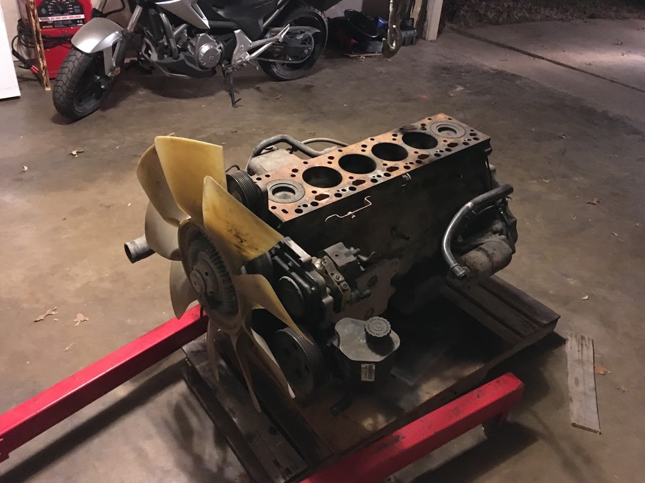

    Really need to get this thread updated and get some posts edited with more pictures/descriptions. But I somehow ended up with a 03 3500 5.9 Cummins project and a significant decrease in free time this semester.

    @04Pre_Runner WOW, what an badass build. You got more balls than I do. I just bought a 03 limited crew cab back in 2010. Really love the truck, and it looks exactly like yours. Educate an old man, too many acronyms. FPIG is some kind of gasket sealer? Also how does it ride with the OME suspension, and did you purchase everything as a kit. I'm looking at one to upgrade my suspension, and was wondering how it rides with the 882 coil springs you chose. I just finished reading the entire build, and you should be very proud of yourself. Not many of us would venture into something like this. A lot of hard work and sweat, and let's not forget $$$. If you don't mind my asking, what did this build run you dollar wise.

    Thanks. It was definitely quite the task to take on with the experience I had at the time. I had to harass a couple guys on this forum for details and explanations but everyone was extremely helpful when they realized I was serious. Before I could start the conversion I ended up doing a bunch of smaller projects on other vehicles that prepared me a bit better.
    I'd wanted a double cab first gen since I was a kid and I had to compromise on it not being 4x4. When I realized a conversion could be done for less than selling my truck and buying a 4x4 I was 100% on doing the conversion. Yeah FIPG is just formed-in-place gasket maker. The OME suspension has been pretty solid for me and I bought it from Wheeler's Off-Road in a kit with leaf springs and shocks/coils. I wouldn't recommend the 882 coils if you aren't going to be adding significant weight to the front end of the truck. My truck rides pretty stiff right now with just my bumper. I also bent my rear passenger shock off-roading when my leaf spring slammed into it. From what I have gathered any aftermarket shock would have done that and a relocation of the passenger side rear shock mount fixes the problem.
    As for the dollar amount for the 4WD conversion I don't think I addressed that very well as my build log is really unorganized right now. I started the build off buying that 4Runner for $400. Then spent a bit over $1500 total by the end of it. I don't have a specific amount but might gather the receipts and emails up to get the number. After selling the 4Runner for scrap and a ton of other parts being sold I've made a lot back. Cost for suspension was around $1600 after I did tubular upper control arms from SPC.
