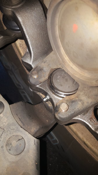

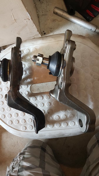

    Did my ball joints last weekend along with tundra brake upgrade. I went OEM with ball joints it came with the 4 fasteners, castle nut and cotter pin require for install, I recommend getting an additional cotter pin for the tie rod castle nut.
    Just a heads up OEM set me back about $400
    add locktite to the 4 fasteners
    Used a pitman to free the ball joints just have to turn your wheel to get the pitman in postion.
    My set up didn’t have the ball joint protector shield is that a thing for 01-04 or is it standard for all years?

    It seems to be a later year thing.
    And with the spacers in that shield/skirting they take 2 of 4 bolts that's a little bit longer on one end of it. 2 bolts each side. So a 'kit' would 4 one length and 4 a little longer for that spacer built into the shield thingy.
