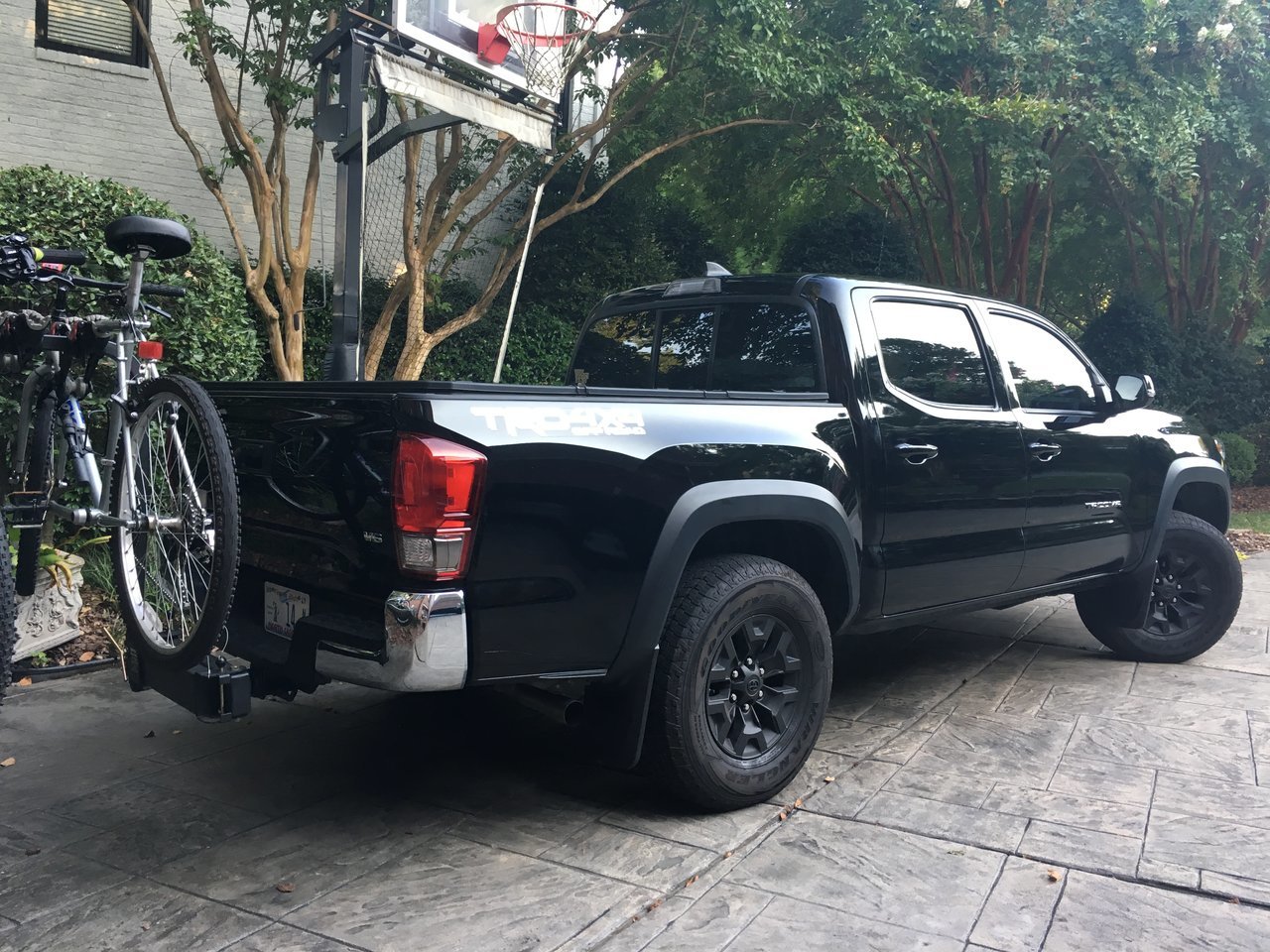

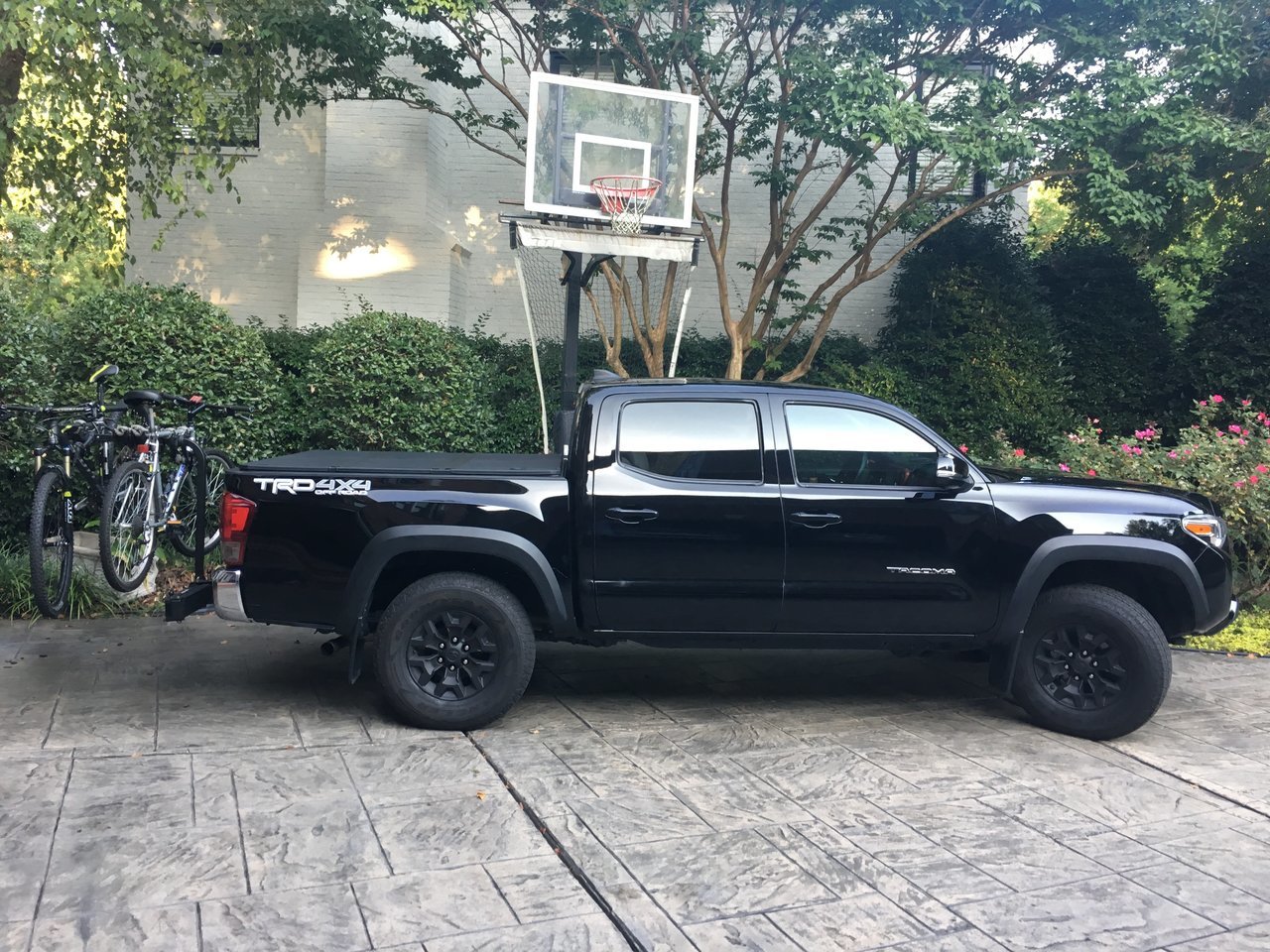

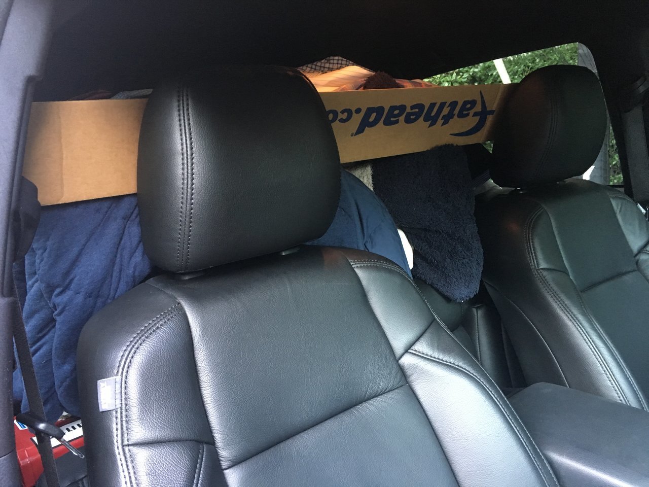

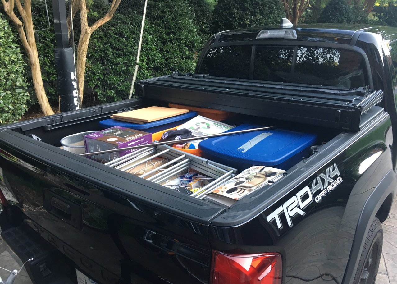

    Im squatting heavy right now. Maybe a good excuse to upgrade lol. A whole semesters worth of clothing, books, bikes:), and Clorox wipes etc. is really testing it. Tonneau is packed tightly too!!

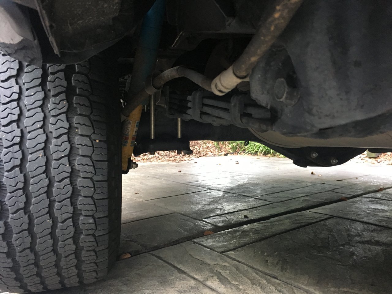

    Yeah about par for a stock Taco. Strictly designed for surfboards and a couple of bikes. Haha. They really improve with a better suspension. You need about $3000 worth.

    how much payload weight do you think you are hauling.

    See with the bikes its harder to tell. The Bike carrier doesnt help the squat much because it just adds tongue weight and its so heavy. In total, probably 100lbs on the hitch, at least 250lb in the bed, 150 in the second row maybe.

    so about 500 lbs plus one human driver estimated around 150lbs. you have are around 625-700lbs total payload of an available 1175lbs max payload capacity for a DCSB 4x4 Auto.

    I'm old enough to let my son pack his own car for grad school and load and unload it lol. The squat in the back is what it's designed to do. I've had right at a thousand lbs in the back and it leveled out nicely. Headlights are aimed better with a load too! If you or I hauled that load daily I'd say upgrade. If you are like me and only haul a heavy load several times a year then it's not worth losing the softer ride when empty.
