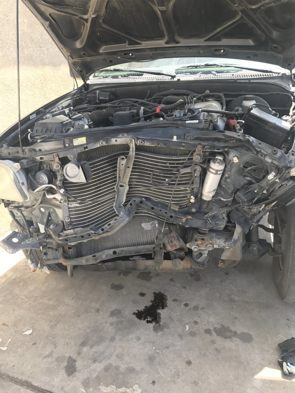

    I brought my 2.7 tacoma back to life IMG_0274.jpgIMG_0278.jpg IMG_2348.jpg IMG_0387.jpg

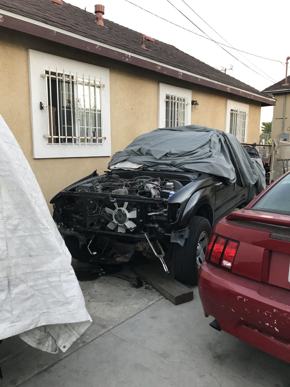

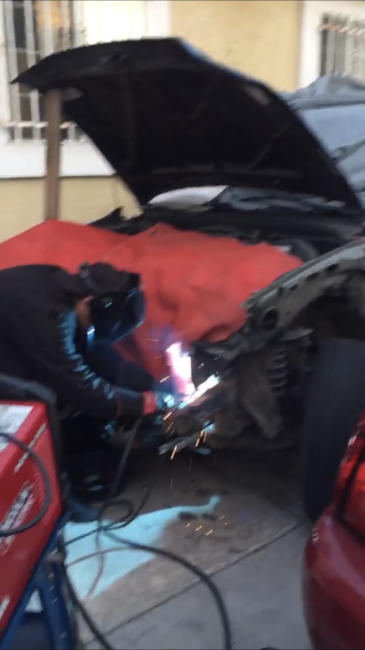

    first I took it apart radiator support was trash so I scraped it ac condenser and radiator was trashed fan blades was broken fender and hood was scraped I had to heat up the chassis where it holds the bumper suport with a torch in order to bend it back in place and welded it and reinforce then I installed a new radiator support got new ac condenser and radiator and slide it in I had to bend apart of the frame back in place welded the radiator support and purchased new fender hood grill lights the whole front end is basically new and then I took it to my boy and got a fresh paint job done on the whole truck
