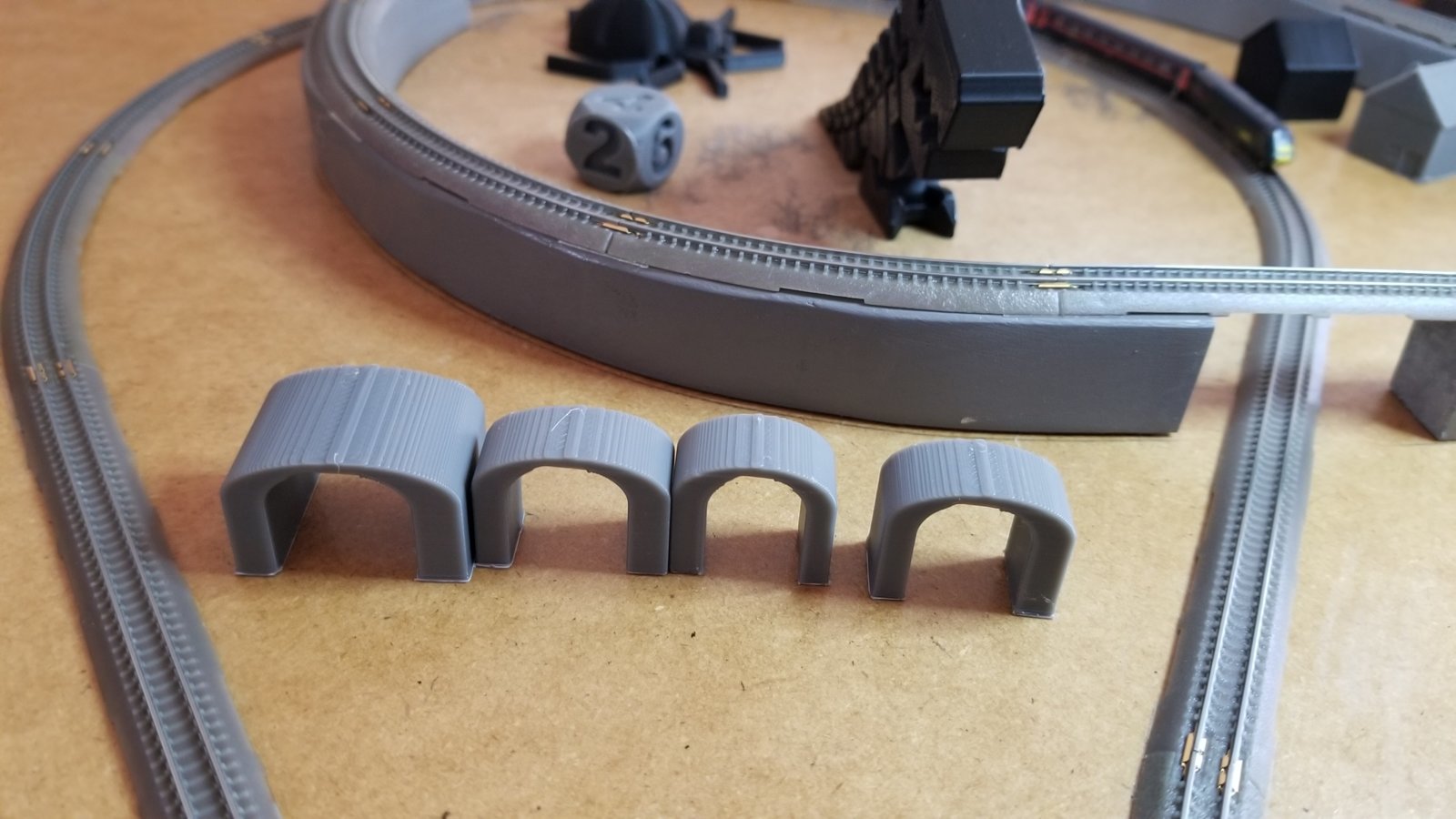

    Changing gears to a lighter subject.
    One does not simply reduce size of a thing, the other things don't change along with it.
    Tunnel prototypes, and an exercise in shaping shit.
    The farthest one back, 1st attempt, too wide.
    next attempt, using actual measurements, the center did not shrink as much as the outside.
    The vertical section also shrinks, changing the inner dimension.
    3rd attempt, so close, dropped by 4mm from the 2nd. 4th and closet piece, increased by 2mm and it's perfect. From here I can lengthen as needed. Still can't figure out curves or radius yet.
    And got the dice project figured out. Again, first was an oops as it's not uniform, kind of fat and flat. 2nd one worked out when I paid better attention to dimensions and unchecked a box.
    Opposing sides do add up to 7.
