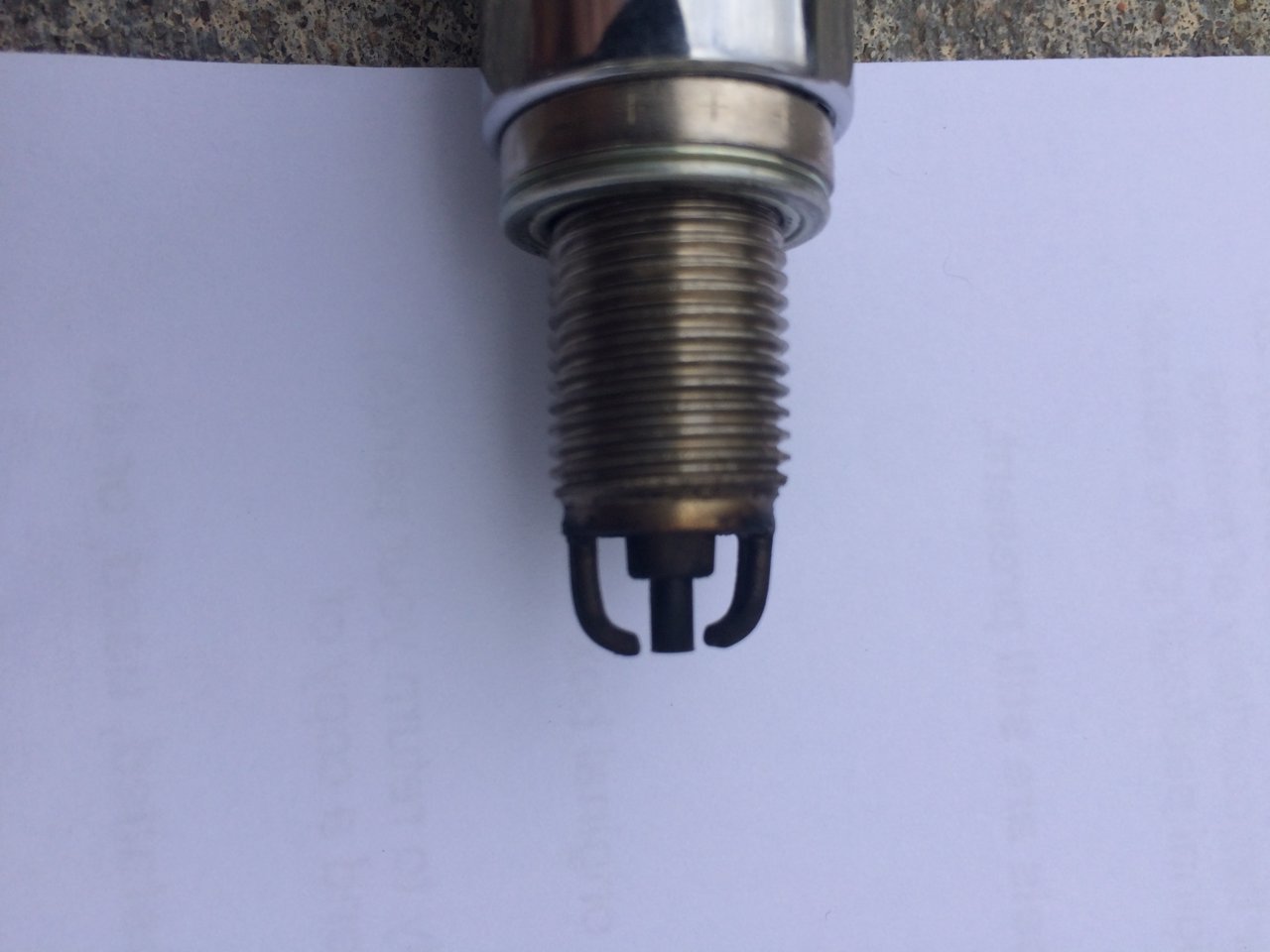

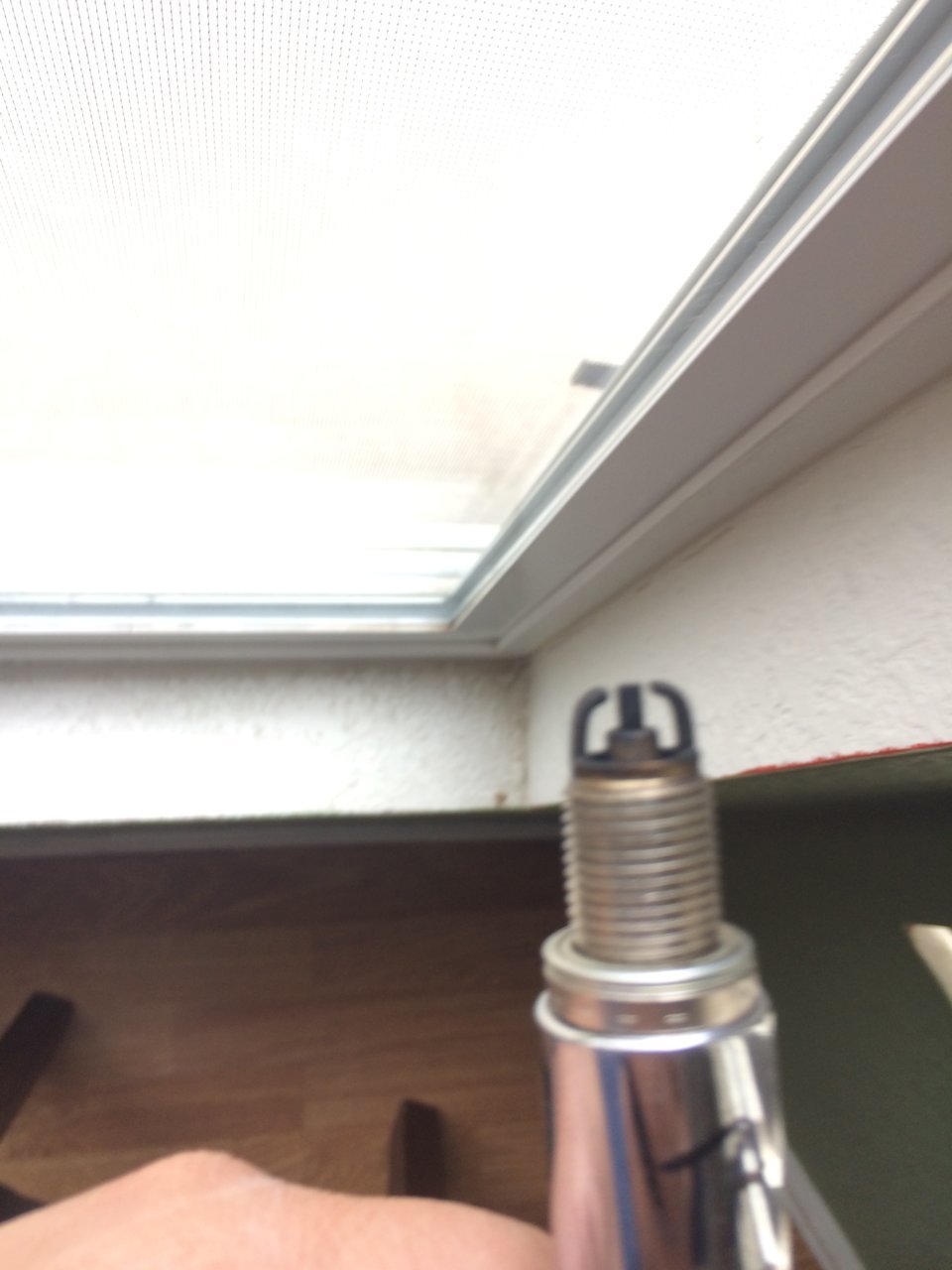

    With a new coil packs and ignition module from a junk yard. New wires and compression test. I still have a #4 misfire. #4 spark plug has excess carbon on it. Not sure if that was caused from the bad coil pack. Compression was done with a cold motor. The #4 cylinder held pressure for 5mins without dropping.

    Something valve train?

    Shouldn’t be if it’s holding pressure.

    Generally a black, carbon fouled plug indicates excessive fueling. Didn't you have your injectors rebuilt recently?

    Or incomplete combustion?
