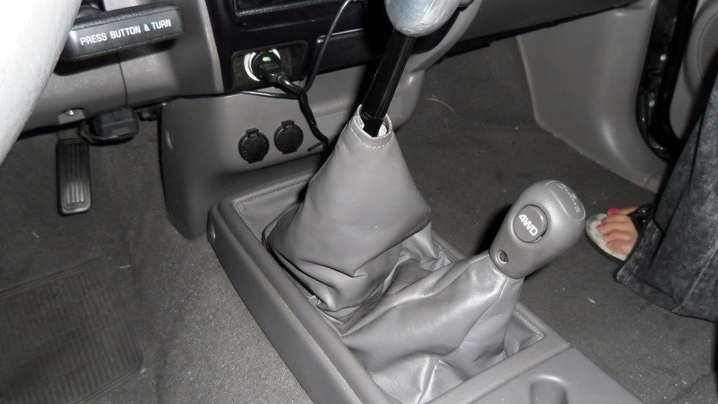

    Gray wire mod is to enable the rear e-Locker anytime on the 4x4, like the Prerunner.
    Blue plug is the 2-low on the 2-4 select transfer case 01-04's. You're lucky and just easily twin-stick it.
    "2-4 Select Switch":

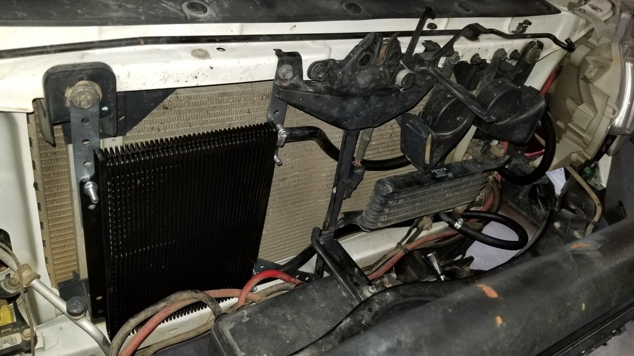

    who's cooling kit did you install and how much extra fluid added? looked pretty simple to install and no doubt a good insurance measure. Pinned tstat all the time? No reason not to ?

    Interesting, doesn't look that difficult to do either.

    Here's the link that sent me down that road...
    https://www.tacomaworld.com/threads/transmission-coolers.526283/
    I'd imagine there's a lot of crossover between 2nd and 3rd gens. Install was really easy and cost was minimal.
    It's a good time to also change out the fluid. Here's a good link about that process.
    https://www.tacomaworld.com/threads/diy-full-flush-for-automatic-transmission.68462/

    thanks for the information. I was planning to do the drain and fill (dealer did the top-off of 3/4 qt when it came low from factory) method too and compensate for additional volume of cooler by pre-install method of fill/drain/measure. ?? Or may see if @thefatkid has any free time to do because I can see a potential trans fluid mess in my future!

    I'm pretty sure you have the proper tools. Did you check out the link I posted?
    Let the truck pump out the old and a sprayer bottle pump in the new
