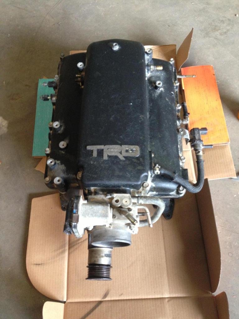

    Supercharger next? That would be cool.

    Man I wish!. TRD discontinued the Supercharger for the 2uz early on. So they are pretty rare in a complete kit. The SC is pretty common, but its the small stuff that is hard to find. IE- The belt tensioner, some of the brackets, TRD ECU and such, But when you do find it people want a mint for the stuff... Plus the uz motor family (except the early 1uz) have really narrow rod that supposedly don't like boost... Plus I don't know if there is much support for the tuning end..

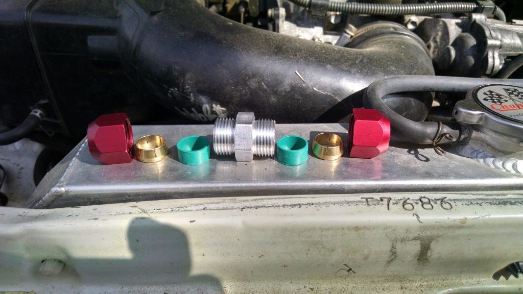

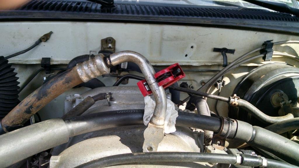

    Well, here we are, the end of summer, and I have what I think might be a simple solution to my AC line whoas...
    I found these A/C line splice kits on Amazon for $20-25. They are basically compression fittings. I am mating the stock low pressure Tacoma lines to the Tundra low pressure lines. leaving the fitting on the fire wall is the stock Tacoma hose. It now makes a U-turn and runs to the fire wall where the fitting connects it to the Tundra hose. This hose then runs to the A/C compressor. The other hose I am splicing is the hose running from the condenser to the compressor. Again, the stock Tacoma line will be spliced to the Tundra line.
    I have faith that these fitting will work just fine, with one exception. The Tacoma line leaving the fire wall is (I think) a 9/16 line (maybe 14mm). The Tundra line it needs to connect to is a 5/8 line. I can not find these fittings in mismatched sizes. After some trial and error and multiple returns, I think I have it figured out. I was able to get the 5/8 fitting to tighten down on the smaller Tacoma line. I have ordered the 1/2" fitting for the lower lines. I am also going to replace the receiver dryer since it has been exposed for the last year.
    I am a little worried about how the sharp upward turn will effect the AC performance. However, these lines are low pressure, and thus the refrigerant should be in a gas form. We shall see.....
    Anyway, here are some pictures of what the upper line looks like.
    Cutting the ends off.
    The fitting laid out.
    Finished product.

    I got my AC working. The fitting didn't work, so I found a local hose shop and they made lines for me.

    There is an aththentic TRD blower for a 2uz on ttora

    I know.. I saw it right after it was posted... I want it, but don't have the extra funds.

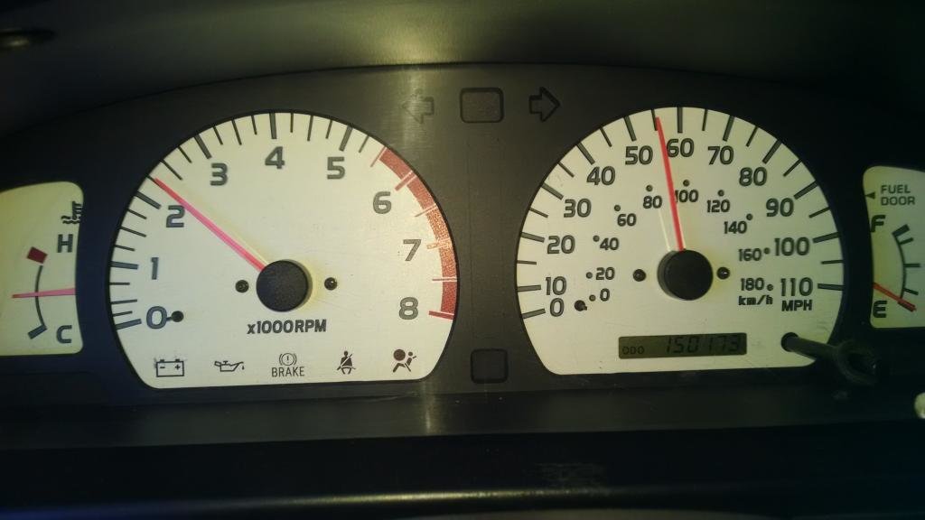

    Why would he get banned?
    Thanks for the vid :)
    If you notice, the fuel gauge goes up then back down as he stops accelerating..

    Thanks for posting! For whatever reason my gauge always moves around like that when its low. I assume all the fuel is being shifted away from the float, thus the low reading.

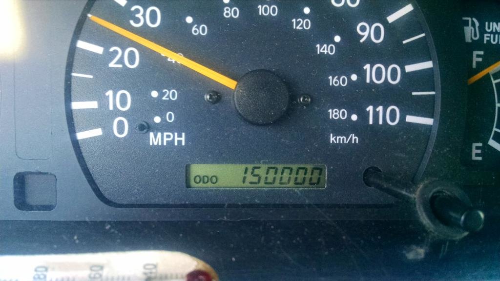

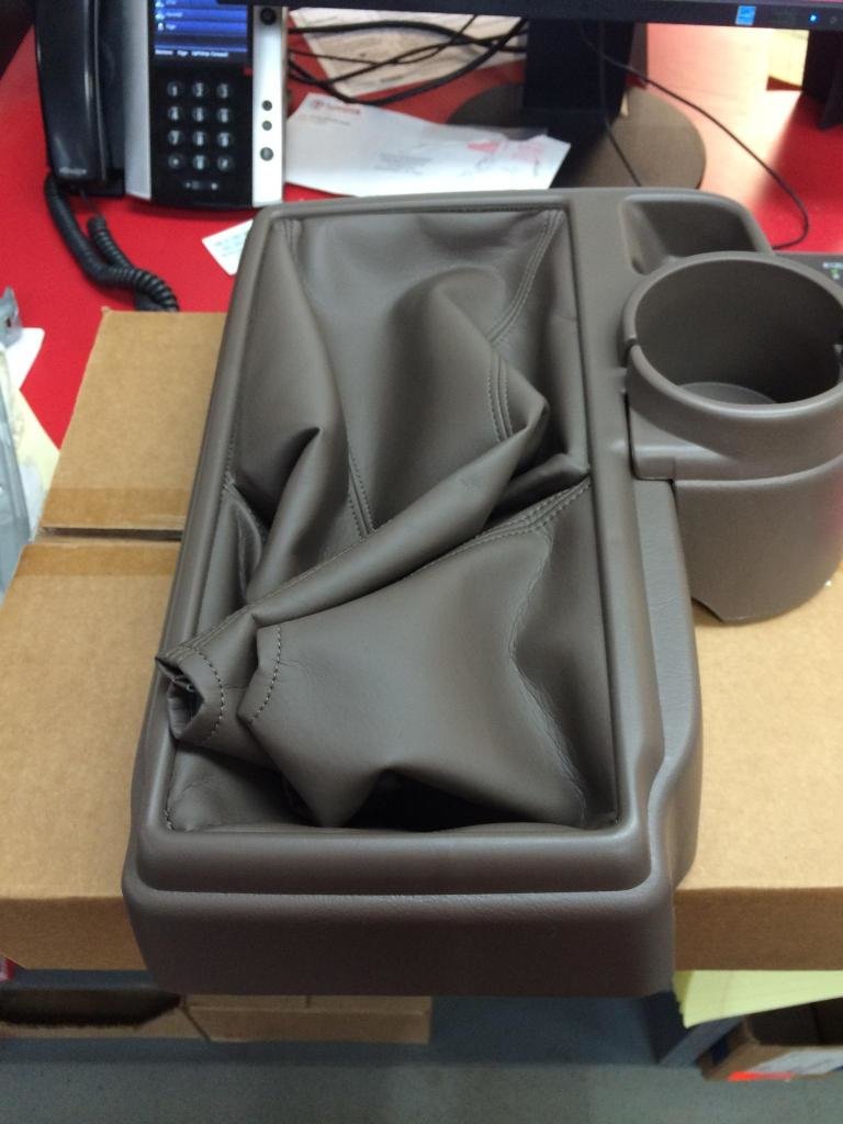

    My truck crossed over 150K the other week, SOOO... I bought my girl some stuff.
    Its now sporting a 01-04 Center console, a brand new from Toyota shifter console w/ cup holders, a radio from an 01-04 Tacoma, and matching white face gauges, and I tossed my crappy stock horns for.. you guessed it.. 01-04 Tacoma horns..
