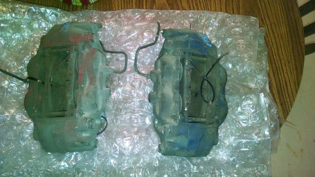

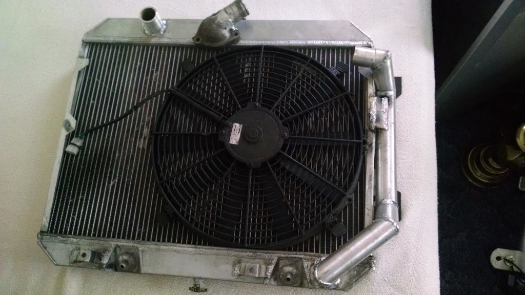

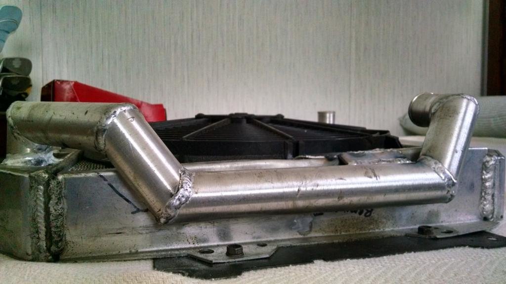

    A few more goodies for the truck. (The SC is still on the shelf waiting for me to track down a few more parts.)
    Ive struggled with the lower radiator hose since the beginning. I have had multiple hoses spliced together and they have all leaked.... Im hoping the will solve my problems....

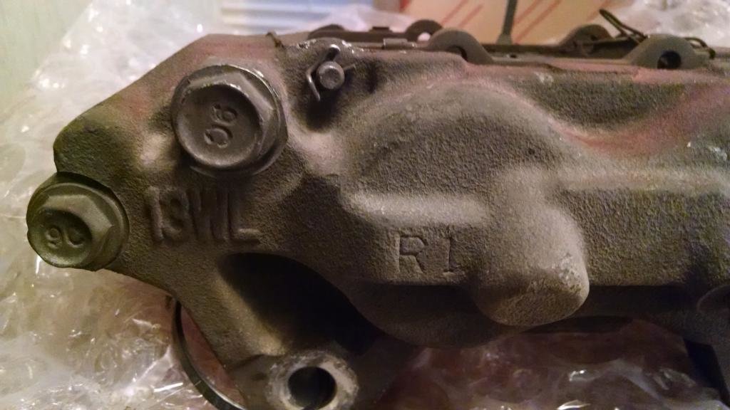

    Also picked up a set of Tundra 13WL calipers. I still need pads and rotors though...
