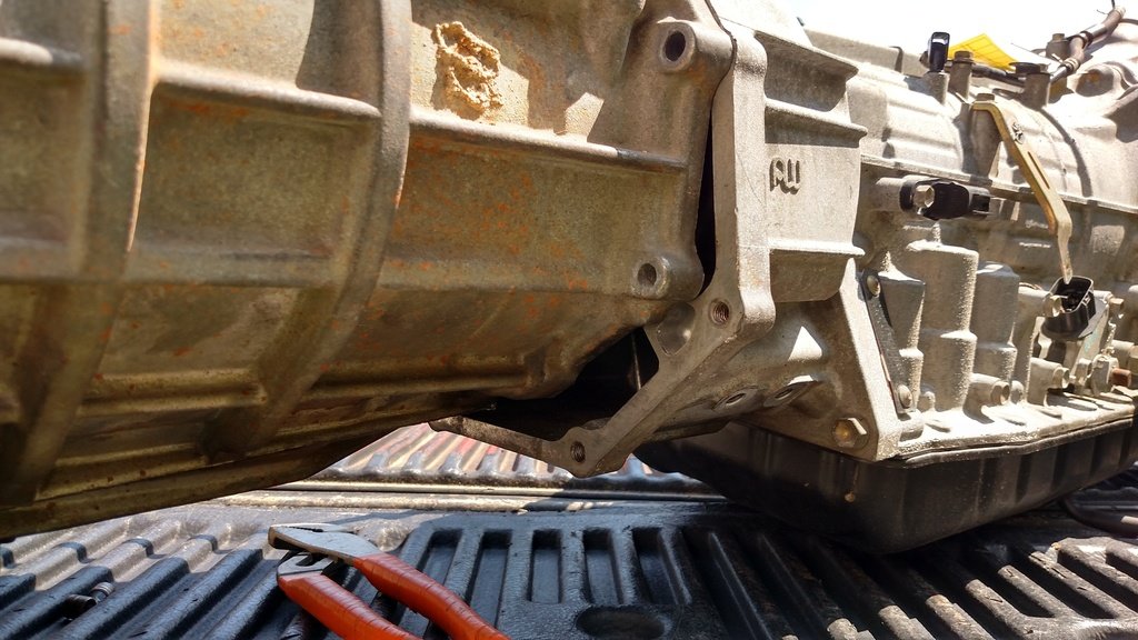

    Currently I am still running the 5 speed and its Tcase.
    In one of my previous posts you can see that 3 of the bolts don't line up. One will likely work with maybe 5 minutes worth of file work. The other two will need more attention. I had planned to weld a plate into the tail housing of the a750, and using one of the bolt holes. The other is needs to be threaded into the transfer case. This will not be possible since the tail housing will be in the way. I had planned to see how it looked and felt with out the use of one bolt. If I felt the need for the bolt, then I was going to fab up some sort of brace that used the rubber mount thingy's holes on the rear of the tcase.
    Also, the input coupler on the older tcase is a bit thinner walled than the newer a750 tcase. You have two options. 1, find a a750 tcase coupler and swap it onto the multi mode case. Or replace the bearing in the a750 tail housing with one from an a340. You will also need the a340 oil seal too.

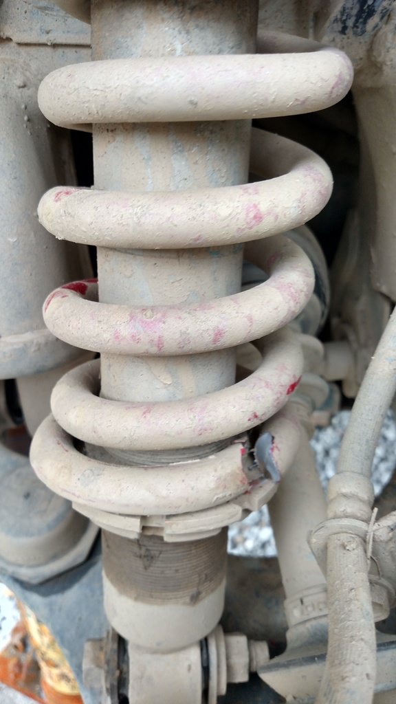

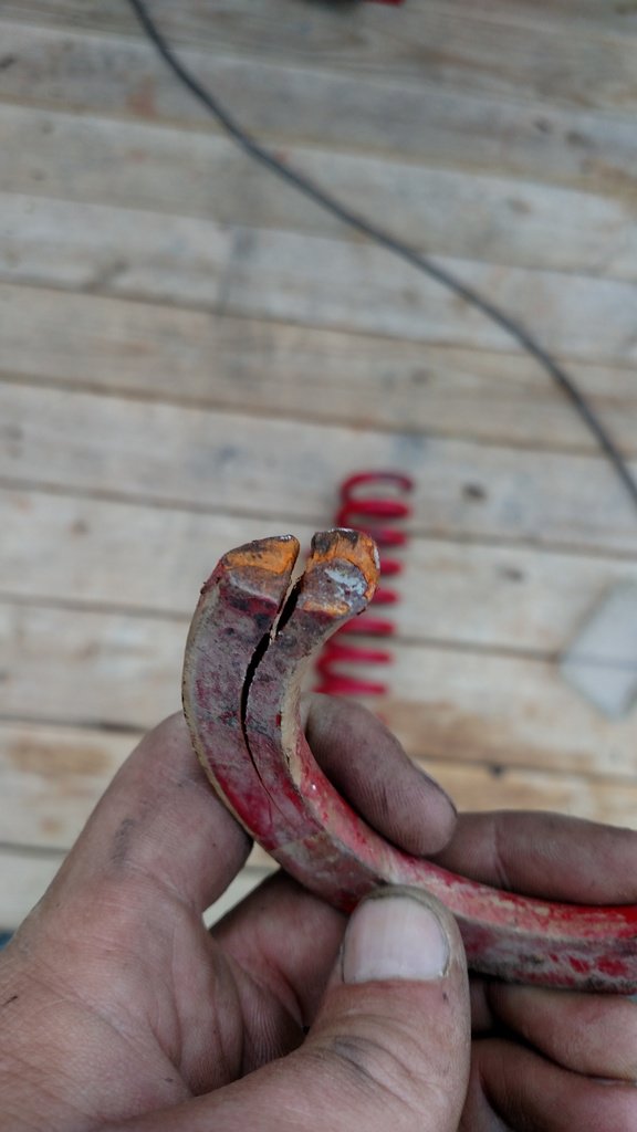

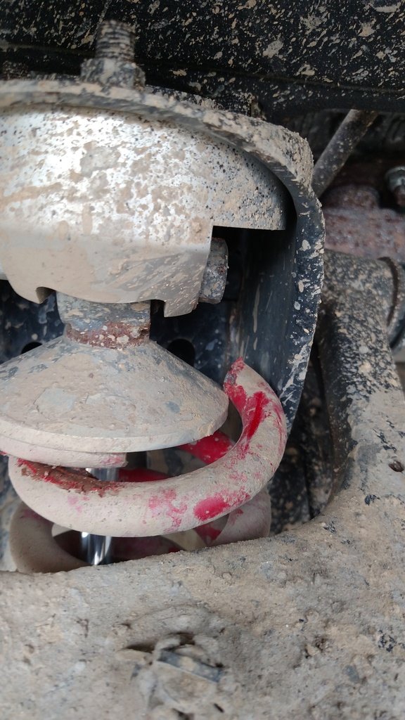

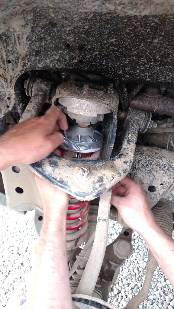

    Made a trip to Harlan KY and did I bit of wheeling. I managed to mangle my transmission cross member, and break the top and bottom wraps off my left coilover spring.
    I've had the left side cranked up pretty good trying to make up for the famous "Taco lean" and the extra weight of the v8. I'm guessing that, not having a swaybar, and really bouncing around finally took its toll.
    Anywho, the spring was completely captured into the coilover assembly, and I didn't have a spare... So, we got the spring to sit back up straight, and drove it the 6 1/2 hrs home.
    Kinda hard to believe, but you could not tell the coil was broken. The ducktape was pretty much just for fun. "If you can duck it, Fack it."

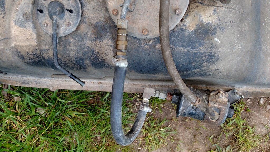

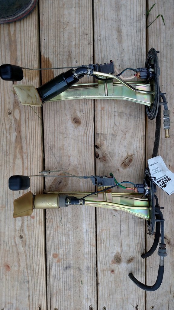

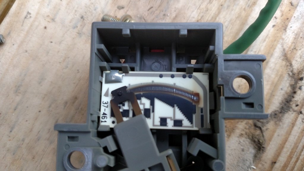

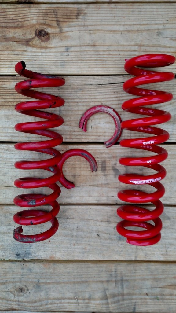

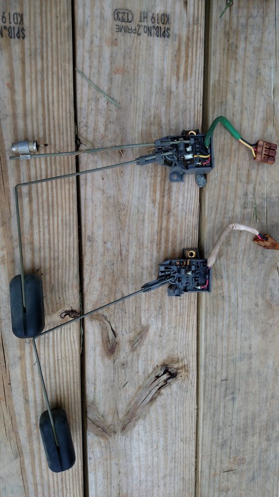

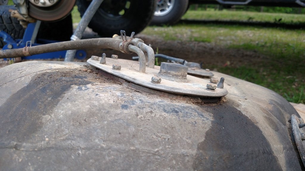

    Well, I have been making headway on my truck. I'm currently working on a few different things all at once. To name a few, replacing my DPDT relay that runs my elocker with the OEM ECU, finally wiring up my power mirrors, replacing my broken coil spring with newer, heavier weight springs. I'm probably going to reboot my CVs, and change my LCA bushings wile it's all apart too. Along with that I dentes my gas tank and my fuel gauge was reading full all the time, so I'll swap out the level sensor.
    So, here are some pictures.
    Broken 600# coil, next to 650# coil

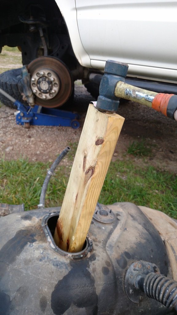

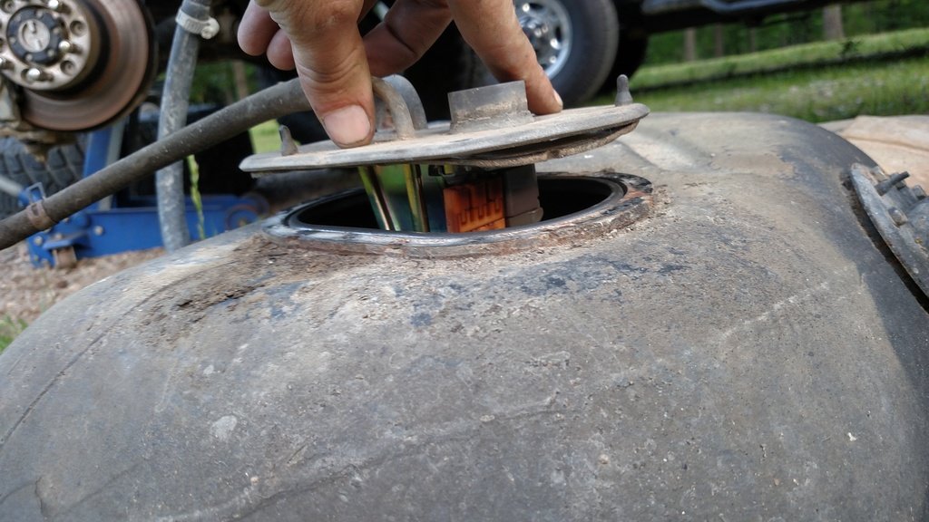

    I picked up a used sending unit off eBay for 50$. It came out of a 99 Tacoma also. You can see that my sending unit is bent from the tank being mashed in. I decided to bend my sender back into place because I didn't want to modify the new one for the V8 pump, and relocated fuel filter... You can also see that the new unit has the low fuel light sensor. I swapped that onto my old sender.
    Here you can see how.shallow my tank had become.
    High dollar tank deepener tool 3000...
    Tank back to normal.
    And my fuel filter relocation. Sine I had a 4cyl before, the filter was on the block. I was going to mount it under the cab like the v6 Tacomas, but there is a Cat in the way now.. This was the easiest way I could find. This has worked well for a few years now..

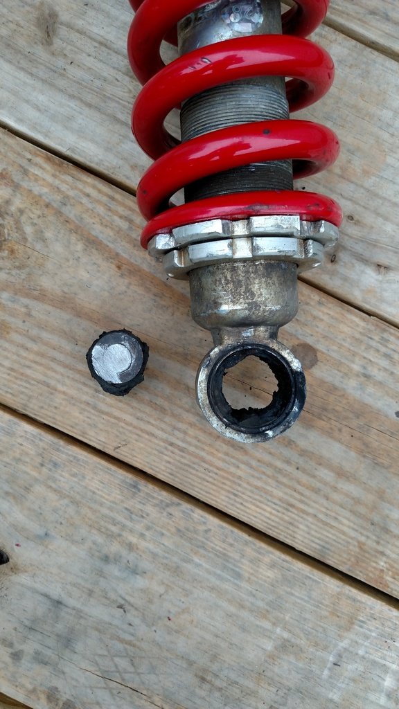

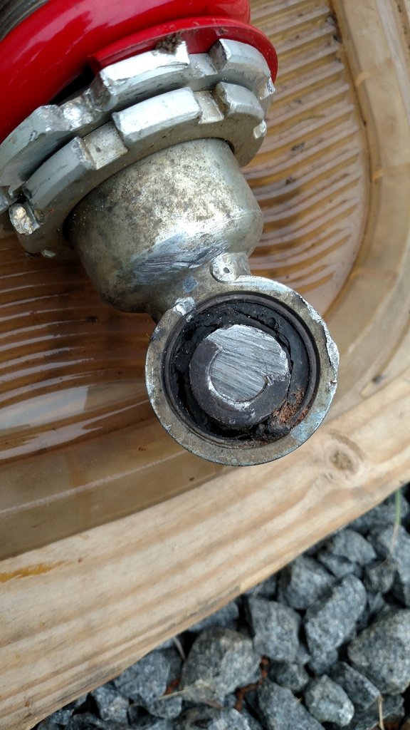

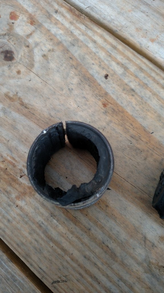

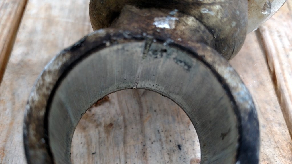

    I removed the bushings with the bolt stuck in it. The rubber was already torn completely, so all I had to do was push the inner sleeve out. I used a vice, a bolt, and a socket.
    Next, I used a sawsal to cut the out sleeve. I cut the sleeve by the thickest part, right under the shock body. Once the cut was made, the out sleeve fell right out.
    You can see that I did cut the edges of the eye a little, but I doubt it will ever be an issue.
    Hopefully Brown Santa will bring the new bushings tomorrow or the next day and I can use my vice to press the new bushings in.
    Also, I got both new coils installed. I'll turn the adjusters to halfway as my starting point.
