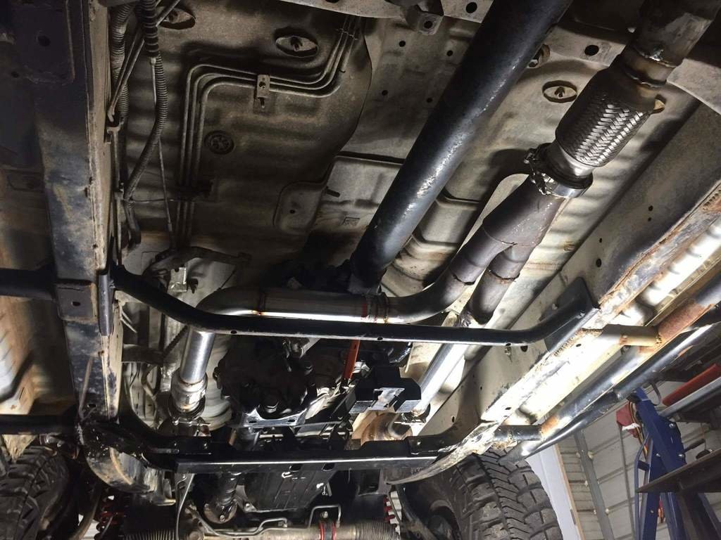

    Here you go.

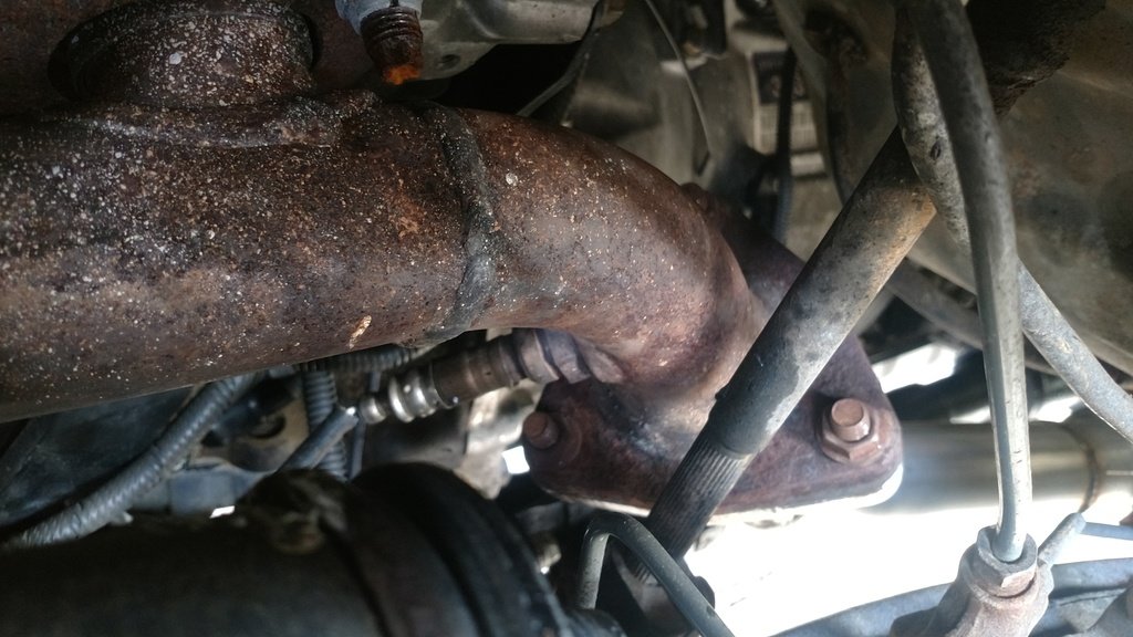

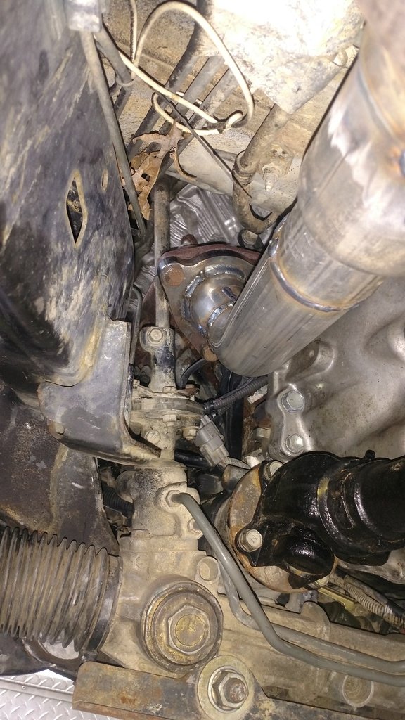

    Got a shot of the driver sider header coming down? Like by the steering shaft and all that.
    Looks great though.
  4. Mar 21, 2017 at 4:58 PM
    #324
    COMAtized99
    COMAtized99 [OP] Well-Known Member
    Nov 10, 2009
    #25746
    1,894
    North Carolina
    99 DCLB v8
    The Bed is stock...ish
    How's this?

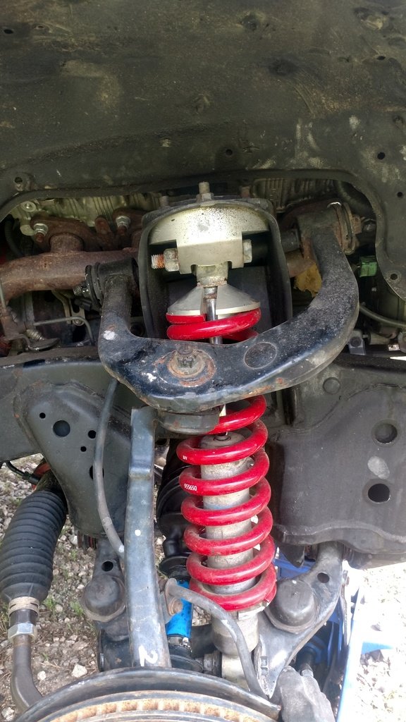

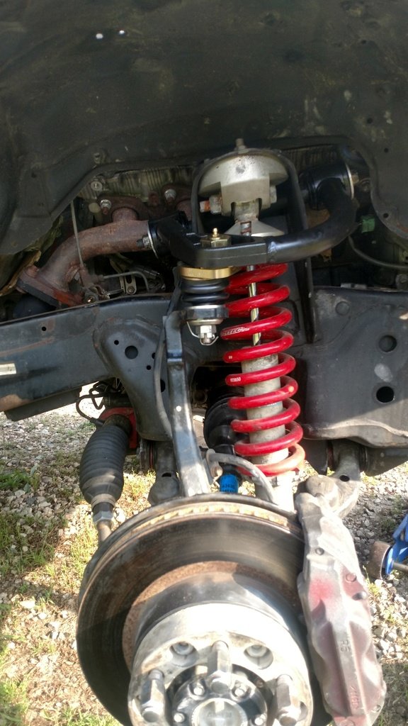

    Today I received and installed my new SPC Light Racing UCA. I only took 2 pictures, but if you follow this thread, they install super easy. Before
    After
    Deathbysnusnu likes this.

    Looks good! My next project is a suspension refresh. Did you use anything special to compensate for the V8 weight?
    Also, did you have to do anything about the engine vin# not matching the truck?
  13. May 21, 2017 at 5:02 PM
    #333
    COMAtized99
    Nov 10, 2009
    #25746
    1,894
    North Carolina
    99 DCLB v8
    I had toytec coil overs with 600 lb ratings. Last wheeling trip I broke the top and bottom rings off the spring. I now have 650 lb springs.

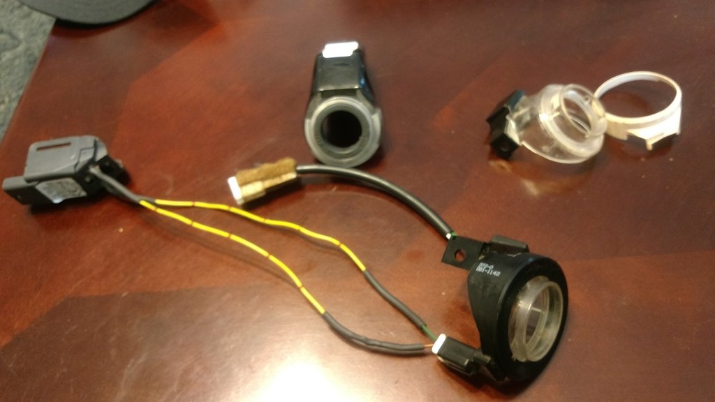

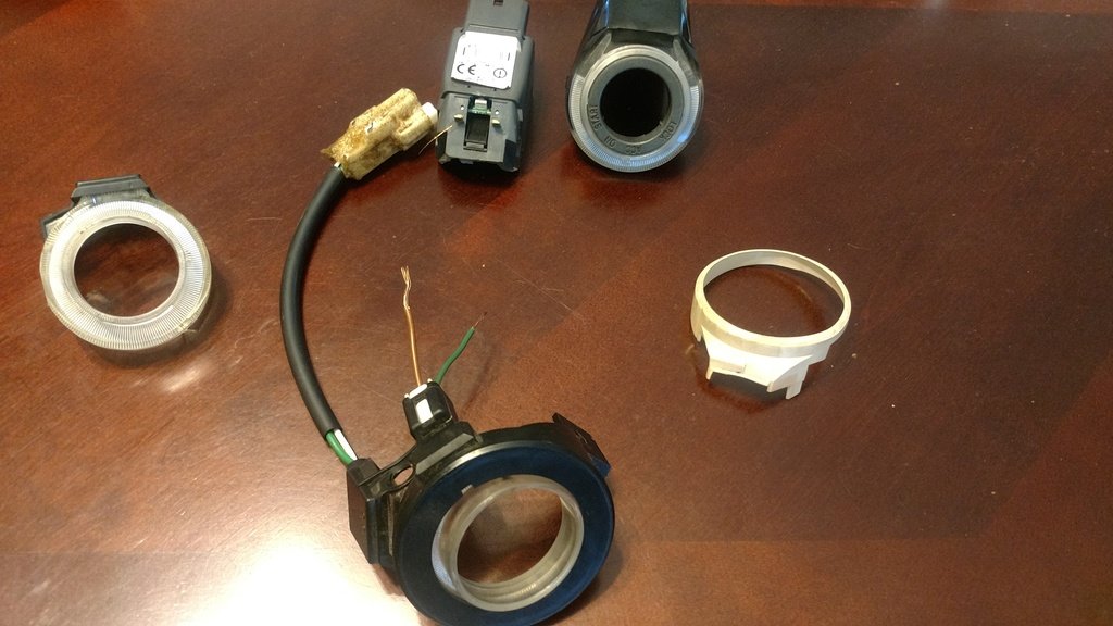

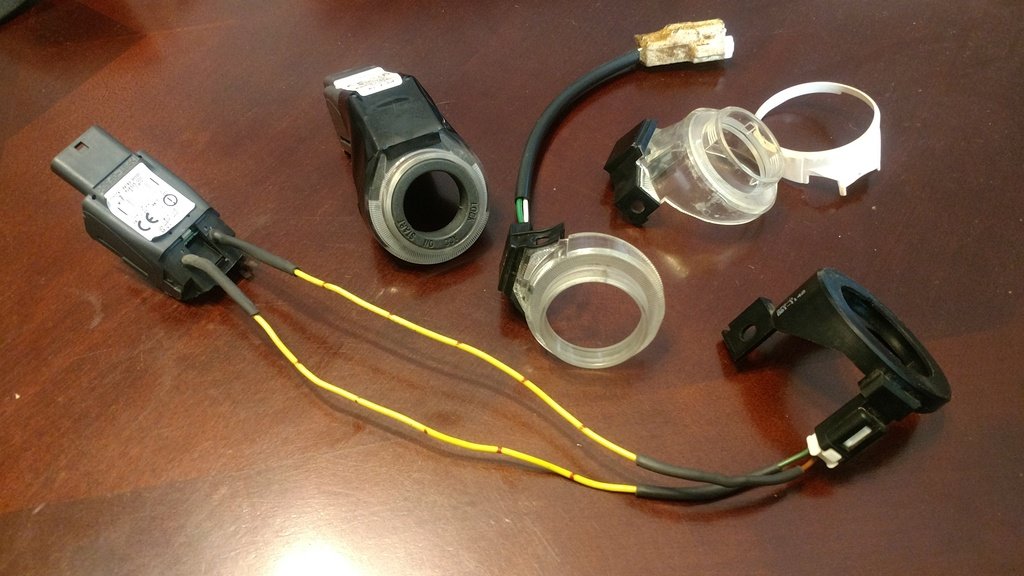

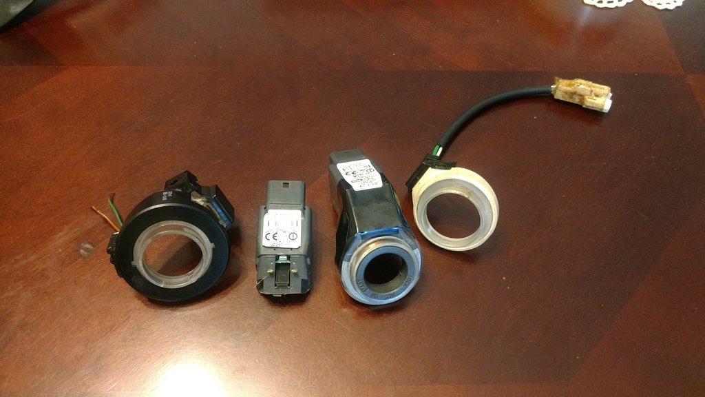

    Side note. I ended up going down to LKQ with a friend. I walked out with an I-force v8 badge and a key amp from a 98 Lexus LS400.
    The key amp is special because with about 30 minutes work of work, I will have a fully functional engine Immobiliser.
    So, it's kind of complex if you don't know what an Immobiliser is. Basically, it's a computer that reads a small chip the size of a grain of rice that is implanted into Toyota "Dot keys". Apparently each little chip is different like a finger print. This chip and up to 4 or 5 others (I think) can be programmed to the Immobiliser ECU.
    When. A key that is cut for your ignition, and programmed to your Immobiliser ecu is inserted into the ignition switch and turned, the engine will run normal. However, if you only have a key that is cut for your ignition, but has not, or can not be programmed to your Immobiliser, the engine will spin, but not start.
    What most folks do is find an Immobiliser and key that have already been programmed together. They them zip tie the key to the key amp (which is basically a coil of small wire mounted by the key ring light that detects the key and transmits the chip information to the Immobiliser) under the dash someplace. Which works. However, I wanted to go one step farther and find a key amp that would fit my ignition switch. I tried the v8 4runner key amp, but the ignition switch is shaped different and the key amp won't fit into place.
    I found out that some fancy smancy 3rd gen 4runners have an Immobiliser system, but the key amp also does fit my ignition.
    After talking with a Friend, he came up with this idea. He provided the information, and I tracked down the parts.
    Photobucket is being stubborn, so I can't upload pictures. Once I get it working, I'll update with photos.
    These are the past I started with.
    Left to right: Lexus key amp ring. Modified 4th gen Key amp, stock 4th gen key amp, stock taco/4runner key ring light.
    Combined the Lexus key amp ring and Tacoma light ring.
    Connecting the modded key amp chip and Lexus key amp ring.
    And, finished product
