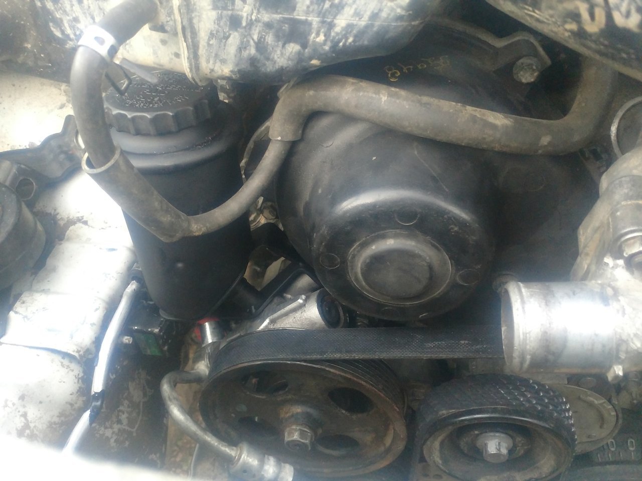

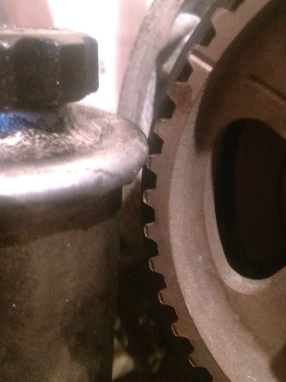

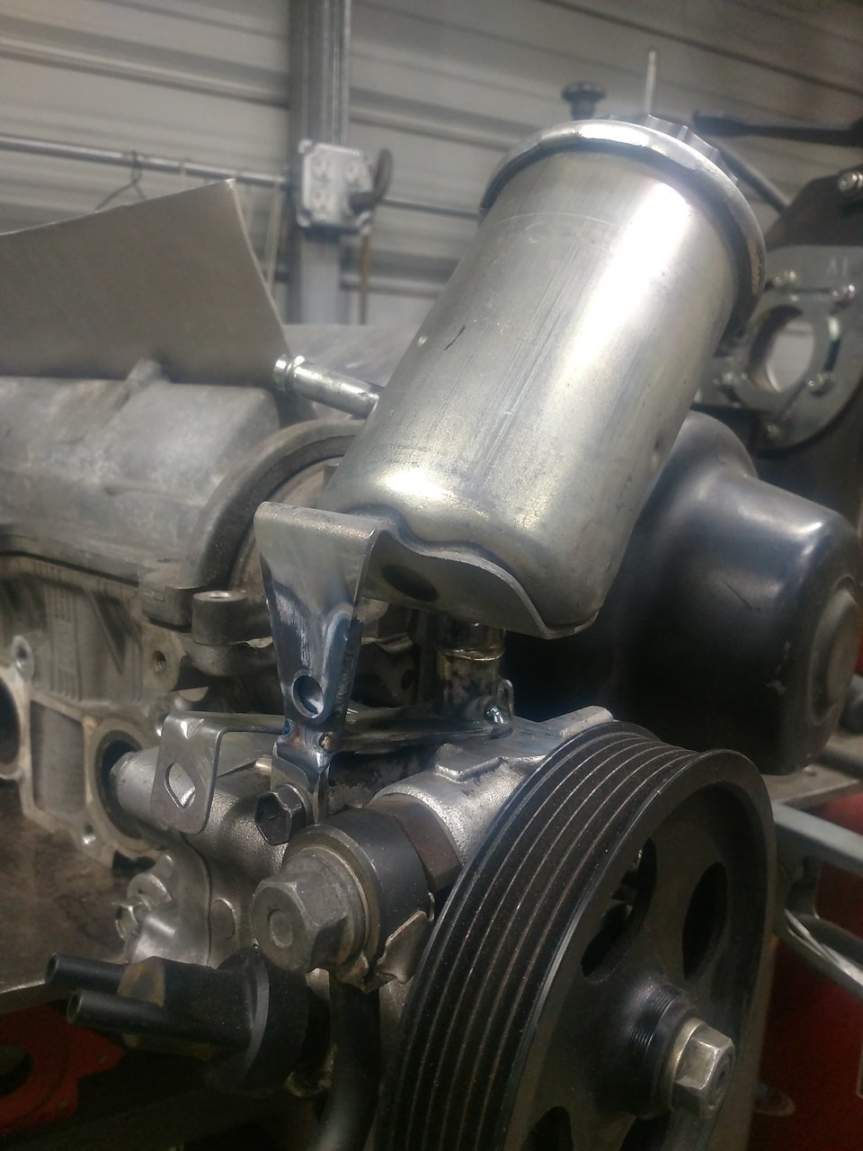

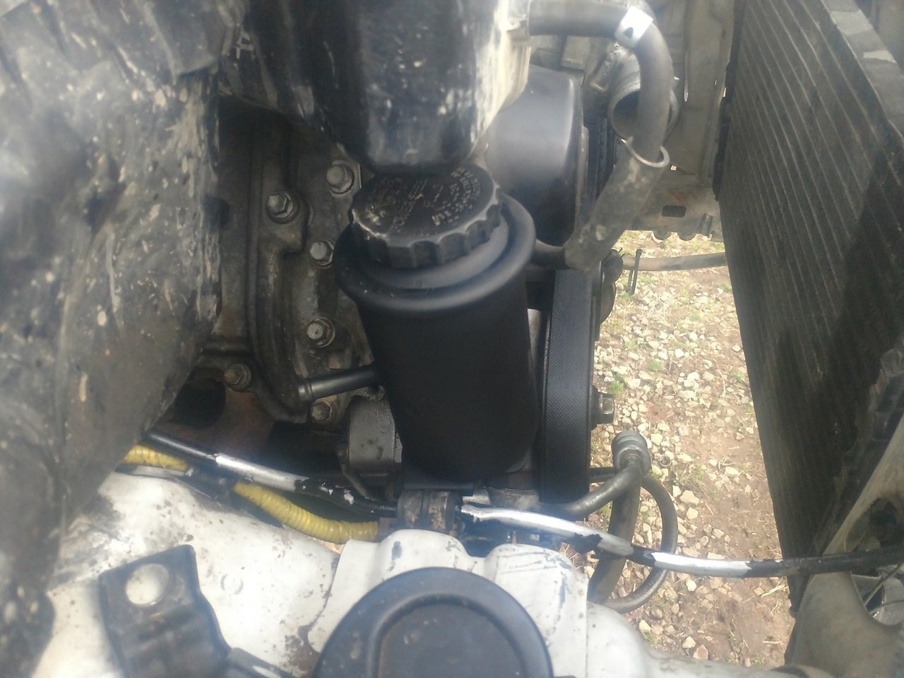

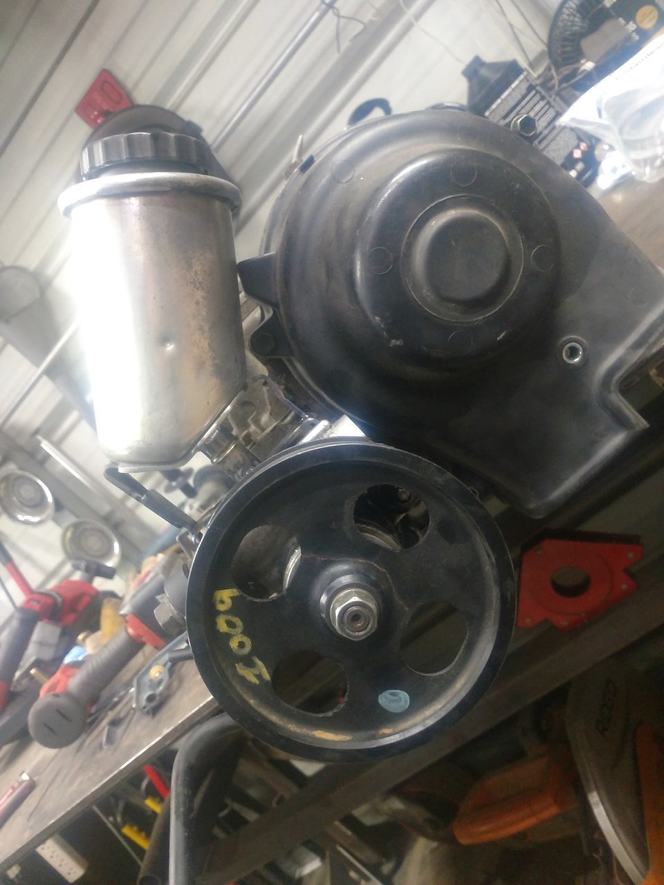

    This has been a long time coming. The resivour is from a 95era LS400. The pump is a 98-00 1uz pump.

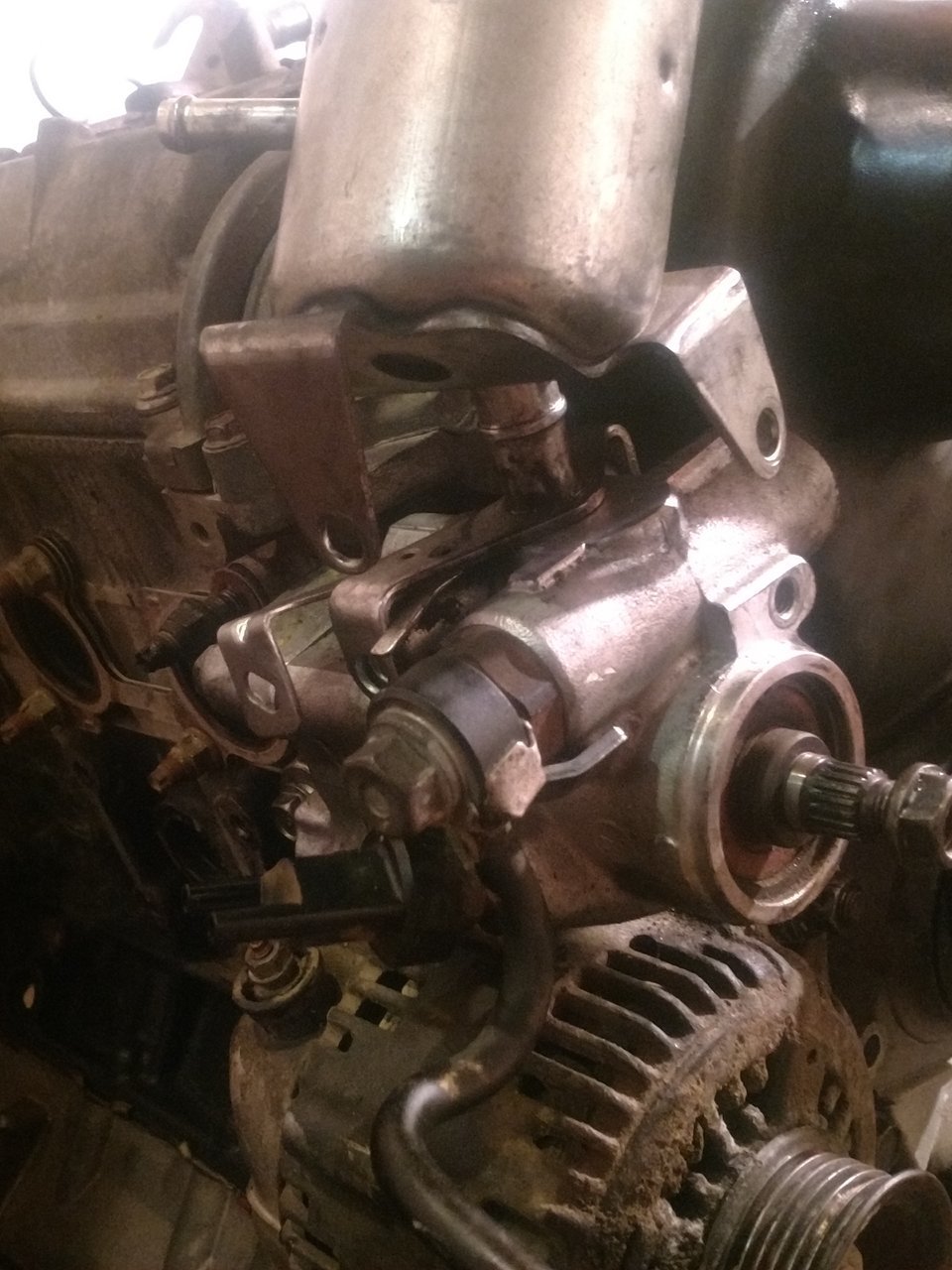

    From my parts gathering, it seems that all the 1/3uz pump bodies are the sane, with two different backing plates/mounts. The vvti 1uz and 3uz have the correct/same mounting points as the 2uz. The vvti 1uz and 3uz also have the correct pulley to line up with the other accessory pulleys. The non vvti pump has the resivour I used. Note, that the 3uz has a form of ecu controlled power steering assist. I can't think of the name while I'm typing this, but what is important is, that sensor can be unbolted and thus just like the other 1uz pumps.
    The 2uz uses the same pump as the 2/3rz and 5vz. This pump uses a separate mount to bolt to the block. This mount has a stud in it. I removed this stud and installed it in the head. This was the only modification I made to the head. The stud threaded right into a hole already mentioned for the power steering bracket.
    The 1uz pump w/ factory resivour would not clear the timing cover, or the timing gear for that matter.

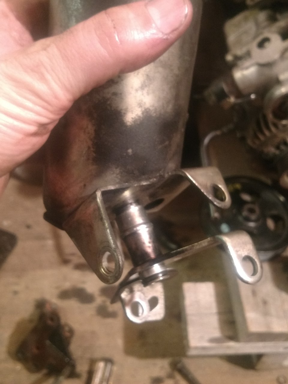

    I began to think, and after a few hours of looking, it occurred to me that the vvti 1uz and 3uz has a hose fittings that bolts to the top of the pump. After eyeballing this, I cut about a 1/2" from the end of the metal pipe. Right about where the clamp would go. I then stretched the opening of the pipe to the point the bottom of the resivour fit snuggly in the top of the pipe.
    Once together, I test fitted on my back up 2uz, then off to my fab guy for tome fancy forever glue.
    And here is the finished product. Checking the fluid might be a bit tough, but hopefully it's not an all the time thing.

    was there an advantage to going to a 1uz pump?
  15. Feb 22, 2018 at 5:09 PM
    #375
    COMAtized99
    COMAtized99 [OP] Well-Known Member
    Nov 10, 2009
    #25746
    1,894
    North Carolina
    99 DCLB v8
    The Bed is stock...ish
    Pump mounted resivour. Cleaned up my inner fender and removed the lines to and from the pump to resivour.

    The pumps are bigger, but so is the pulley. So, idk if there is any volume/performance gains. I just hated the remote resivour.

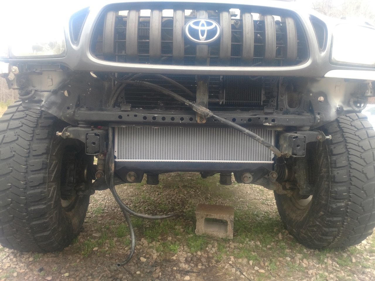

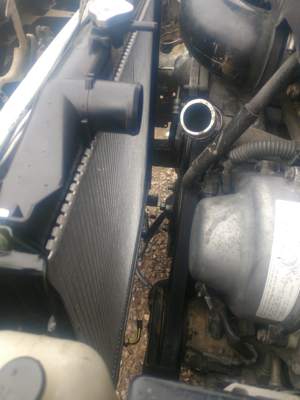

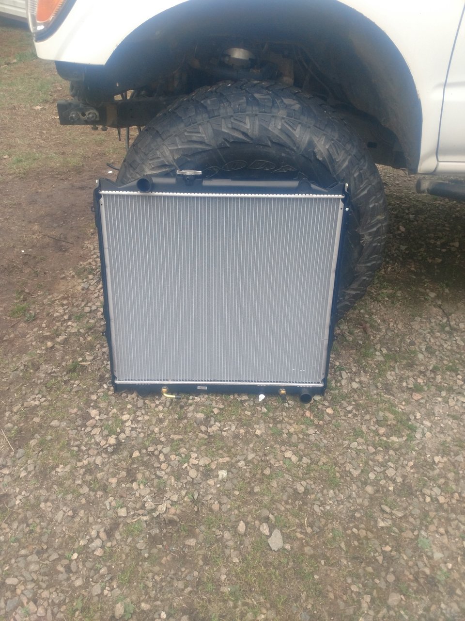

    One stop closer to being 100%. Finally got a radiator that fits my truck and is not too bulky. Its from a 96-02 Hilux Surf with I believe the 4cyl 1kz diesel engine. Whats special about this radiator is, Its basically the same radiator that comes in the Tacoma/4Runners, but the inlet and outlet are on the opposite sides. I hope to be able to mount 2-12" spal low profile fans. and have a shroud made.

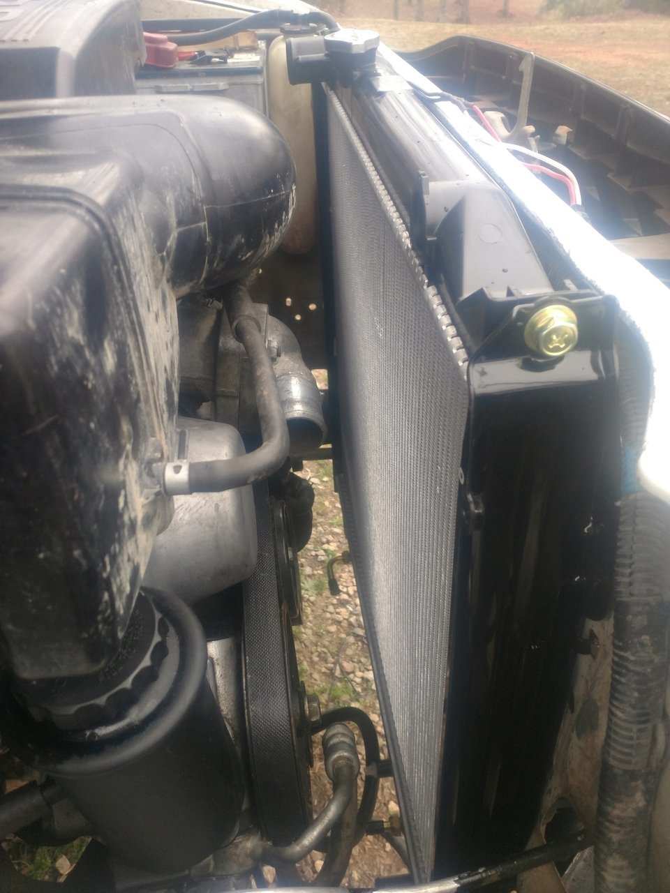

    Getting ever so close to being back up. New radiator in, fans mounted, however one of my spal fans is having issues. SO, back out the radiator has to come. Might change fans yet again for more CFM now that I have a 2 core radiator and have an extra 1" or so. This should just about double the CFM through the core.
    Also, I'm doubling up on my external transmission cooler, and I will NOT be using the cooler in the radiator. Hopefully this will lighten the load on the cooling system when wheeling, Which has been an issue I've been struggling with since my motor swap. Ill also be using a Thermo bypass on the transmission cooler to hopefully prevent the transmission from running too cool in the winter.
