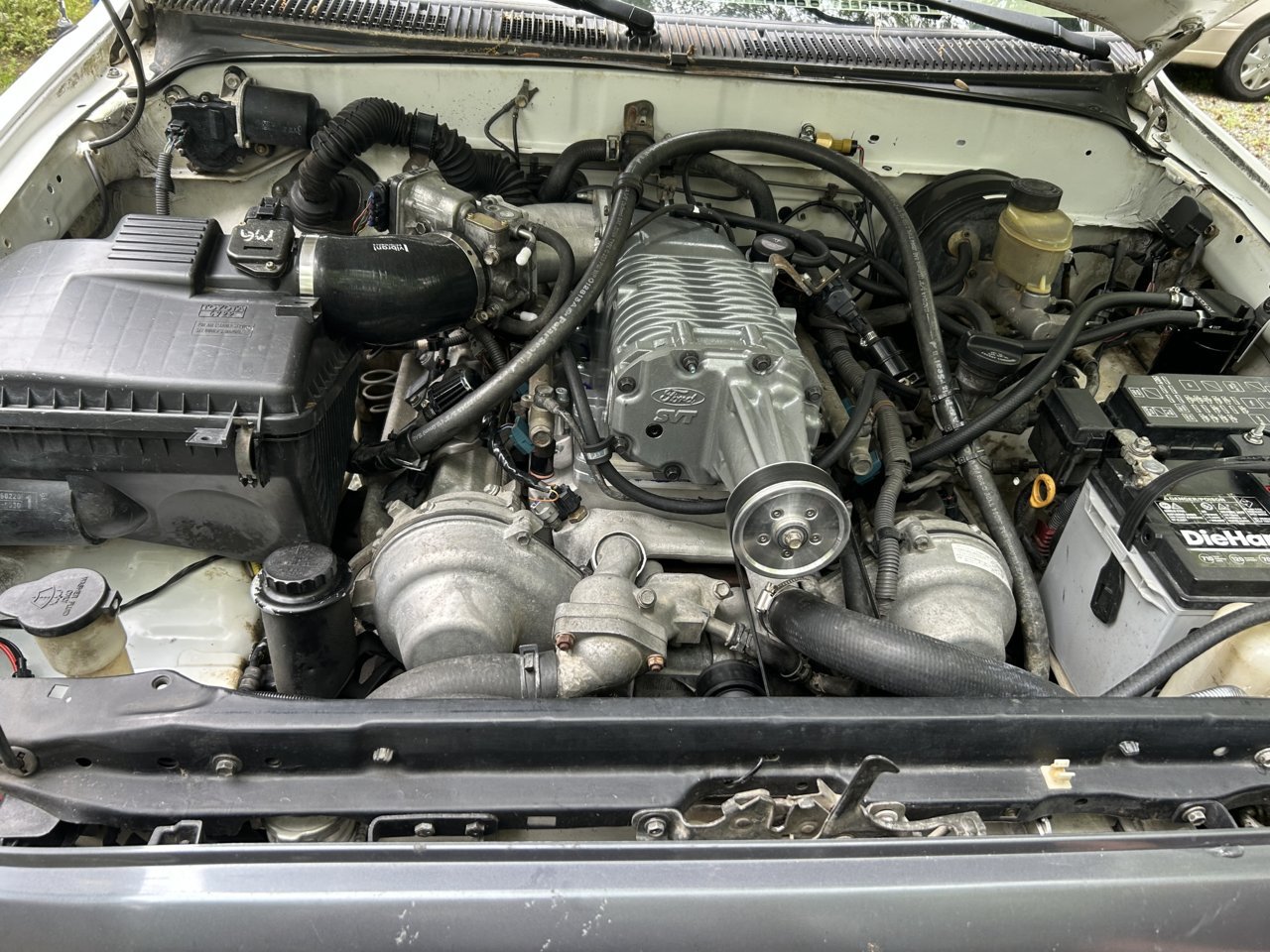

    Not many. The few that exist are Snapchat videos that my friends take.
    In January 2023, I stumbled across Speed Academy on YouTube. They have a Lexus LS430 (Flexis) with an Elate supercharger manifold. This allows for the use of the Eaton M112 supercharger from the 03/04 Terminator Mustangs. I have been working most this year on tuning. I currently need to install a stronger fuel pump, and figure out if the P0103 code I’m getting is a result of maxing out the MAFs air flow or something else.

    Non-intercooled?

    correct. There is an intercooler option, but I don’t have it currently. I’m only making 4-5 psi at WOT and averaging 2-3 normal driving.
