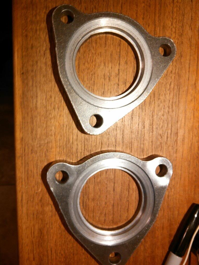

    A small update. Finally my exhaust flanged are headed my way. (today or tomorrow I hope) ResizedImage951386548662072_62d38a938439c4e93cb99c018b1e820cfe544020.jpgAlso, my truck only has 3 tires at the moment.. Its a long story, but the short version is this, the inner bead on one tire got ripped. I am waiting now a new tire... sigh.. there is always something right? I hope to have the most of the exhaust done this week/weekend solong as the weather gets its act together...

    looking forward to this part. Most build i have seen have to get very creative with the driver side exhaust :popcorn:

    I have not mocked any tube work up yet, but I dont see where its going to be too tough. It will be tight, but there is enough room to work. The handbrake cable lever deal might be in the way, but I dont know yet.
