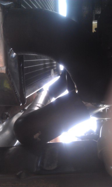

    I have not driven the truck yet, but the hood closes. I "massaged" the hood support to clear the plug for the MAF sensor on the air box. I have shut the hood and run my hand all over trying to find tight spots. I have layed under the truck and reached as far as I can up into the engine bay, but that was the only tight place. Its now got 1/4" or so. I could go more if needed, But I didnt want to dent my hood. I dont think it will be a problem since the air box is mounted to the body.

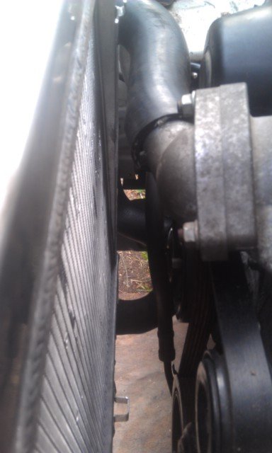

    The radiator is an 81-83 280ZX 3 row "champion" alum. radiator. (Found on Ebay) I have a single "low profile" 16" spal fan. There is about 3"s between the fins on the radiator and the pulleys on the engine. The spal fan measures 2.5"s thick.

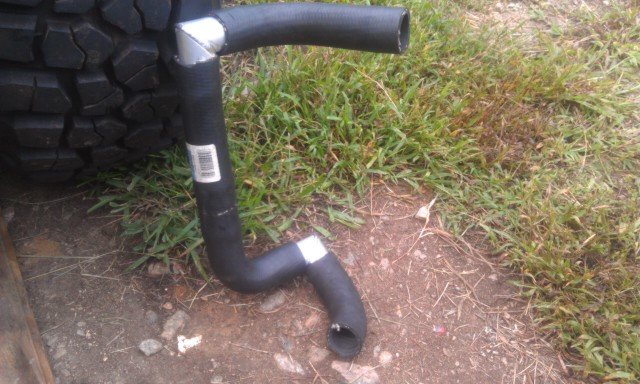

    The front of the engine is TIGHT, but there is room. The only thing I dont like is my lower radiator hose. I had to use a few alum. bends to sneak it around the pulleys and clear everything. It just does tough the fan housing, only just though. I think it will be ok.
    The heater hoses are cut down stock Tundra Hoses. The stock Tacoma heater control valve was resued in the stock spot.

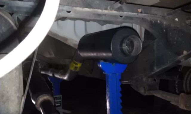

    Been busy since Sunday. I keep knocking stuff off the list. I have 75% of the exhaust mocked up. This is my small muffler. Its hard to tell the sound right now because I have SOOOO many exhaust leaks, but once I get everything welded up the sound should be nice. I like what I think I hear...

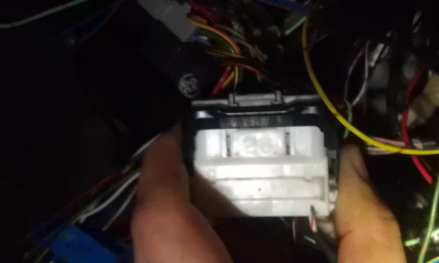

    I fixed my MAF sensor. I had a wire in the wrong slot. Below you can see the plug. On the top left you should see a red wire with two silver dots. That wire feeds power to the MAF, o2s and VSV. That wire should be connected to the white wire with the red tracer on the bottom right of the plug. Once I moved the W/R wire over to the red one everything was golden. And let me tell you what... Having that extra 2500rpm is AMAZING!! Its been raining here all day, so the roads are a bit.... moist. :burnrubber:
