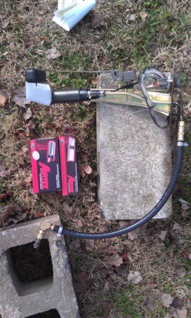

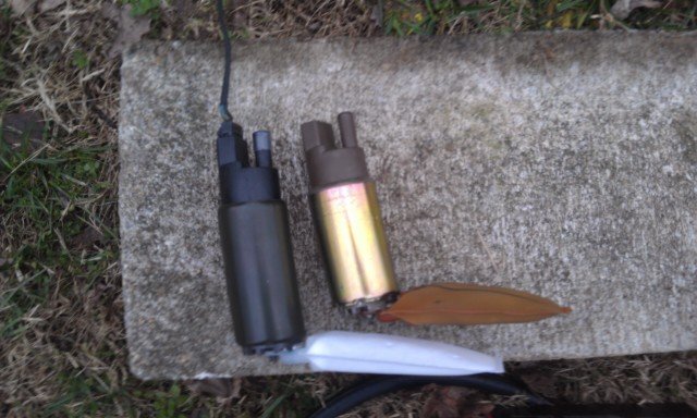

    ughhh... My fuel pump died yesterday. I knew something was wrong when I pulled out of my driveway and the engine fell on its face. I pulled back in the driveway after a 15 minute ride trying to figure out what might be the deal. I shut it off and went on to my families with out it. When I got home, I tried to start the engine again. Nothing, just spinning. With this engine/ecu, when there is a failed crank the pump will run for 2 seconds after the key is released. That time I didn't hear the pump running. I pulled out my jumper wire and applied power to the fuel pump lead. zilch..
    Off to Auto Zone I go! I went ahead and bought the v8 fuel pump. As you can tell it is a bit taller. The plug going to the pump was the same though. I am getting pretty good at dropping the tank down...

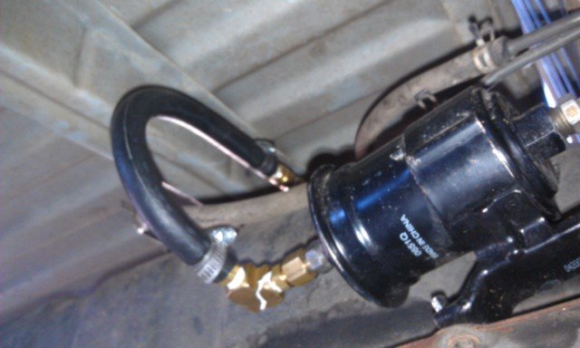

    Wile I had it apart, I went on a bought some fittings. This should seal up my leak for good!
    I was a bit weary of the auto zone pump, but it was $253 and has a LIFETIME warranty. I am running a auto zone pump in my 4runner. it has been in there since 2009..sooo...

    Nice swap! $250 for a pump, WOW. Must be denso / OEM replacement. You can get a 190lph walboro for about $100 from URD. Guess you needed it ASAP.

    Yea, Wanted to be able to take my truck out of town over the weekend. That morning I got up and bought the only pump I could find. I thought about The URD pump after I bought it.... Oh well.. Its only money right... I will make more tomorrow... :rolleyes:I have been driving the truck now for a few weeks. The engine has performed great. Mileage is a bit lower than I had hoped, but its not that bad (35s and 4.56 gears). Its right around what my 4cyl was getting, only 3x the power!!!!

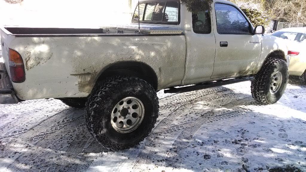

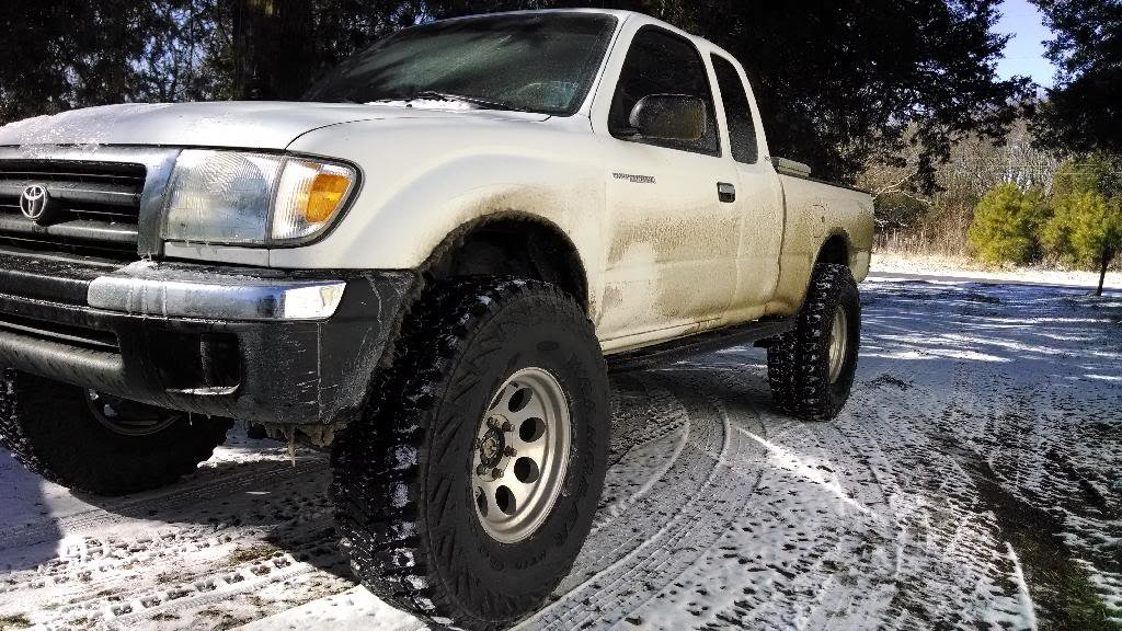

    We got a little snow.

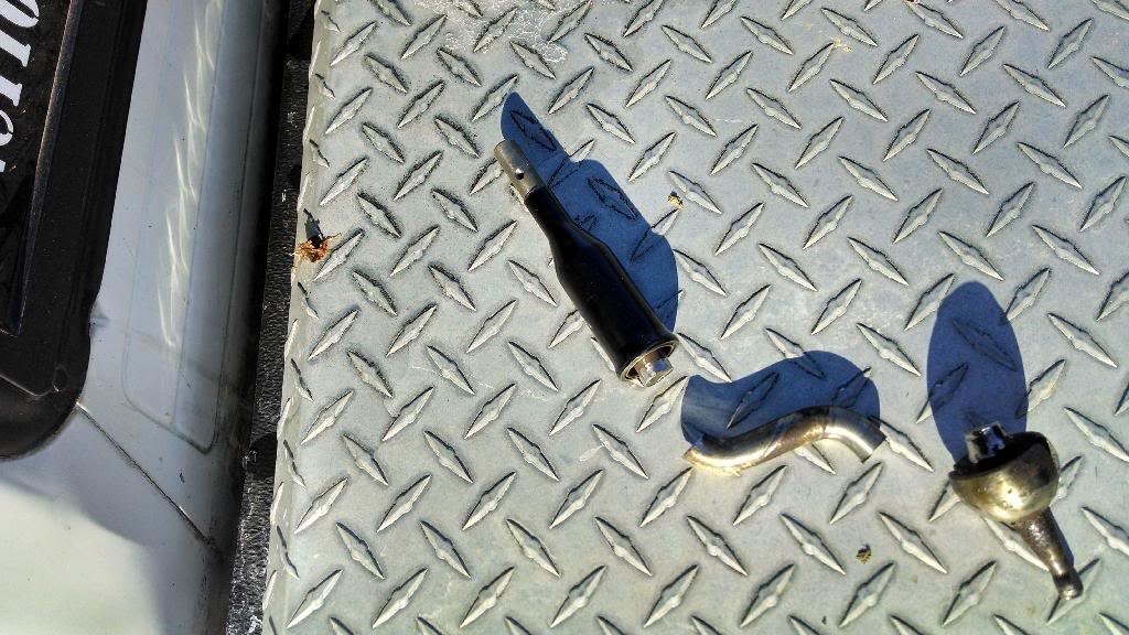

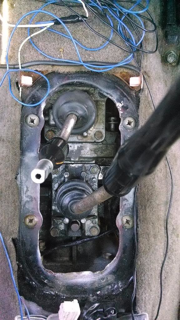

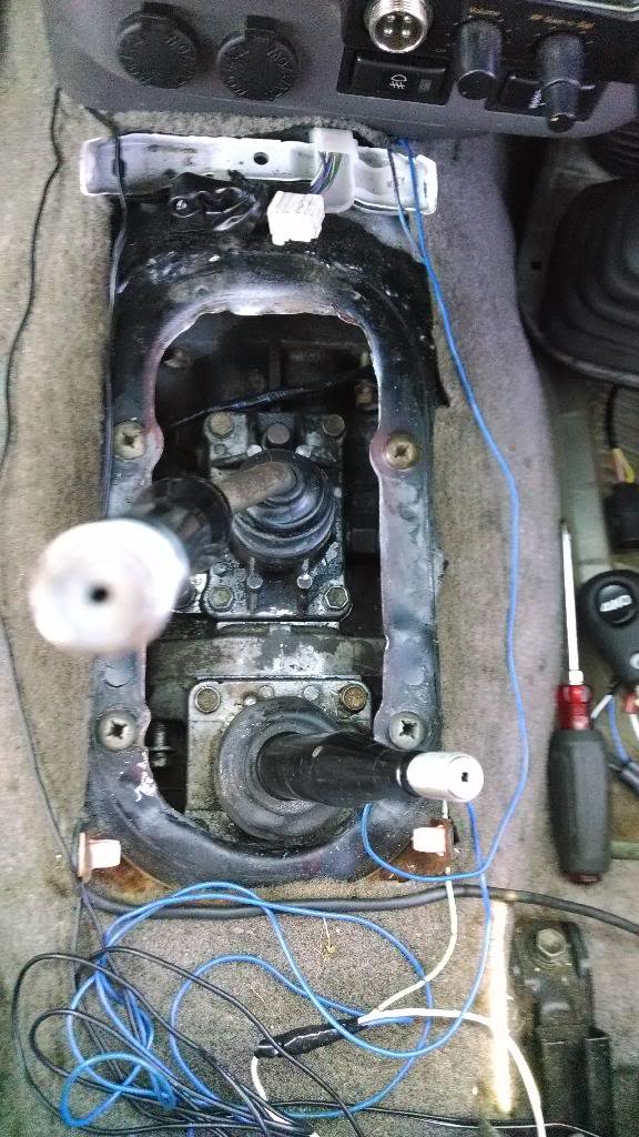

    I worked on the T-case shifter the other day. The problem is with the engine and drive trains current position, the shifters where sitting about 2 or 3"s back from stock. Not a huge deal. Some slight work to the back edge of the shifter hole and it all went together. That was until the shifter console went on. In 2wd, there no problem. The issue came when it was time to get into 4wd. The shifter would go half way, then make contact with the plastic shifter console. This is what I did:
    This is how it started
    I had a shifter from a push button 4wd L-N-H style transfer case. I cut it up so I could weld it per my needs:
    This is how it ended up.
    Please pardon the extra wires. Some are left over from a wiring job that is no longer in use, and the others are grounds running to manual switches for the High, and Lo radiator fan relays. They will be gone by this summer I hope.
    The new shifter is almost perfect. I got everything welded up, and had all my stuff put away when I put the rubber boot over the shifters, then the shifter console. I made one last test run with the shifter through the ranges. Everything was perfect till I got to Lo. It goes into lo just fine, Put the reach on the shift lever is so far forward now that in Lo range, the shifter collapses the rubber boot. When you take your hand off the shifter the rubber boot shoves the shifter back into Neutral. Sigh... Oh well a project for another day. It want be hard to fix.
    Anyway, Keep commenting, and asking questions!!! :D
    A few notes, Yes I see the loose bolt, and the reason the shifter hole is black.. well. My truck was an auto, and when I went to the manual a few years back, I jacked the hole up with a sawsal. So I just cut the whole top of the transmission tunnel out and went to a junk yard and picked up a replacement. Not the best way of doing things, but you cant see it and it works... So don't hate.
