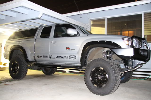

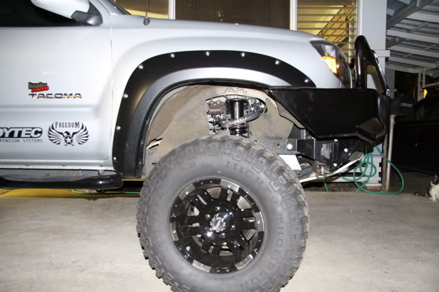

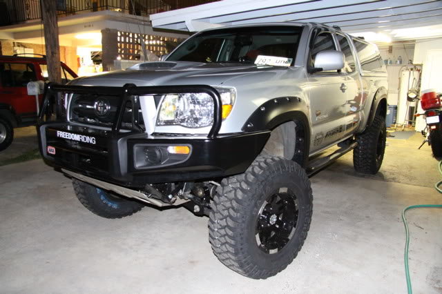

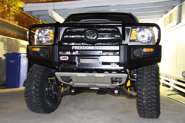

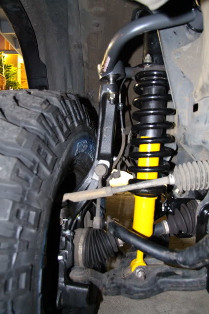

  16. Nov 22, 2009 at 8:16 PM
    #16
    freedomriding
    freedomriding [OP] FREEDOMEDIA
    Nov 2, 2009
    #25319
    697
    Nate
    Oahu, Hawaii
    '20 TRDOR w/KDSS
    Eibach 2.0, STT PROs, Summit Dakars, JBA
    6" plus OME 885 coils/shocks. It's atleast 8 inches in the front. My CV's are sitting close to 40 degrees

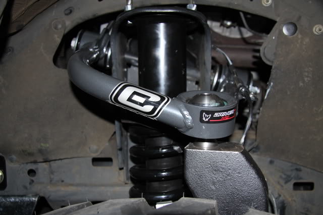

  18. Nov 22, 2009 at 8:54 PM
    #18
    freedomriding
    Nov 2, 2009
    #25319
    697
    Nate
    Oahu, Hawaii
    '20 TRDOR w/KDSS
  19. Nov 22, 2009 at 8:57 PM
    #19
    TexasIslandBoy
    TexasIslandBoy THE RED DRAGON!!
    Jun 10, 2009
    #18262
    3,261
    Andrew
    South Texas. SPI
    07' trd offroad 4X4 (For Sale)
    pro comp 6inch lift 35'' tires moto 950's radfo coilovers magnaflow exhaust 5/16" front skidplate usa spec ipod interface tree pin strip mod dry drop in filter full size BFG KM2 spare
    yea that looks a little steep i would like to see a side by side of a 3inch lift and that to see what the cv would compare too
